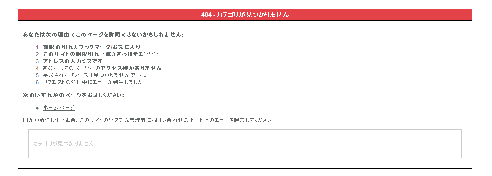

このリンクは訪問できません。このエラ-が出ます:

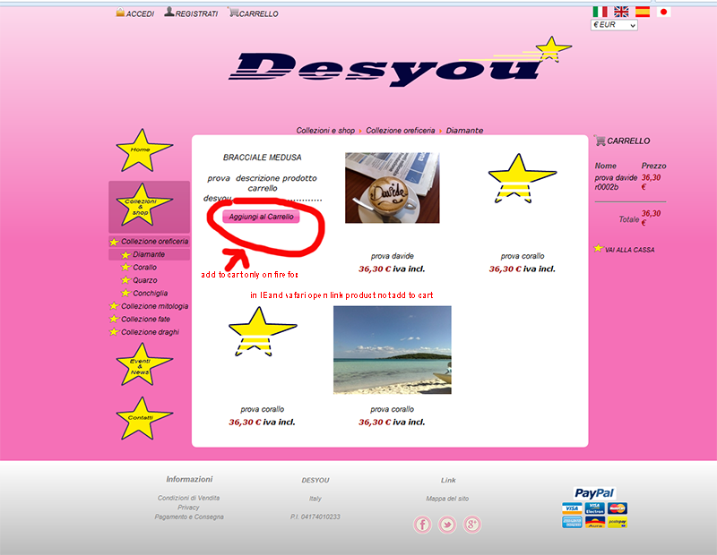

  • Posts: 7
13 years 3 months ago #106362
re-explain the whole
when active in the list view products in vertical slider and step on it with the mouse button to bring up the add to cart button does not add to cart the product, but opens the product page. this behavior does so only on IE and Safari ... on firefox all ok
I am attaching screen
  • Posts: 86106
  • Thank you received: 14206
13 years 3 months ago #106378
That's because you have the "link to product page" option of your products listing module turned on.
Turn it off and you won't be redirected to the product page.
The following user(s) said Thank You: dvdf77
