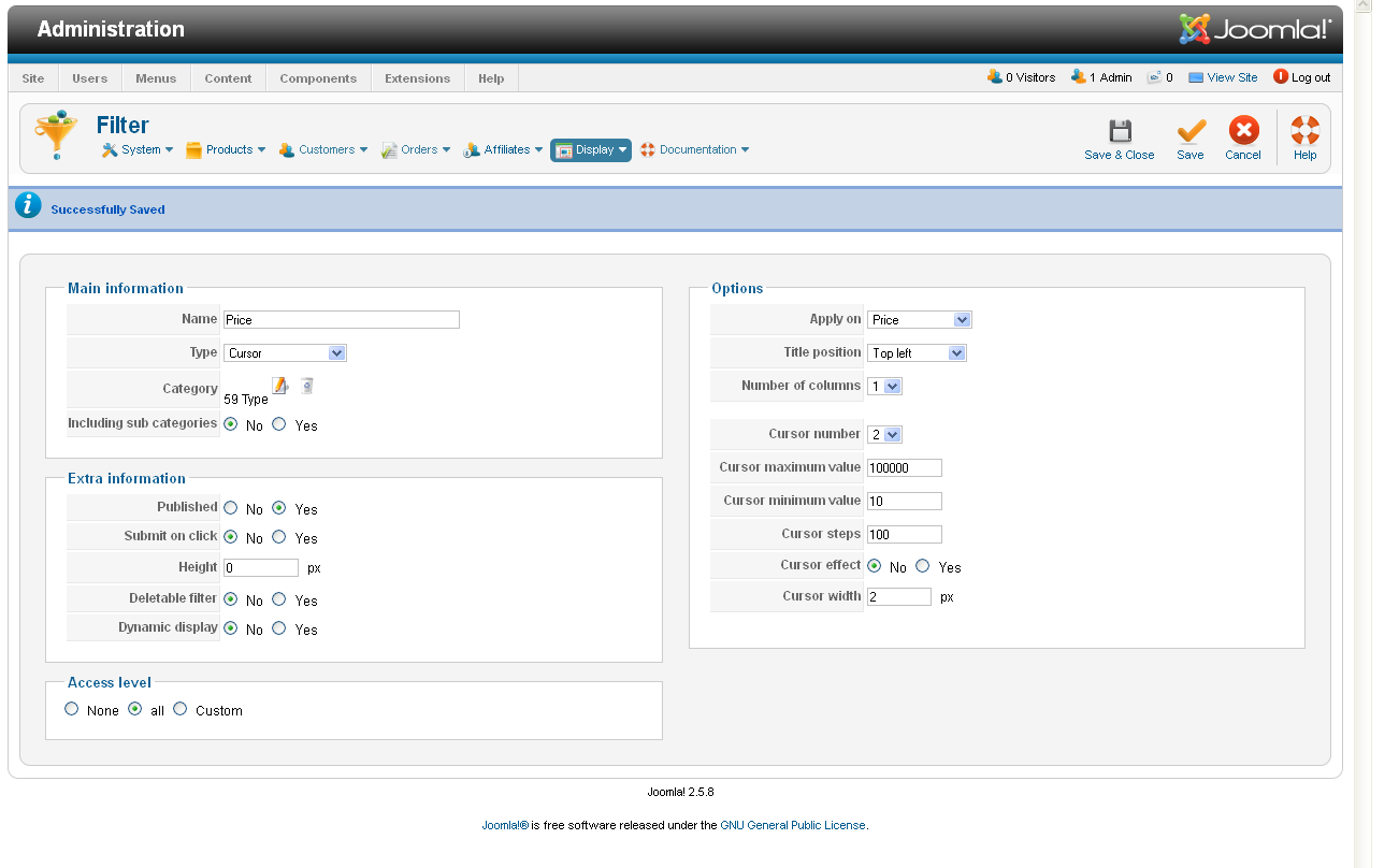

Firstly I've created a cursor filter so people can select the price, but for whatever reason it's not working (as well as creating a massive gap) I also can't put select the filter module as having 2 columns as they appear stacked on top of each other.

About the cursor, first, you set a width of 2px which obviously do not help for displaying it ;)
But the true problem comes from jQuery since you ahve a JS error, it's probably a conflict with mootools, I would suggest to install the Jquery easy plugin to fix that :)

As I said before, you should read the documentation. There is a height option for each filter, just set something higher than 150px (default) and your filters won't stuck anymore.
Same thing for the cursor, I told you to update your Hikashop version since the last version is 2.2.0 while your version is 2.1.2.
We already fixed the cursor issue, just update to fix it.
