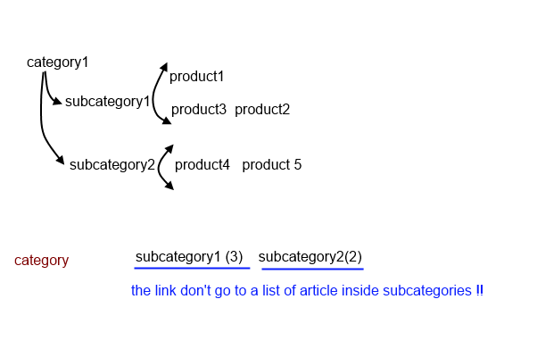

1) link to list of products of a subcategory
I try to configure HS starting from a link that ll show use all subcategories with number of product inside each subcategories .
I succeed to view all the subcategorIES of a category with for each subcategory the number of items inside it .
but i don't succed to configure HS for the link around each subcategories .
at this time i have for each category a link compute by HS that look like this
option=com_hikashop&ctrl=category&task=listing&cid=16&name=subcategory1&Itemid=533
but i want a layout listing of products that show articles from each subcategory
in explicit manual menu item it is ok option=com_hikashop&view=product&layout=listing&Itemid=516
516 => com_hikashop » com_hikashop_product_VIEW_DEFAULT_TITLE ( use category/cid 16 )
Deos HS already support this ? is htere a way to have this behaviour ?

1. You just have to assign an associated module on the menu which is listing the categories.
This module will allow to display the products inside the subcategories.
www.hikashop.com/support/documentation/6...html#categories_menu

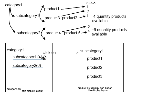

we have hiearchy category1 -> subcategory1 ( with 3 products : product 1(1) product 2(2) product 3(1) )
1) I don't want to see the products on page 1 but only after click : see page 2 on image .
When choose for link menu for HKS category / div ; in parameters for category the "Show the number of products" show if not the number of product but the number of different item name of product when the stock is not set to zero !! so if i have 1 quantity of prpoduct1 4 quantity of product 2 ....
For category 1 -> subcategory1(?) HKS ll show in the front End the value 3 because the 3 product item have quantities not set to zero ! I have not the quantity of products available => 1+2+1 = 4.
Is this the standart behaviour of HKS for count quantity of each products under a subcategory ?
the link to category1 is a COM_HIKASHOP_CATEGORY_VIEW_DEFAULT_TITLE
2) i don't succeed to configure HKS to have the page 2 after click on the link subcategory1.....

1.
Yes, that's normal. The number is the number of different products available, not the sum of the stock of all the products in the category.
2. Than what do you have ? Can you do a screenshot of the options of your module/menu and give a link to the page so that we can see what you have made ?
