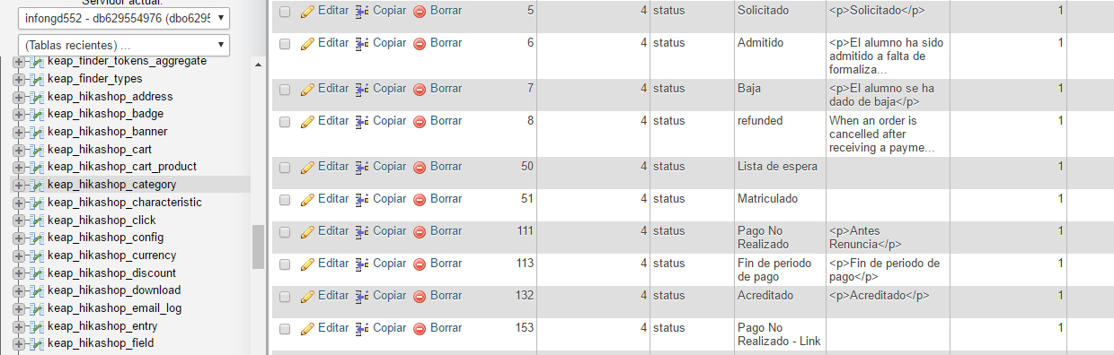

  • Posts: 267
  • Thank you received: 5
10 years 1 month ago #247827
Hello!
I have configured various types of state.
Try status "Proceso Iniciado" does not detract from stock .
And the state " Matriculado " reste of stock .
But it does not work!.
The status "Proceso Iniciado" always reste of stock.
I'm doing something wrong !
Thanks!!

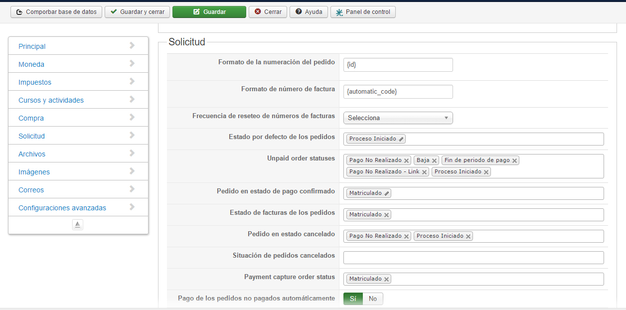

  • Posts: 26387
  • Thank you received: 4078
10 years 1 month ago #247844
Update the product stock on confirmed status: The product stock will be decremented only when the order status changes from created to one of the statuses selected in the "invoice order statuses" option, and not when the order is created.
I can see that you setting "invoice order statuses" is not fully configured.
In your screenshot it is named "Estado de facturas de los pedidos" and just contain the value "Matriculado".
