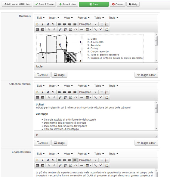

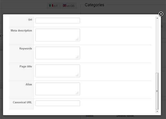

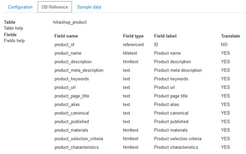

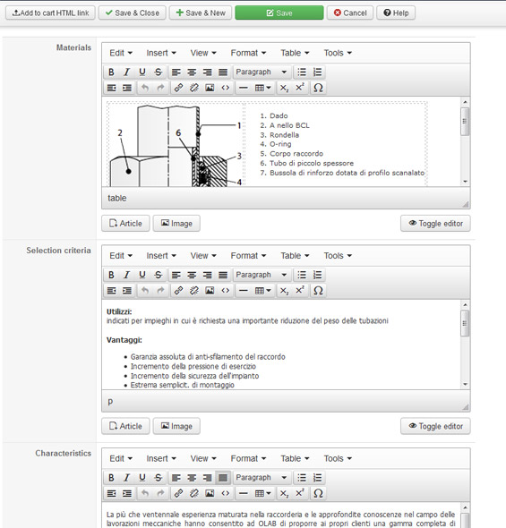

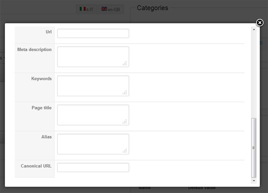

  • Posts: 99
12 years 5 months ago #147634
I attach here some screenshot about configuration and views where custom fields are missing ...
Thank you for any suggestion
  • Posts: 86051
  • Thank you received: 14178
12 years 4 months ago #148557
Adding the fields as being translatable in Falang/JoomFish won't make them appear in the translation edition popup of Hikashop.
What that allows you to do, is to translate them via the translation interface of Falang/JoomFish.
So it's actually normal.

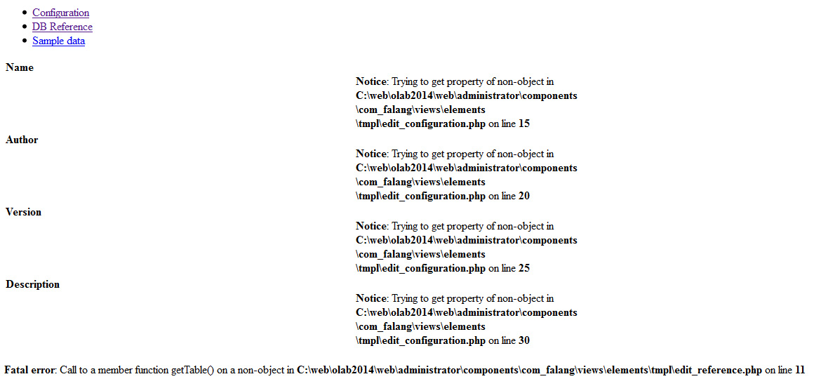

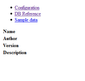

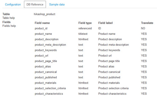

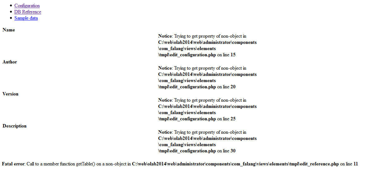

  • Posts: 99
12 years 2 months ago #156318
after upgrading to latest hikashop my backend in Falang for translations of hikashop products hangs (see attachment).
Maybe some field update in the db or something to re-update in Falang for custom fields ?
  • Posts: 50
12 years 2 months ago #156390
Do you have the latest version of Falang? There was an issue with Joomla 3.2 and 3.3.0 that broke everything. Latest update fixed that problem.
Mathias
  • Posts: 86051
12 years 2 months ago #156454
Otherwise, turn on the "debug mode" and "error reporting" options of the Joomla configuration and try again.
That should then display an error message on that blank page with more information on what's going on.
  • Posts: 99
12 years 2 months ago #156503
I've the latest 1.40 falang, this problem comes after the update of hikashop, previously with J3.3 and Falang 1.40 it works fine.
This should be connected to custom fields previously added, but in hikashop backend they still works fine.
Here is a screenshot with the debug/error_reporting enabled if I try to access the "Content Elements - Hikashop Products" section.
Also if I try to access the Translations sections the hikashop products are listed, clicking on a product it reports a white screen with this error:
Fatal error: Call to a member function getTable() on a non-object in C:\web\olab2014\web\administrator\components\com_falang\models\ContentObject.php on line 738
I've also tried to uninstall an reinstall Falang but nothing changes ...
