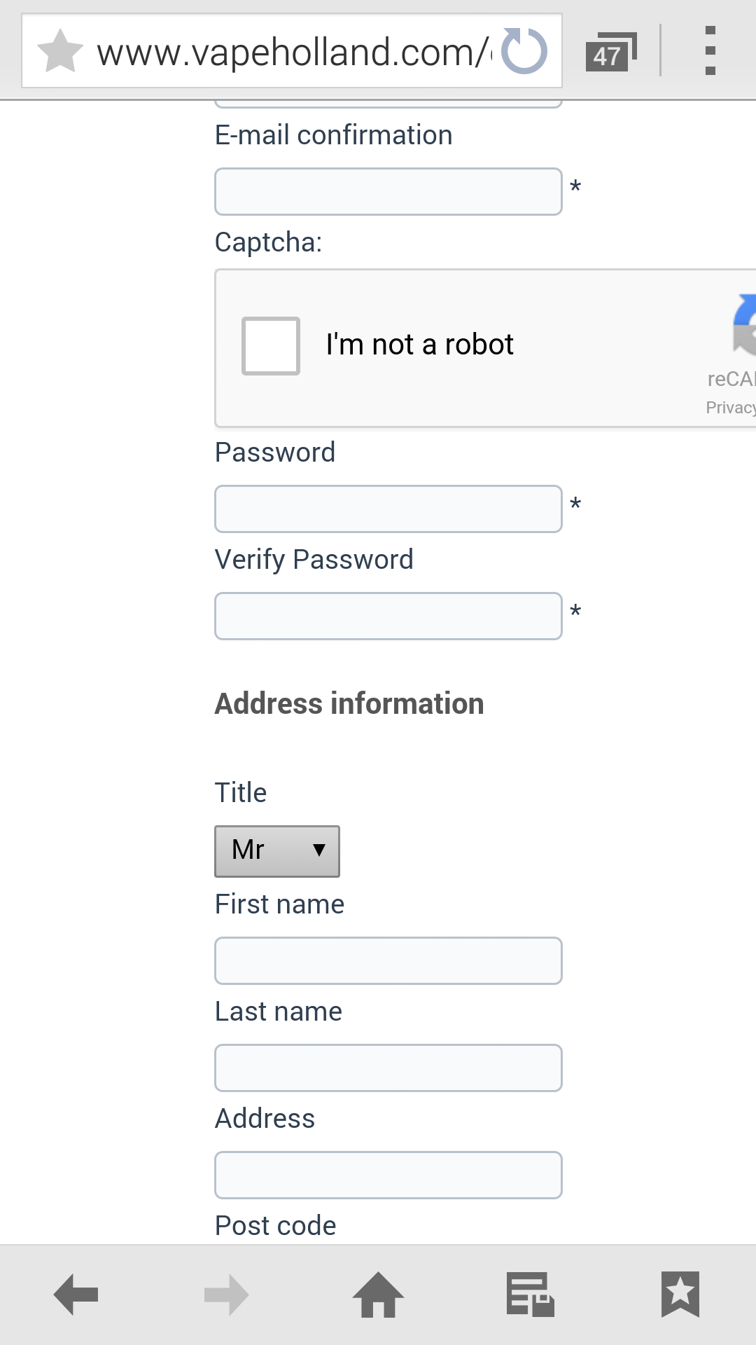

  • Posts: 52
11 years 6 months ago #188486
Match better! Great Job! On the mobile it's only litlebit to large. Check image on Samsung s5
EY
Kind regards,
William van Veen
Wveen.com

@wveencom:
I can't do much on that. The width of the zone is defined completely on the Google side. It's great that it works for you too.
