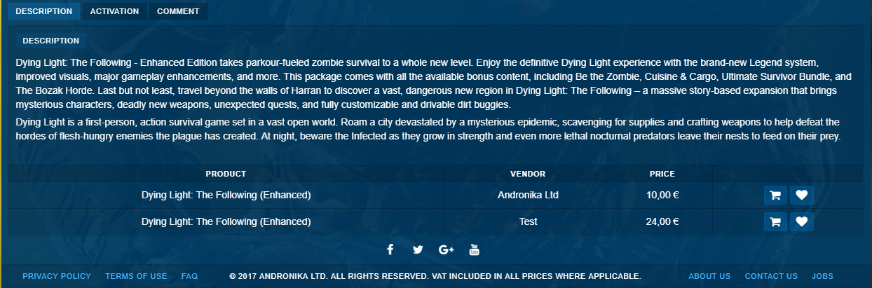

8 years 11 months ago #278423
Hi how to change the position of the characteristics to be at the top of the product and not the bottom?

8 years 11 months ago #278904
Unfortunately, I was unable to find the exact code. Can you give me a hand ? My view is show_tabular. Which code should I look for?

8 years 10 months ago #278968
Hi, unfortunately not this code. Even when you delete this code, the table is still available and is at the bottom.

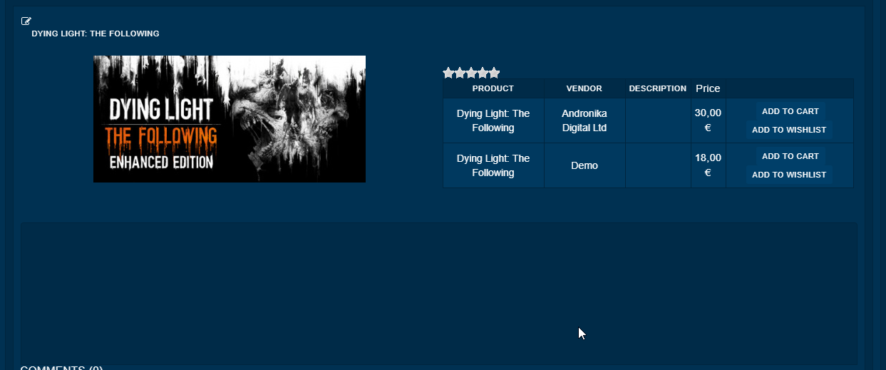

8 years 7 months ago #285343
Hi, I've found the code for this view but I have a few problems:
1. The code for this view is located in show.php row 93 - 96
code
if($this->params->get('characteristic_display') == 'list') {
	$this->setLayout('show_block_characteristic');
	echo $this->loadTemplate();
if changing code
if($this->params->get('characteristic_display') != 'list') {
the table will disappear which is my goal.
Now my goal is to show it elsewhere
I change the code in show_tabular row 117 - 119
changed to
now shows right where I want.

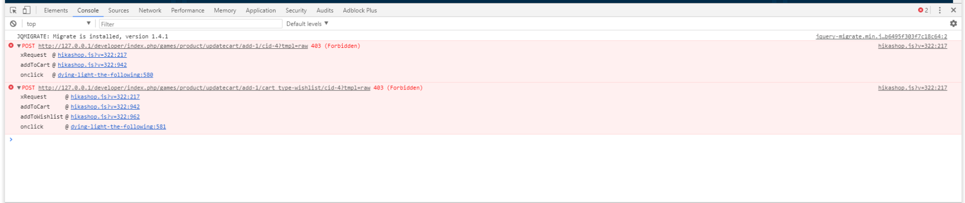

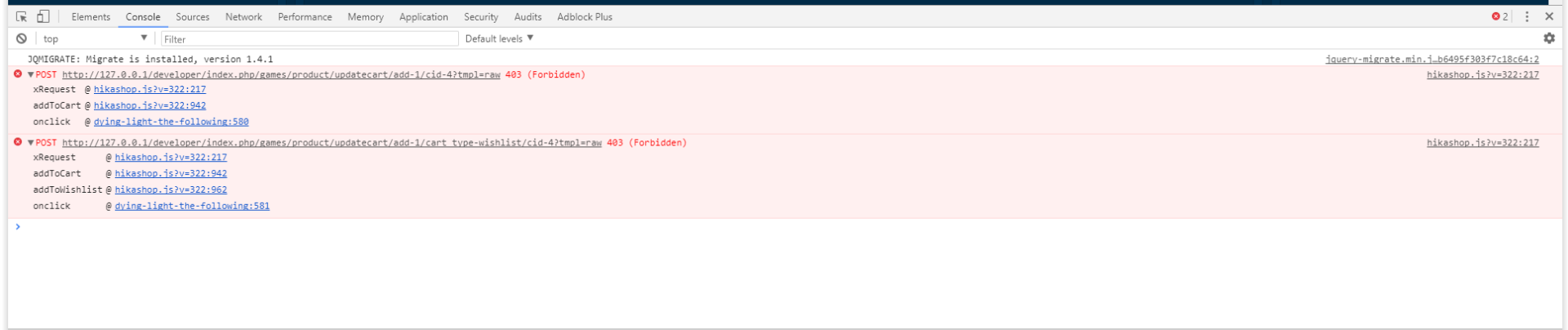

But here comes the problem, the first variant is working normally but the second does not allow me to add either the cart or to wishlist.
Error
POST http://127.0.0.1/developer/index.php/games/product/updatecart/add-1/cart_type-wishlist/cid-4?tmpl=raw 403 (Forbidden)
xRequest @ hikashop.js?v=322:217
addToCart @ hikashop.js?v=322:942
addToWishlist @ hikashop.js?v=322:962
onclick @ dying-light-the-following:317
2. I see there are many lines I can show from show_block_characteristic.php. How could I enable and disable the fields I want to show or hide?

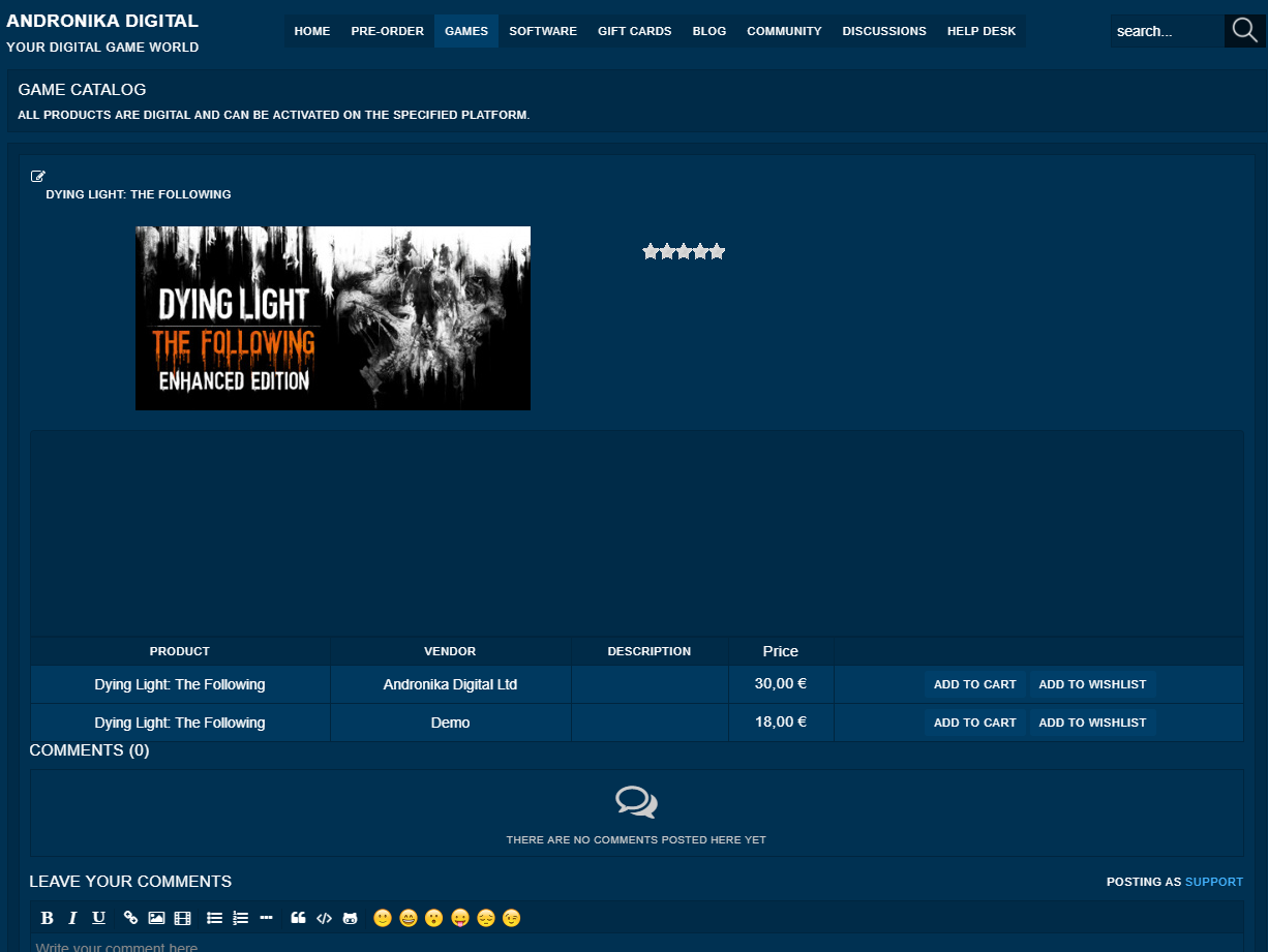

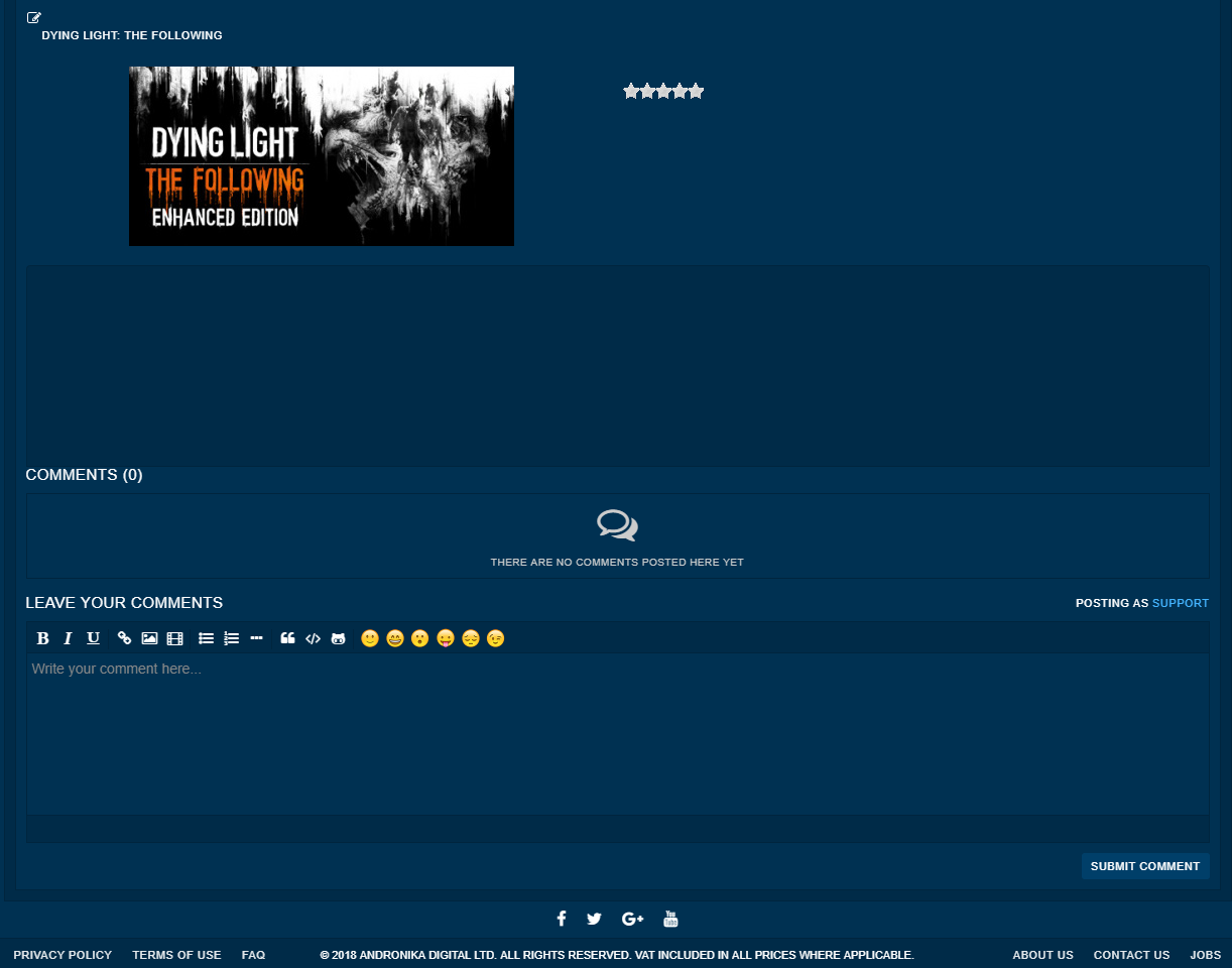

8 years 7 months ago #285402

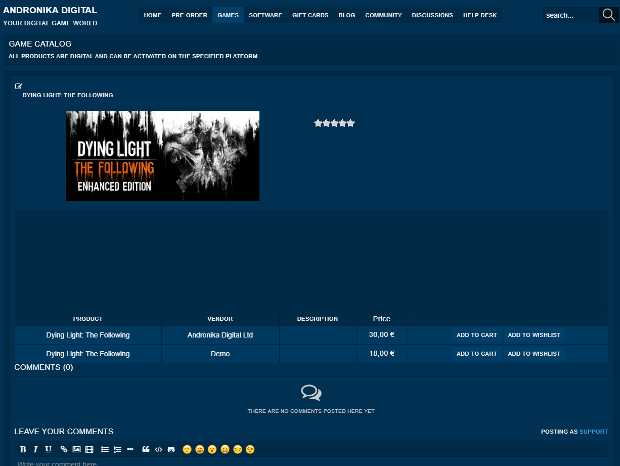

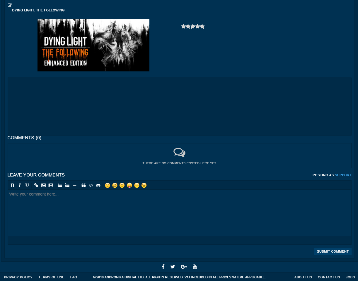

Hi thanks for responding to my problem. Now I will describe all the steps.
1.There is the position of the table before all changes
2. This is the code before editing it (show.php)
3. After editing

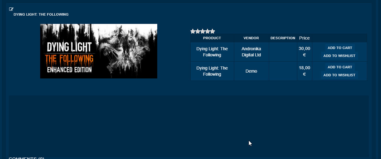

4. Result
5. This is the code before editing it (show_tabular.php)
6. After editing
7. Result, I now have to design and remove the fields I do not want to see in the table
8. The error of adding the second variant to the cart and wishlist
Last edit: 8 years 7 months ago by neo191987.
  • Posts: 86058
  • Thank you received: 14184
8 years 7 months ago #285405
The problem of doing that change is that now you have one form around each add to cart button and one form around the whole product page.
And you can't have a form in a form in HTML, that's not valid and it creates that issue.
You have two solutions:
- You edit the file "show" of the view "product" and you remove the main form of the product page.
- You remove the form around each add to cart in the "show_block_characteristic" view file.

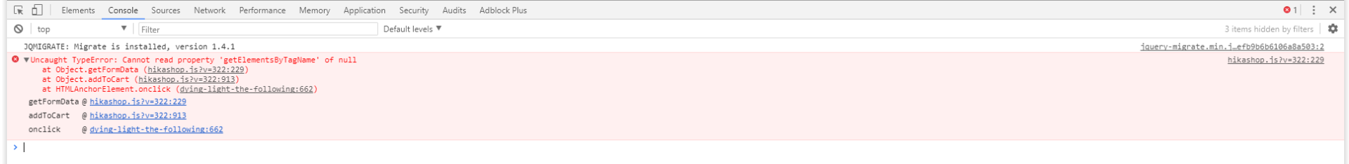

8 years 7 months ago #285450

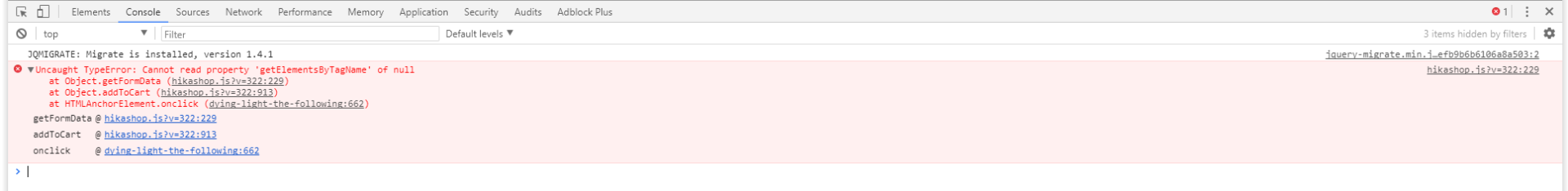

Hi, now it really works, but there is another problem. Adding a product to cart or a wishlist no longer shows popup for that the product has been added and directly redirects to an order or wishlist, I also get one error.
The steps that I made
1. I removed this code from show.php (row 58) - Incorrect. Fix: Move to show_tabular.php, above characteristics code (row 116)
<form action="<?php echo hikashop_completeLink('product&task=updatecart'); ?>" method="post" name="hikashop_product_form" onsubmit="return hikashop_product_form_check();" enctype="multipart/form-data">
2, Whether I add the product to the cart or wish list I get this error
Is there a way to fix this or if I'm wrong what exactly do I have to do?
Last edit: 8 years 7 months ago by neo191987. Reason: Fix
  • Posts: 86058
8 years 7 months ago #285455
That's normal as HikaShop is normally expecting that this form element is present on the page.
Instead of removing it, place it just before the </form> tag in that same file.

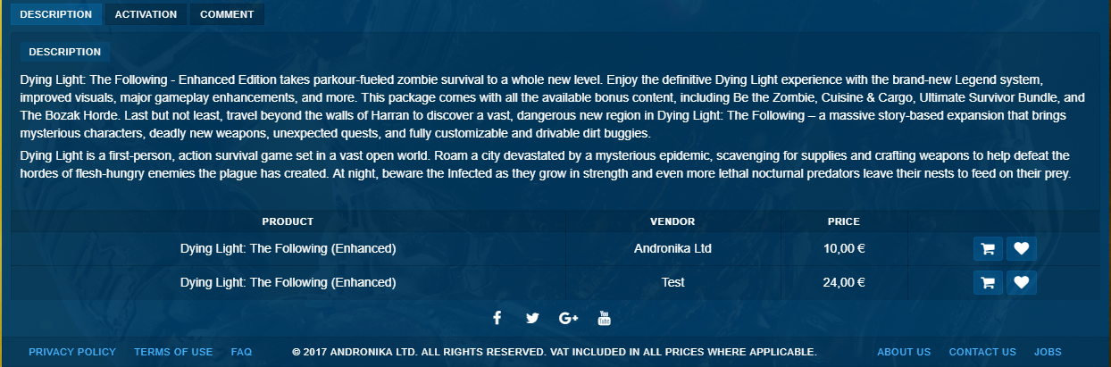

It took me 5 minutes to do it right. You gave me good guidelines for which I am grateful to you. :)
