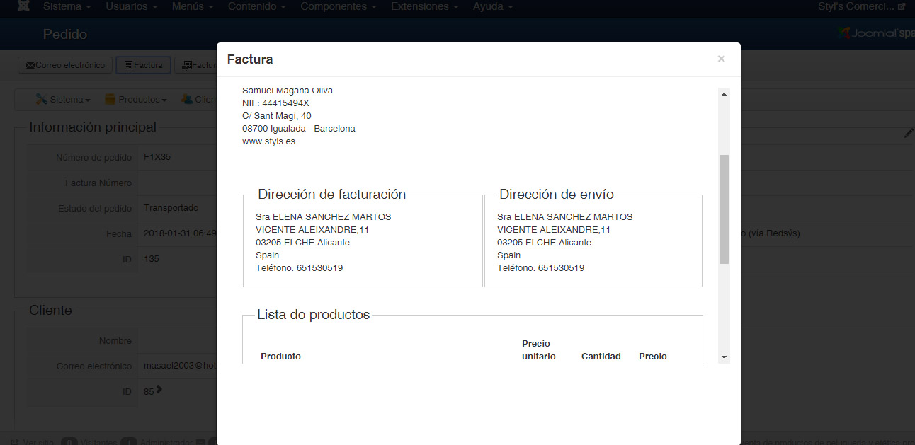

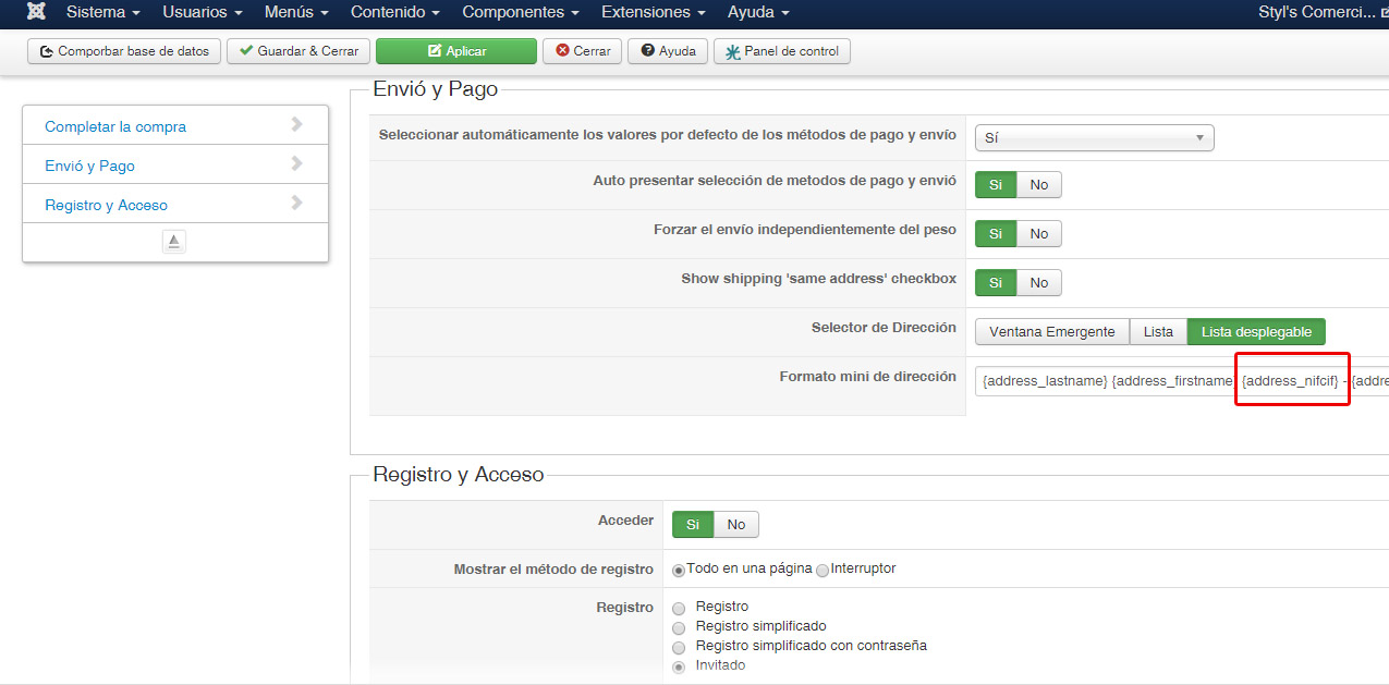

  • Posts: 39
8 years 6 months ago #287081
I have added the tag exactly as you said but it does not appear in the NIF in the invoice. Attached screenshots of the last purchase, of the tag that I added.
I hope you help me because it is urgent.
Thank you very much
  • Posts: 86058
  • Thank you received: 14184
8 years 6 months ago #287082
That's the "mini address format" parameter. I was talking about the "address format" parameter. I had forgotten that you had a really old version of HikaShop. This option was added since HikaShop 3.0.0.

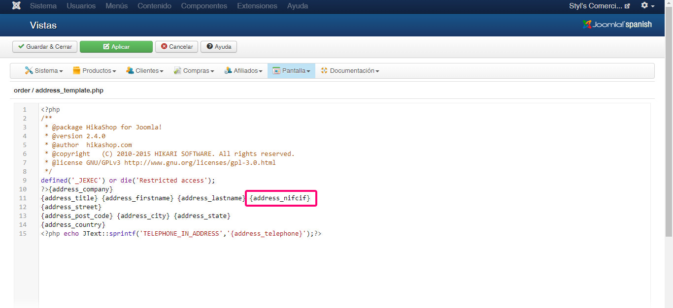

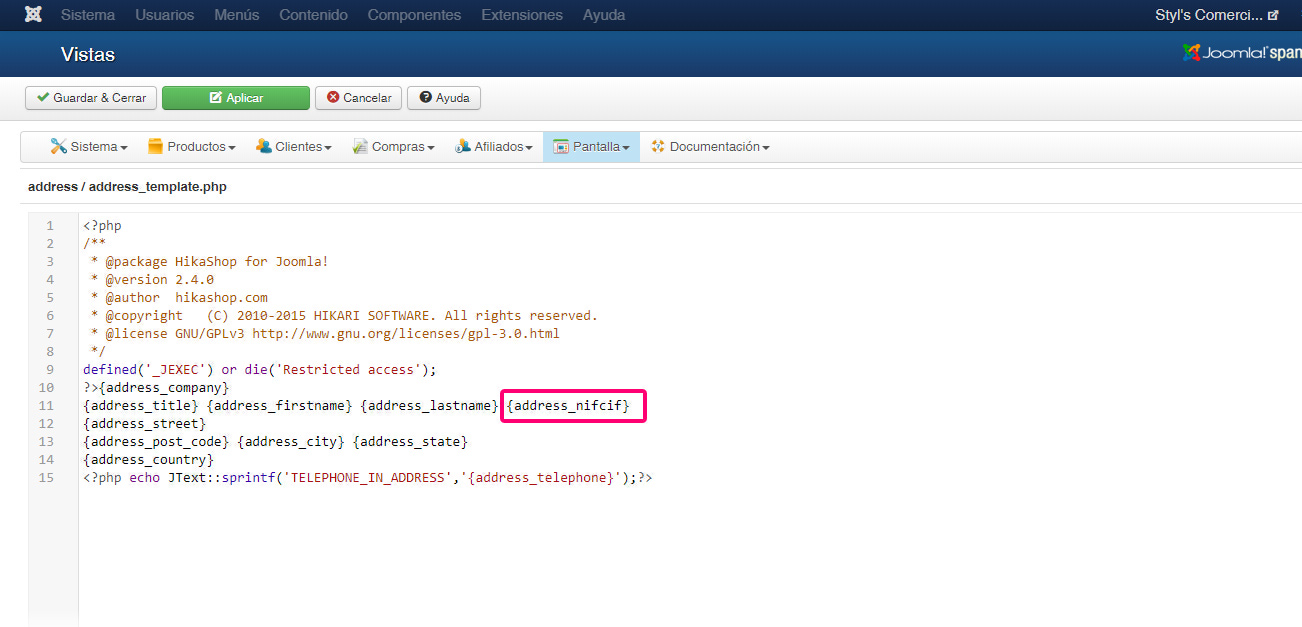

  • Posts: 39
8 years 6 months ago #287153
Hi, I added the label in the address_template of the front_end i the back_end, I created a new order after emptying cache but the NIF does not appear in the invoice, is the code that I have put in the correct location correct?
Thank you very much
  • Posts: 86058
8 years 6 months ago #287156
You need to respect the format of the tags.
As you can see with the other tags, you need to put the column name of your custom field with brackets around it.

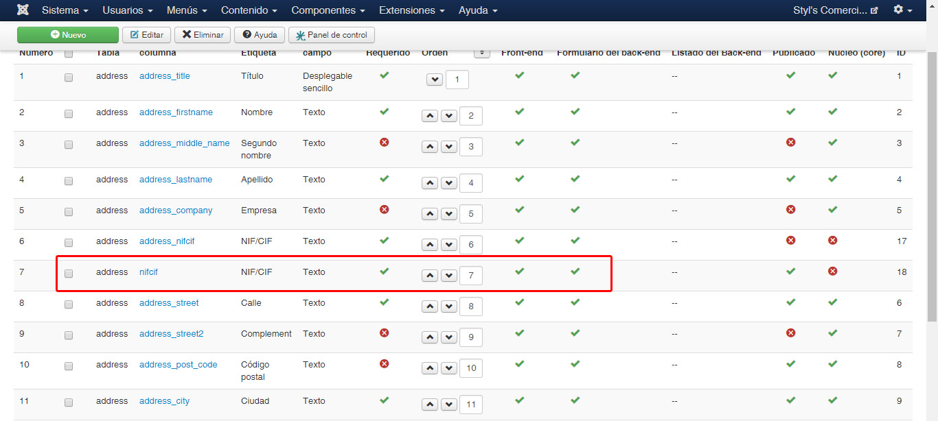

But the column of your custom field is not address_nifcif it's only nifcif.
So the tag should be {nifcif} and not {address_nifcif}
