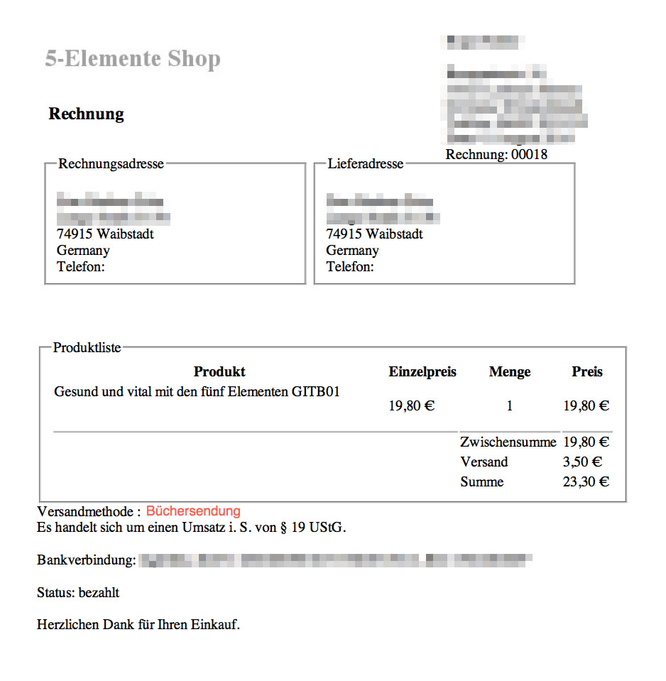

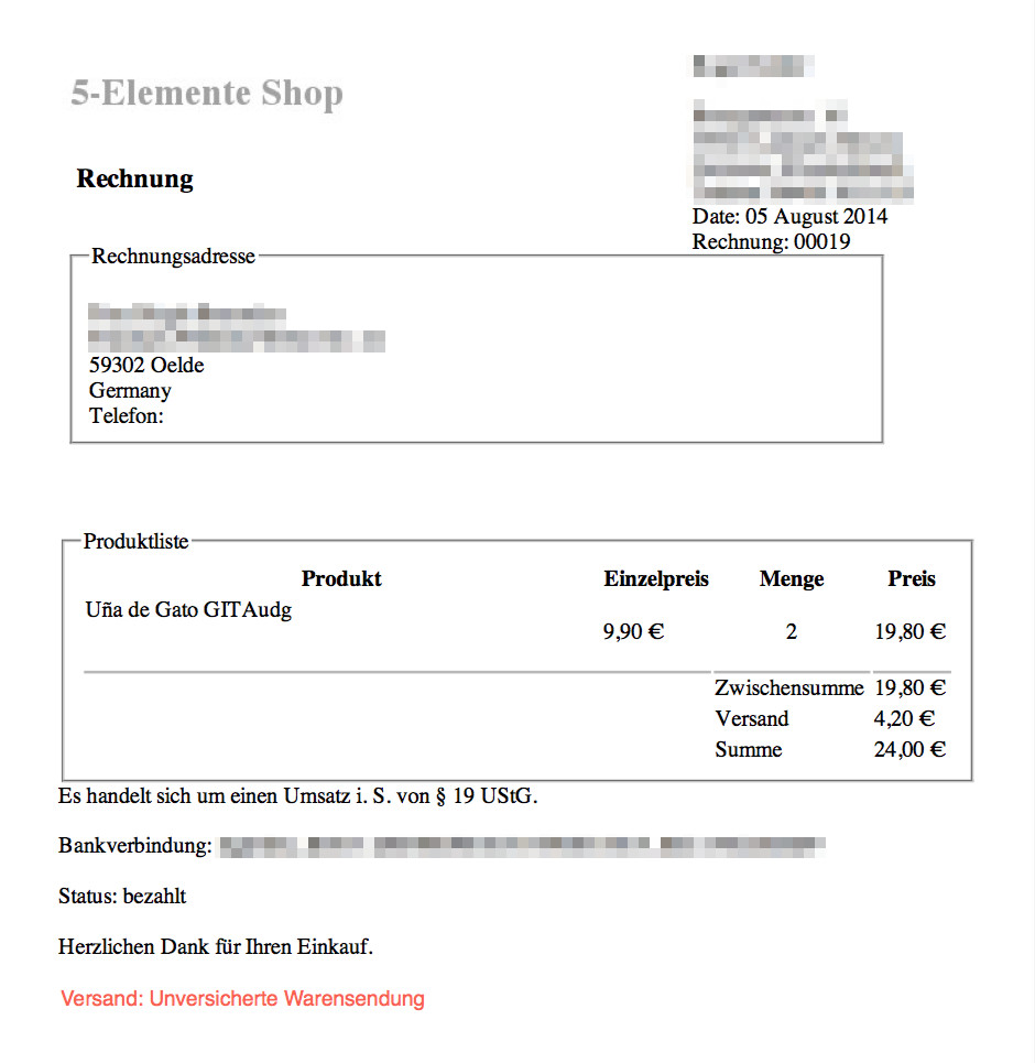

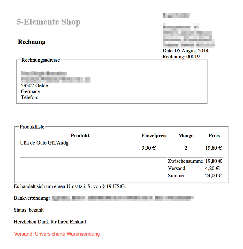

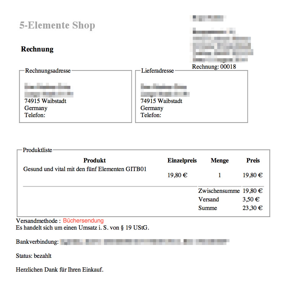

  • Posts: 159
11 years 10 months ago #168300
Hi Jerome,
sorry, my knowledge about debugging is not very deep. Please advise where to put the code and what to do. Thanks.
I attached two of my invoices. That will probably explain the problem better. I'm printing the invoices from the front end via a vendor account. I use two vendors. If I receive an order that contains products of the two vendors, the invoice looks different from an order that contains products only from one vendor.
Invoice number 00018 comes from an order that contained products from two vendors. It shows shipping address and shipping method (Versandmethode), but not the carrier. I put it in manually in red (Büchersendung) which is not a good solution, because I have to edit every single invoice.
The other invoice 00019 contains only products of one vendor. It doesn't show the shipping address and no shipping method. Again I had to put the shipping method manually in red (Versand: Unversicherte Warensendung)
I don't understand why the invoice output is different depending on the fact that more than one vendor is involved and why the carrier is not shown.
The shipping methods are set up for this vendor only. The other vendor is selling downloadable products and has an extra shipping method with 0 costs.
Roger
