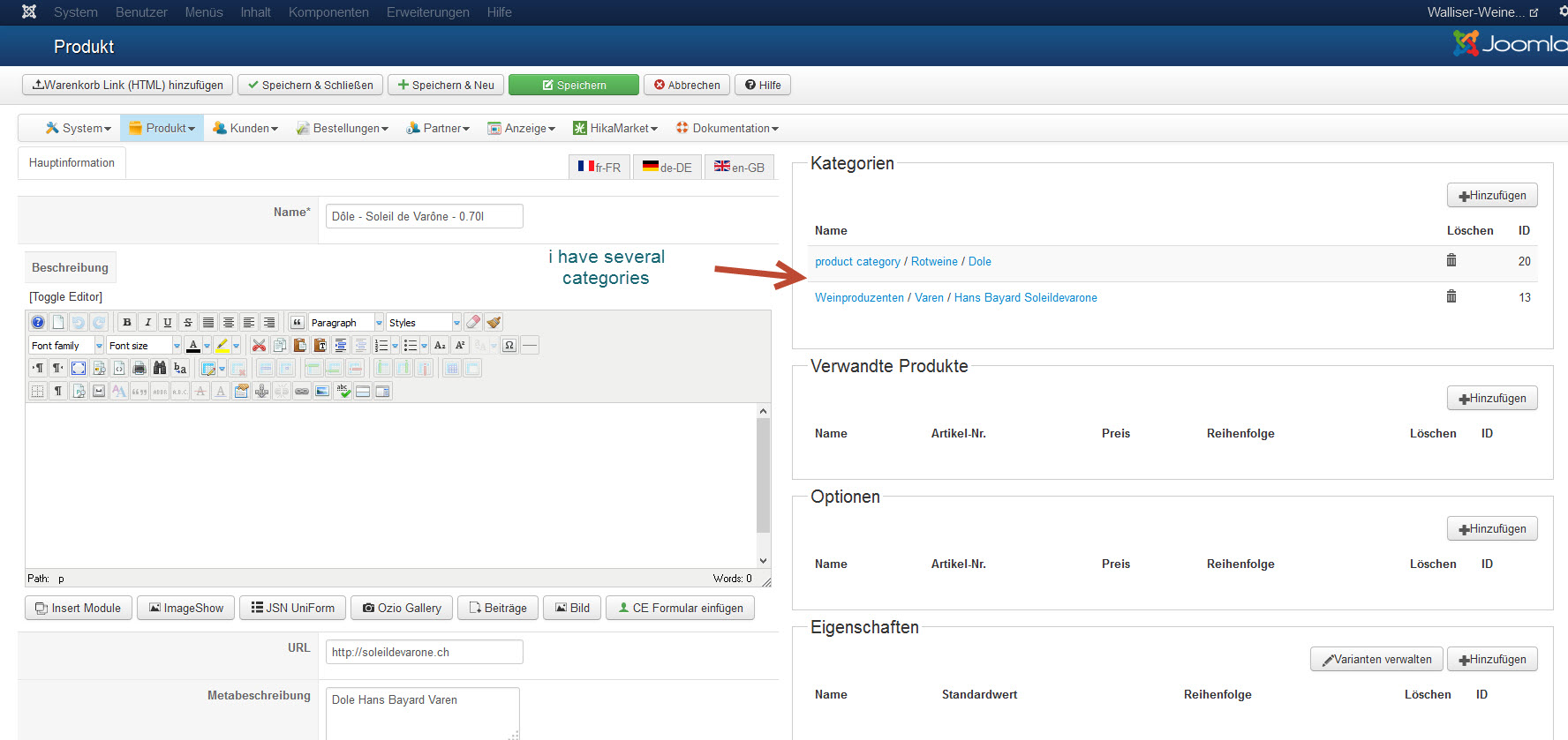

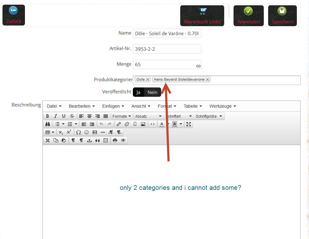

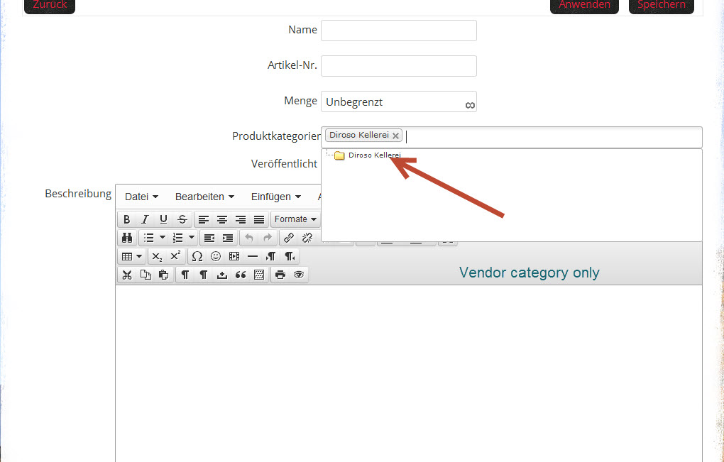

I have some problems with my vendors. They are not able to see or change the product categories through the front-end..
e.g
changing the category from red to white wine
or
when they add a new product, they cannot define the product category. Only the vendor is showing up correctly.

The product you show in your first screenshots just have 2 categories. In the HIkaShop backend you can see the path/breadcrumb to the selected category but there is still two lines so just two categories for the product.
About the other screenshots, because you set a root category for your vendors, they can see only the part that you allowed.
You might need to remove some restrictions in you want to allow your vendor to select any category in your store.

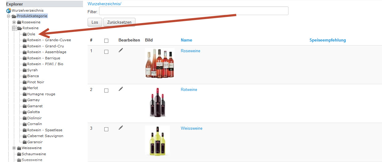

Does this mean, that i cannot have subccategories like:
Redwines as main category and pinotnoir as subcategories which should show up in the frontend for the vendor?
Markus

There is no subcategories restrictions or troubles.
You can have the structure you want, you just have to configure HikaMarket to let your vendor access to your product categories.

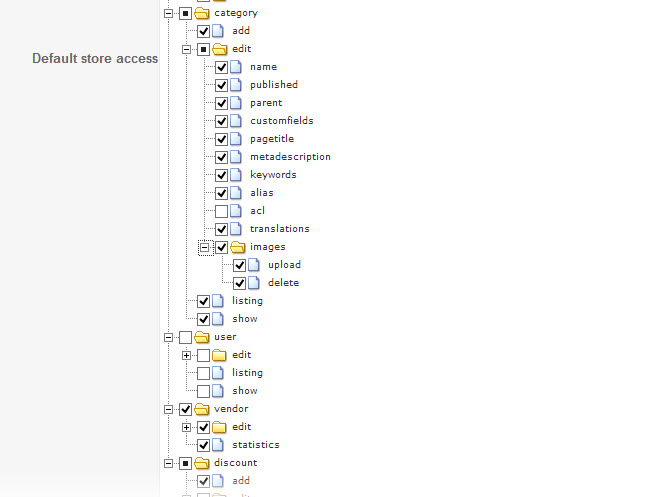

10 years 11 months ago #181114
As you can see, the category-access is checked. I still cannot see the product-categories.
What do i wrong?
Markus

Okay so.
You have 4 options in the HikaMarket configuration to set-up the categories.
www.hikashop.com/support/documentation/1...nfig_market_category
In your case, I don't know if you want to create a vendor category for each vendors but what I know is that you want to change their "root category".
Using the "vendor home" as "root category" is not useful in your case because you want to allow more categories.
So the best is to use the value "yes" and to choose the category which will be the root for your vendors.
You can select "product categories" if you want to allow all categories in your store, or you can use another category to put more restrictions.
Please note that even if you choose "product category" in the HikaMarket configuration, you will be able to override this setting for each vendor.
So you can have a vendor with a "root category" set on "Rotweine" for example. Thanks to that, the vendor will be able to select the category "Rotweine" and all sub categories of this one.
