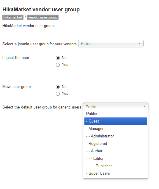

11 years 6 months ago #191306
Next one:
On existing user - vendor registration, I've set HikaMarket vendor user group->Move user group to YES, but no change happens. No new UG is assigned and the old UG is untouched.
The following user(s) said Thank You: the1st_expert

  • Posts: 26381
11 years 6 months ago #191319
The "move" option is there to remove the "default group" listed and replace it by the "vendor group".
Because Joomla 2.5/3.x have multiple group ; HikaMarket can't know how to move the user group, it could have several.

  • Posts: 26381
11 years 6 months ago #191357
I do not understand...

  • Posts: 134
  • Thank you received: 6
11 years 6 months ago #191361
Jerome wrote: I do not understand...
Ooops. It has been there obviously. I definetly had misunderstood the meading of that DD by the time I have tested it.
Thank You, Jerome!
