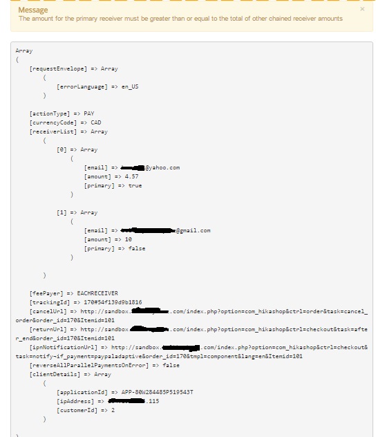

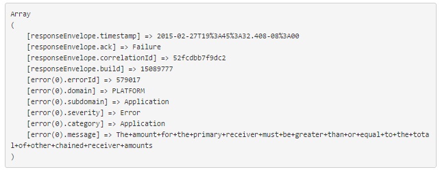

-- Joomla version -- : 3.3.6

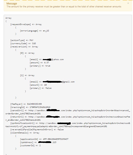

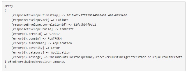

-- Error-message(debug-mod must be tuned on) -- : The amount for the primary receiver must be greater than or equal to the total of other chained receiver amounts

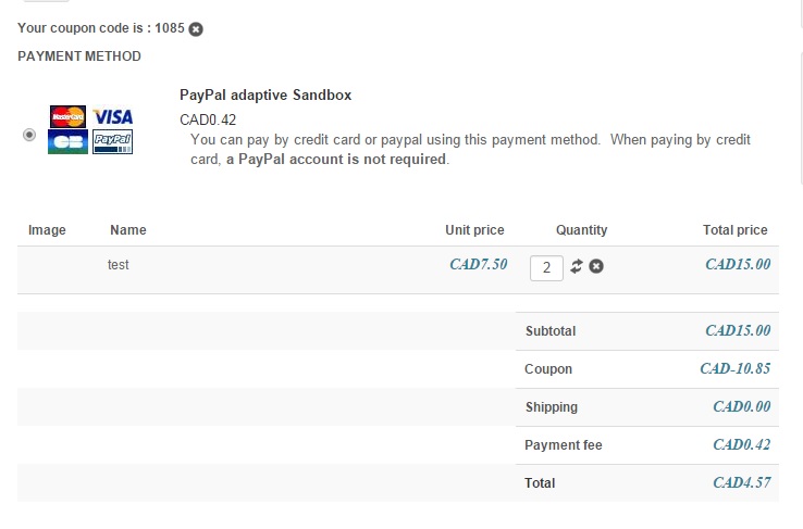

We have a customer who we have issued a coupon code for, and when they attempt payment they get the error above. I have duplicated this issue on our sandbox site. The coupon code is for $10.85 CAD. Paypal adaptive is configured for chained payments. With no coupon code the primary receiver receives 10.75 and the secondary receives 10.75.
Please let me know if there is any additional info you need.

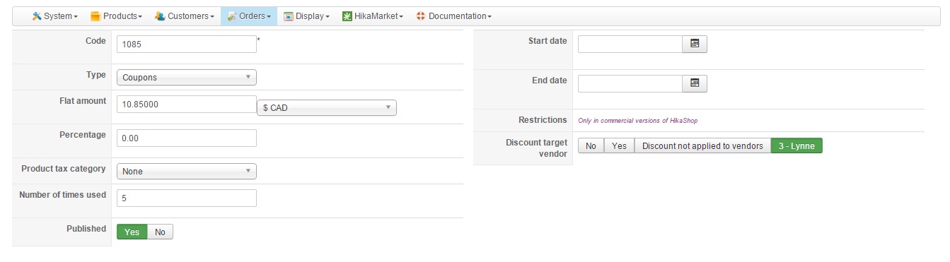

11 years 5 months ago #192522
Hikamarket Multivendor 1.5.1
Here's the screenshot of the coupon code in use:
Also, the product and the coupon are both assigned to the same vendor, who is the secondary receiver.
Steve

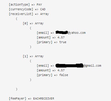

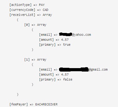

The issue you face is not really related to Paypal Adaptive but to the way that coupons are handle.
At you can see in the Paypal adaptive debug, the primary receiver price is right (4.57) but, in fact the second is not.
So I think you have the "coupon all product" issue that we fixed in HIkaMarket 1.6.0
www.hikashop.com/support/documentation/1...arket-changelog.html
Fixing a coupon value processing when the coupon code is for all products
We did not activate the automatic updates for HikaMarket yet but you can download the latest version thanks to your subscription page.

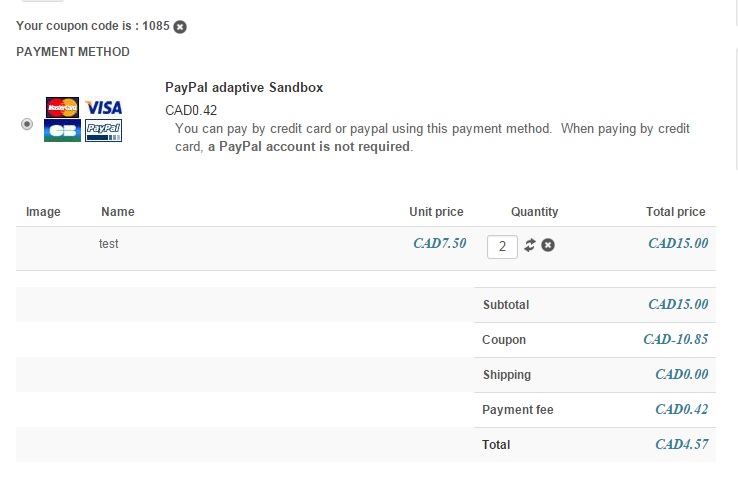

  • Posts: 26381
11 years 5 months ago #192559
I'll need details about the orders ; to understand what was really processing.

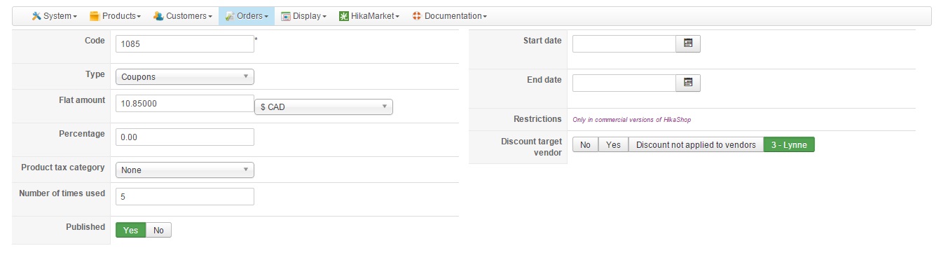

Otherwise I see that the coupon is targeting the vendor "3", is it right the vendor 3 in your test ?
Can you perform a test with a coupon where the target vendor is set to "yes" ?
If the coupon is not applied to the vendor, it means that the store should take it for himself.
So the client have the discount but the vendor is receiving the classical amount ; like for a "refund coupon".
At this moment, I don't know how it can be handle by Paypal Adaptive because the customer should have the discount but the vendor should be paid normally..
And that's not even possible with paypal adaptive.. So I have to find a good way to handle such unusual case !

Setting the target vendor to "yes" corrects the problem.
To answer your question, vendor 3 created the coupon from the front end so the coupon defaults to vendor 3 as the target. Also, the product the customer is purchasing was created by vendor 3 as well.
