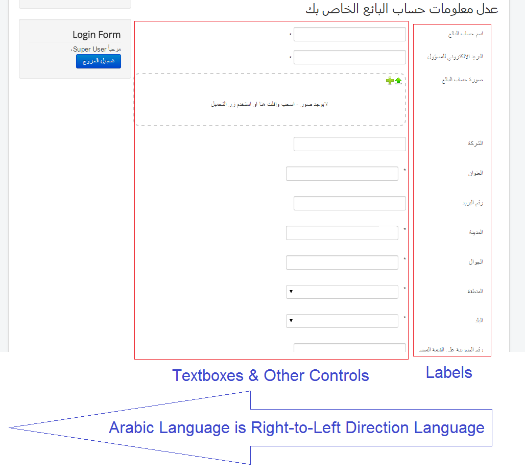

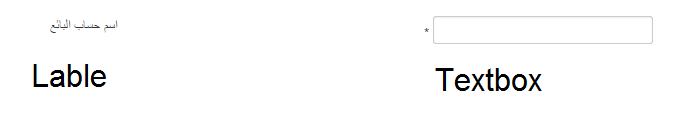

  • Posts: 28
11 years 1 month ago #205682
One of most important things in RTL is to have the Label with the Textbox switched automatically when an RTL Language is chosen.
Currently it is showing as:
but the required is to have it like:
If you need more clarification please let me know.

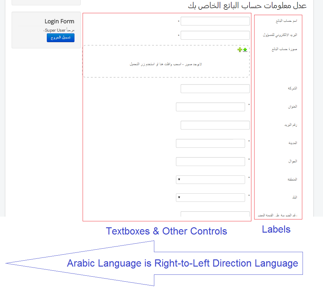

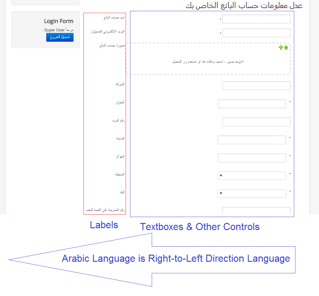

  • Posts: 28
11 years 1 month ago #205835

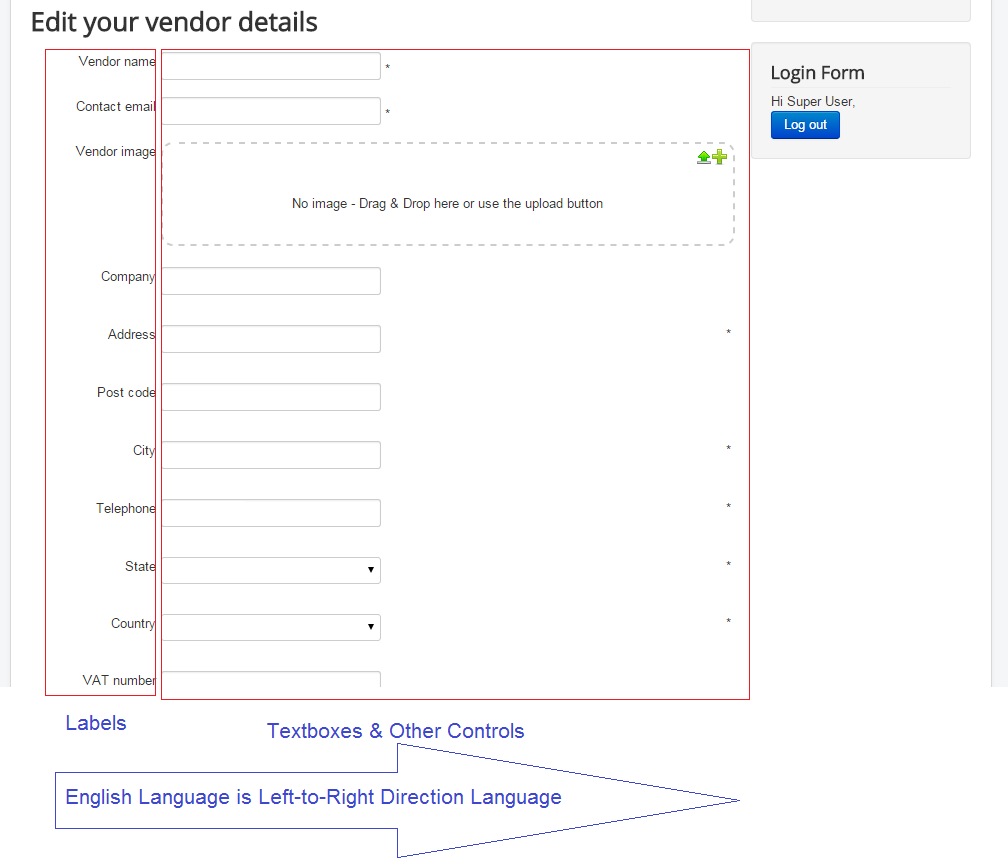

From Code side I am not sure how that should be fixed. However, I will try to explain it a little bit more with images.
in the English language, the following shows correct directions:
However, In Arabic language it shows the same style, where labels are on the left and textboxes on the right, as follows

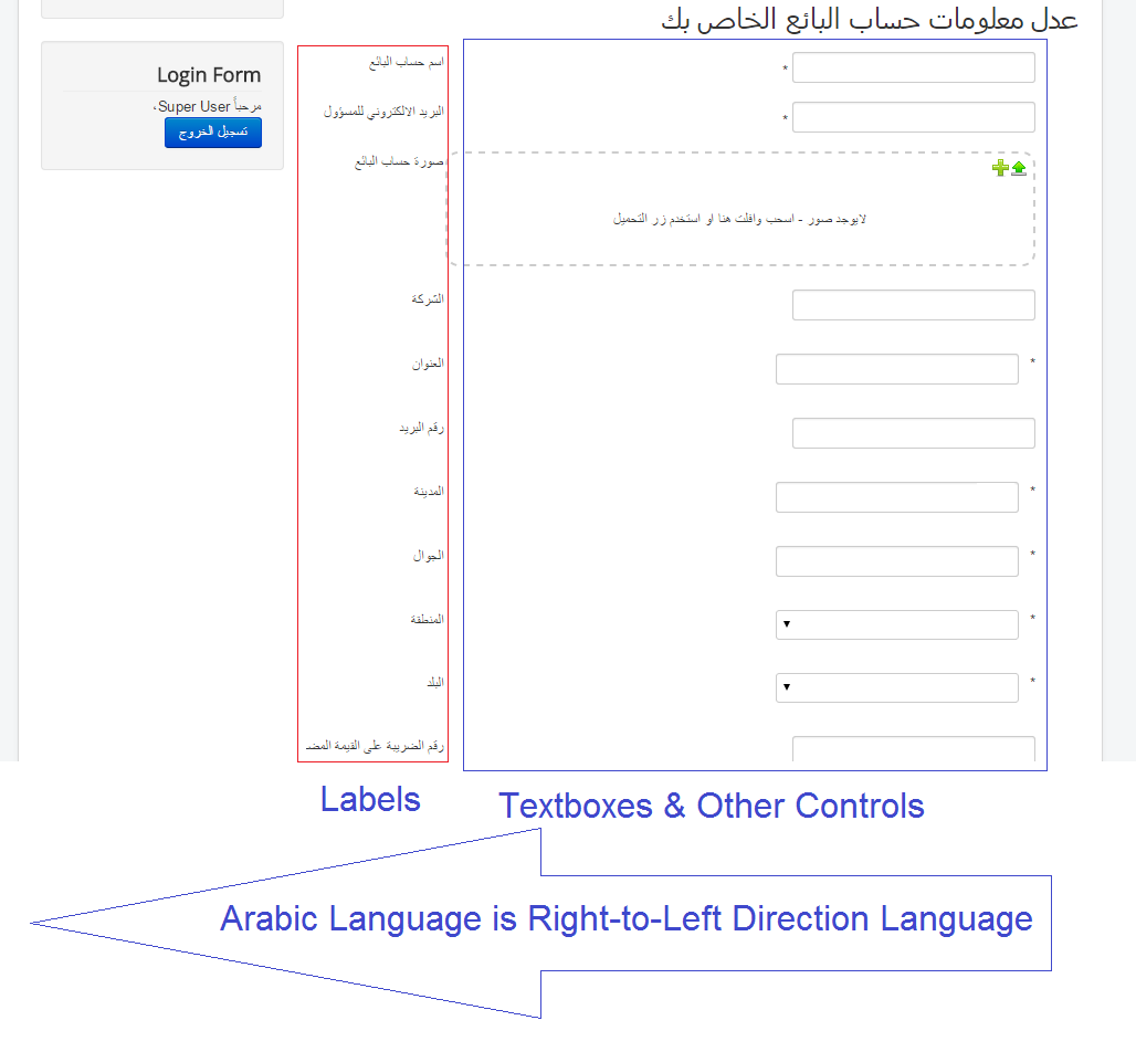

This should be Fixed be swapping the locations of the label and the textbox, the label to be on the right and the textbox to be on the left, as follows:
From the code side again I am not sure how to fix it, but i was checking the code and I swaped the <dd> with <dt> and the opposite <dt> with <dd> just to check the result, and I have a theory:
you may have in the CSS defined something to have the <dd> to be on the right, and <dt> to the left. Maybe if you change it for the RTL to have it reversed it may work.
However, even when I changed the <dd> and the <dt>, there was some fixes required in the alignment, margins and paddings.
I appreciate your help and I have been waiting for this to be fixed.
Thanks.

  • Posts: 26381
11 years 1 month ago #205858
You should use that code in order to reverse all dl/dt/dd in HikaMarket :
dl.hikam_options > dt {
	float:right;
	clear:right;
	text-align:left;
dl.hikam_options > dd {
	margin-right:130px;
	margin-left:0px;
dl.hikam_options.large > dd {
	margin-right:190px;
	margin-left:0px;
Don't hesitate to give me your feedback on it.

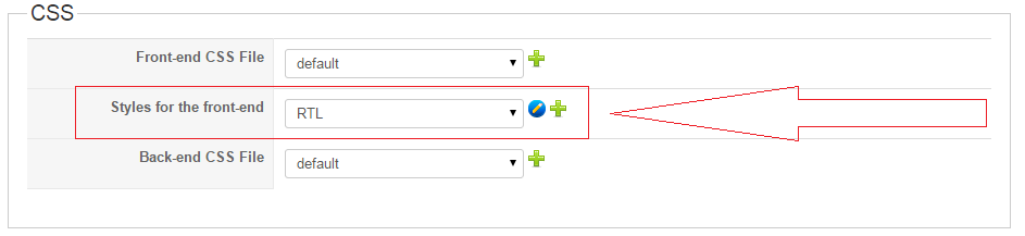

11 years 1 month ago #206157

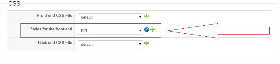

I have put it in the Hikamarket configuration->Main (Tab)
However, this is being applied on all languages. would you please provide the complete path for the CSS that is being applied only on RTL languages.
Thanks.
  • Posts: 26381
11 years 1 month ago #206177
Since HikaMarket 1.6.3, there is an RTL CSS and like in HikaShop, that CSS file is not display/editable in the backend.
So it means that you have to edit that file manually.
Changing the front-end CSS or applying a style for the front-end will, for sure, be applied on every languages because you are loading a CSS file in every cases.

  • Posts: 26381
11 years 1 month ago #206527
media/com_hikashop/css/rtl.css
media/com_hikamarket/css/rtl.css
Or you have to deal with your template in order to have a special RTL file which will be include only for the RTL context.
