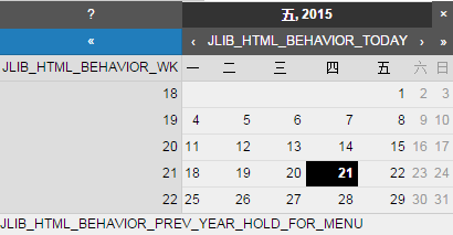

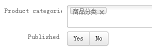

-- Error-message(debug-mod must be tuned on) -- : Yes/No button do not work and the calendar displays wrong word in front
The Yes/No button do not work in front, It just look like a image.
and the calendar displays wrong word in front,
but they all work good in backend

With just an image I won't be able to help you.
About the calendar, it looks like you have something wrong in your translations, the Joomla "html behavior" translations file might be broken, incompleted or not loaded correctly.

Your template is "bootstrap 3" and not "bootstrap 2", so the "yes/no" buttons are not working properly because there is an issue with the bootstrap 3 javascript.
So the best will be to deactivate the "bootstrap design" in your HikaShop configuration.
About the calendar ; please check that your "lib_joomla.ini" is loaded and completed ; you can use the "debug language" setting in your global Joomla configuration to have more details.
Here the original Joomla lib language file where you can find the translations :
github.com/joomla/joomla-cms/blob/stagin....lib_joomla.ini#L366
Last edit: 11 years 2 months ago by Jerome.

I found that the lib_joomla.ini did not be loaded in front, however It works well in my local test server before.
I don't know what happened here and how to fix it.
How could let the lib_joomla.ini language file auto load with the page?
thank you~
  • Posts: 26381
11 years 2 months ago #202549
So the best will be to force the loading of the lib_joomla language file
www.hikashop.com/forum/checkout/870639-l...-problem.html#169046
In your case, you can see to add the two lines
$language = JFactory::getLanguage();
$language->load('lib_joomla', JPATH_SITE);
directly in the hikamarket.php file (near the beginning).
But the problem is not related to HikaShop or HikaMarket ; that language file should be loaded by Joomla itself.
So if you have further issue with the loading of that language file, I recommend you to use the Joomla support forum in order to know more about the language loading problem.
