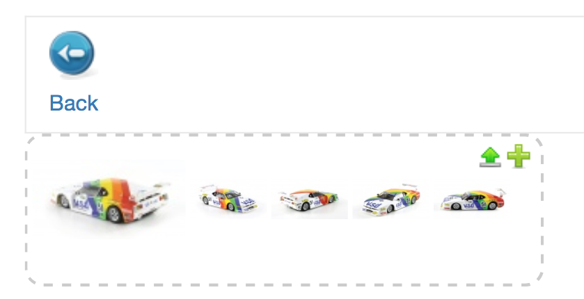

There are a couple of things really annoying and that make image upload inneficient:
1. Files get sorted by the order they finished upload. Therefore if I upload ten images my_image_01.jpg to my_image_10.jpg if all images are 500 KB and image_05 is 30 KB it will almost sure end upload before the others as they upload in parallel, then image_05 sits in first position.
There should be a checkbox to force picture to get ordered alphabetically. Otherwise massive uploading is absolutely inefficient as it requires a second manual process of reordering the pictures.

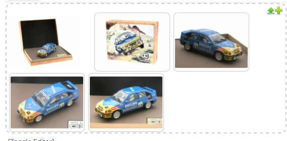

2. Picture handling (drag 'n' drop) inside the box could be improved, if you peak an image which is in the border of the dashed square is not easy to move it to the desired position. You have to do trickery with two or three pictures to achieve the desired ordering.
3. Thumbnail size should be configurable for this area. I'm sure many users would appreciate it.
I managed to make some slight improvements just by CSS but a good coder would make a giant leap with some dedication and we all would benefit from a better HikaMarket interface.
1. Clunky Image Uploader
2. Slight improvements that make handling more comfortable

3. You can reduce the size of the "second" thumbnails thanks to CSS.
But I admit that for the moment the size of the thumbnails are fixed in the view so it currently require a view override to make it bigger (than 100x100 pixels).
The idea behind the image management was to have a clean interface.
Maybe the thumbnail images could be displayed with the "force size" option so you will always have a square image ; which could make the "selection" easier. If you are using thin images it could become hard to click/see them.
The addition of the border could be useful to delimit them but could be confusing with just kind of "decoration".
During some tests, I saw that users though that the border was part of the image and wanted to know how to remove them.
But we can think about other kind of solution, more a little more than just a round border (and modify a little bit the style when the move is hover the image, so the user can see that it's not a part of the image).
