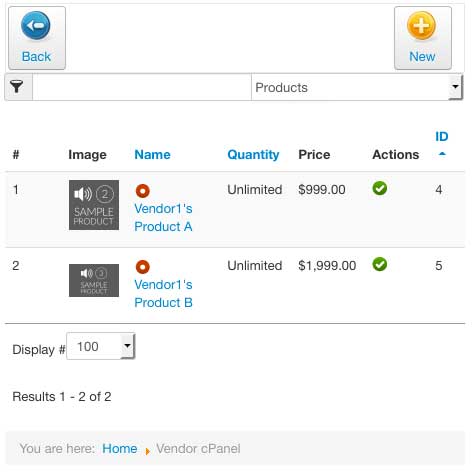

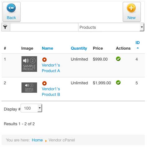

Scenario:
Vendor has added products, looks them up in the vendor product listing.
In case it matters: Vendor has set the products to "published", but Admin has not approved them yet. Just FYI, his is what it looks like:
1.) Can not sort the list by clicking <th> items like ID or Name.
a.) Nothing happens, the order remains the same.

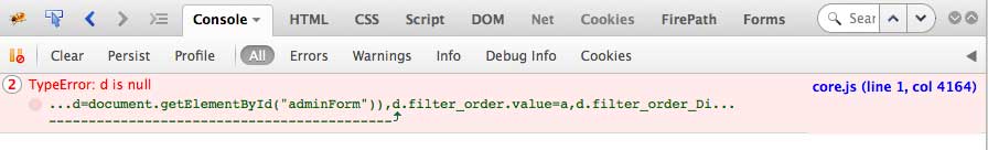

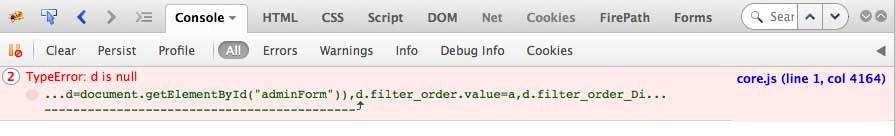

b.) Each click on such <th> throws a JS error:
You may know, but it's in /media/system/js/core.js

10 years 11 months ago #206725
1) Great, they changed the core javascript again !

1/ I don't know..
The fast solution will be to replace the form in the begin of the productmarket | listing view
<form action="<?php echo hikamarket::completeLink('product&task=listing'); ?>" method="post" name="adminForm" id="adminForm">
What I can tell you is the javascript modification is pretty recent in Joomla 3.
2/ For the moment the "getPageInfo" function is called with default arguments in the product listing function.

1.) Changed name and id, and yes, sorting works now. Thanks.
Guess you'll have that in the next version? I'll find out.
