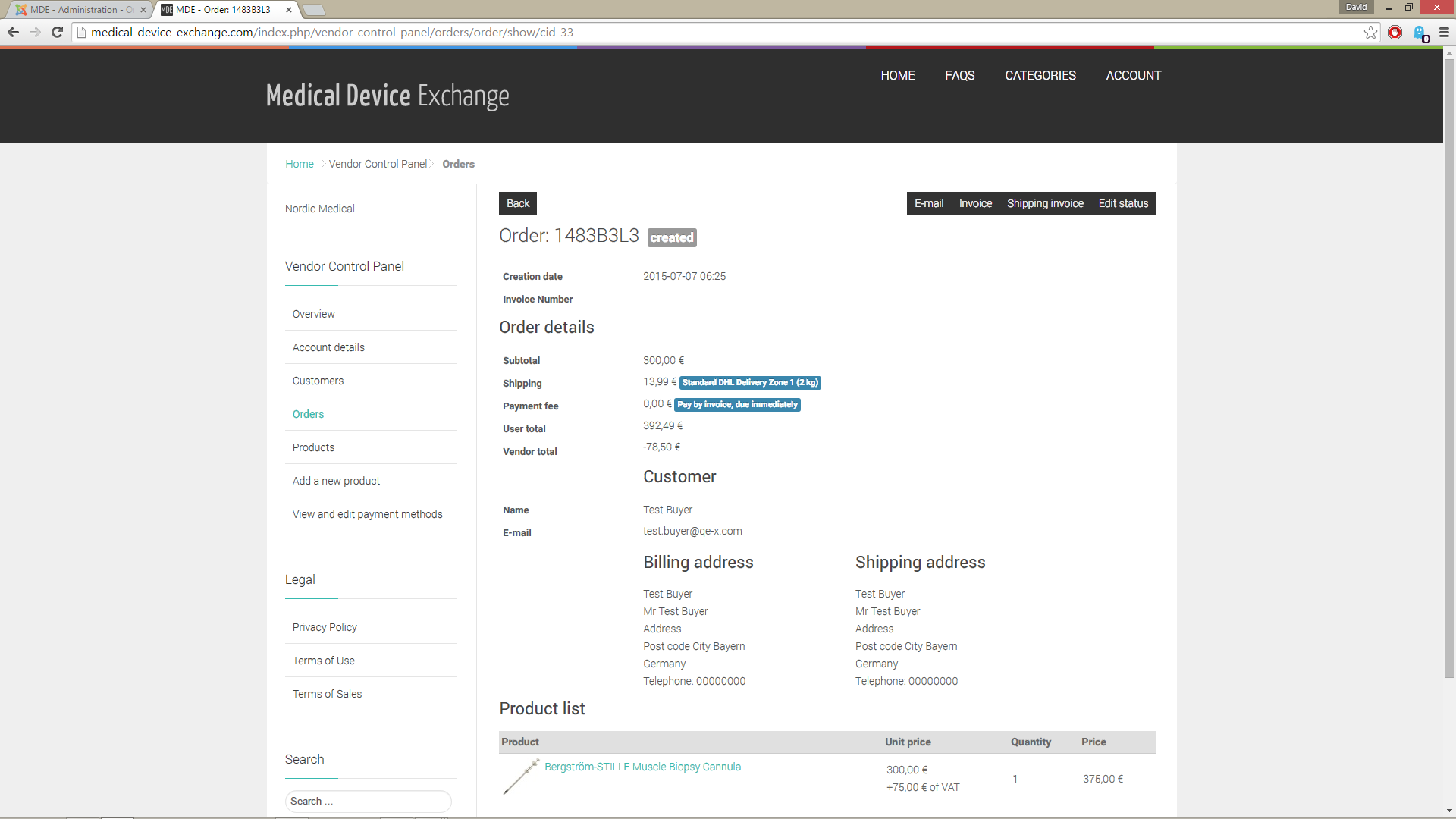

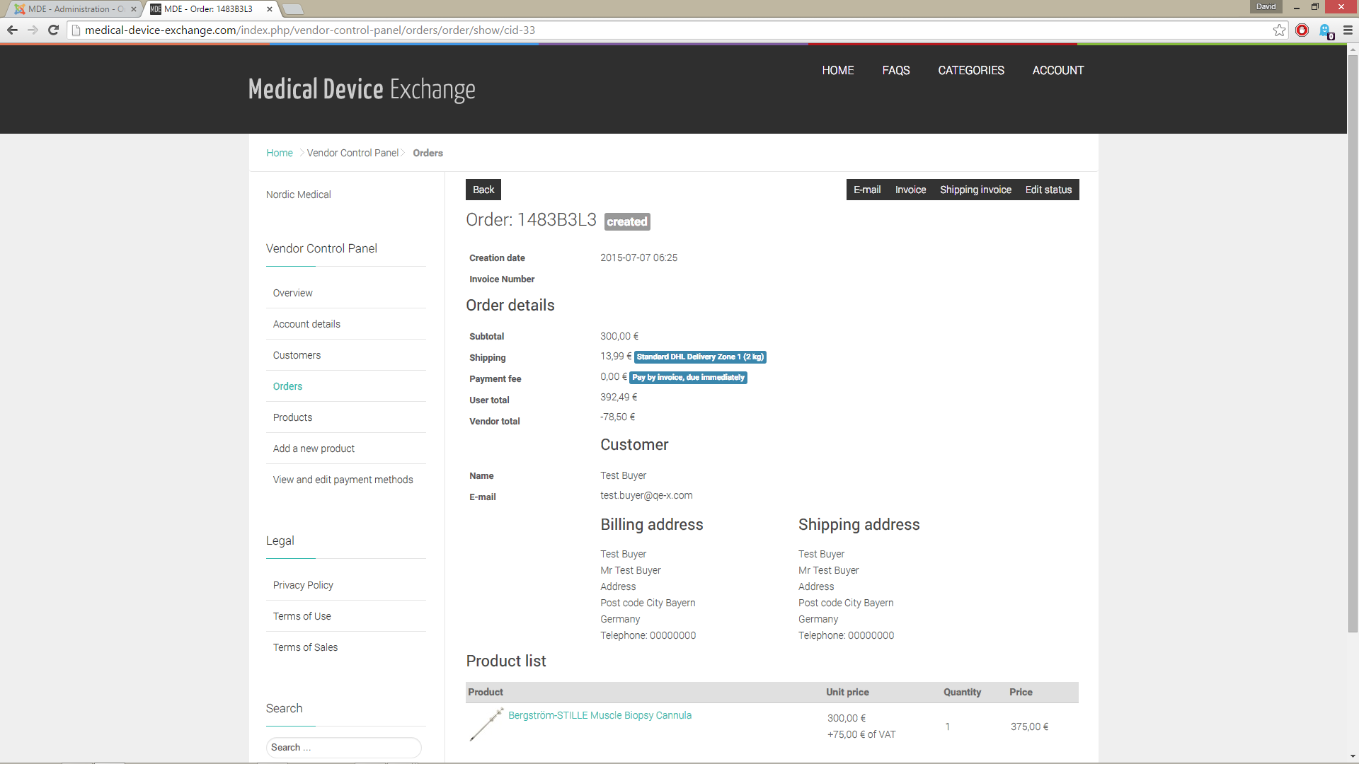

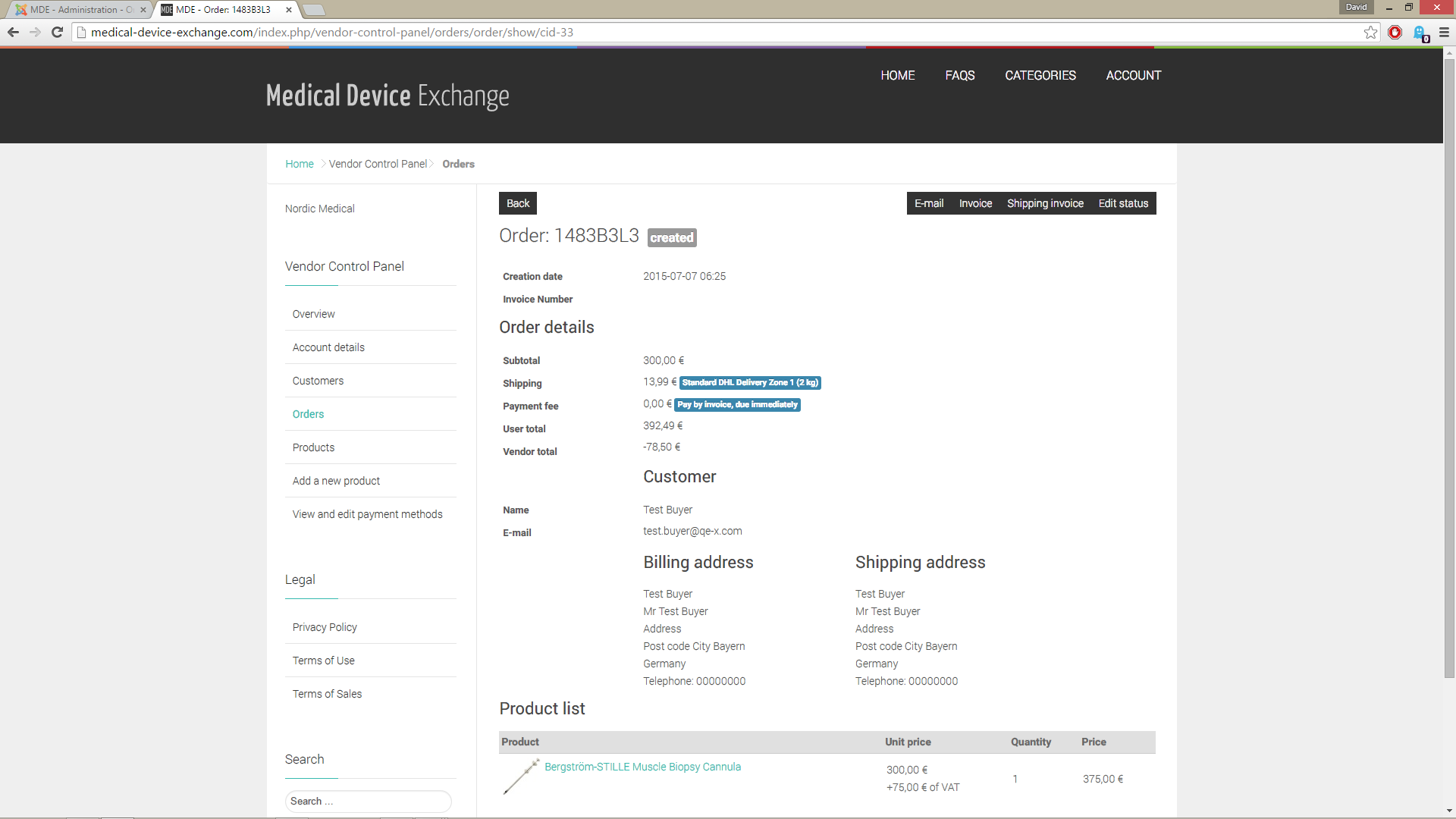

I'm having some struggles with the fee calculations and vendor invoice generation in HikaMarket. The setup is such that only one vendor is allowed in cart, vendor receives all shipping and payment fees, and we get 5% of the order (products only).

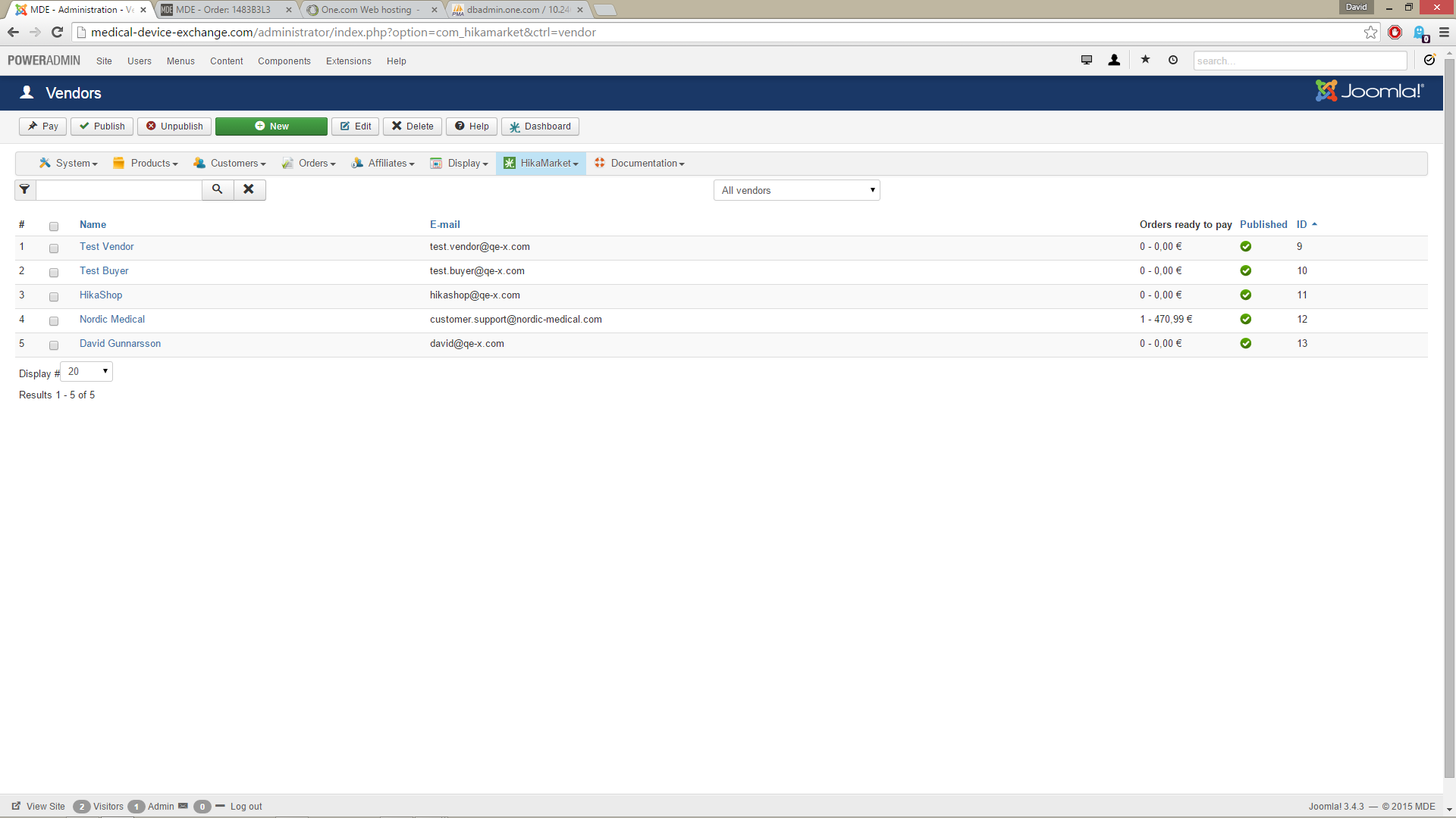

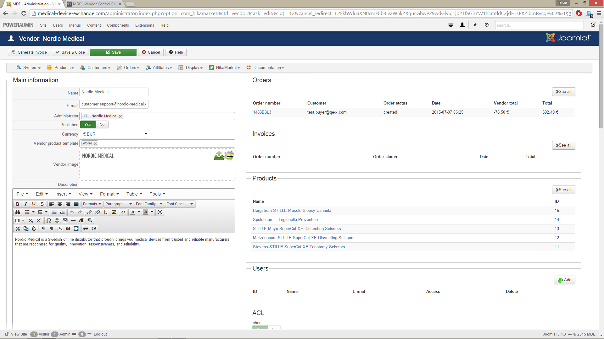

When a 'test buyer' makes a 300 EUR order (300 products + 13,99 shipping + 78,50 taxes = 392,49), correct e-mail confirmations are sent to all parties (administrator, vendor, and buyer). The back- and front-end order summaries show, however a 'vendor total' value equivalent to 20% (78,50 EUR) of the total order. Am I correct in assuming that this is actually 'vendor total tax' value? Or is this the 'vendor fee', but incorrectly calculated? The other thing is that when looking at order summaries or vendor listing, the total value of the order doesn't add up - it seems to add the 'vendor total' value of 78,50 to the total order value of 392,49 = 470,99.

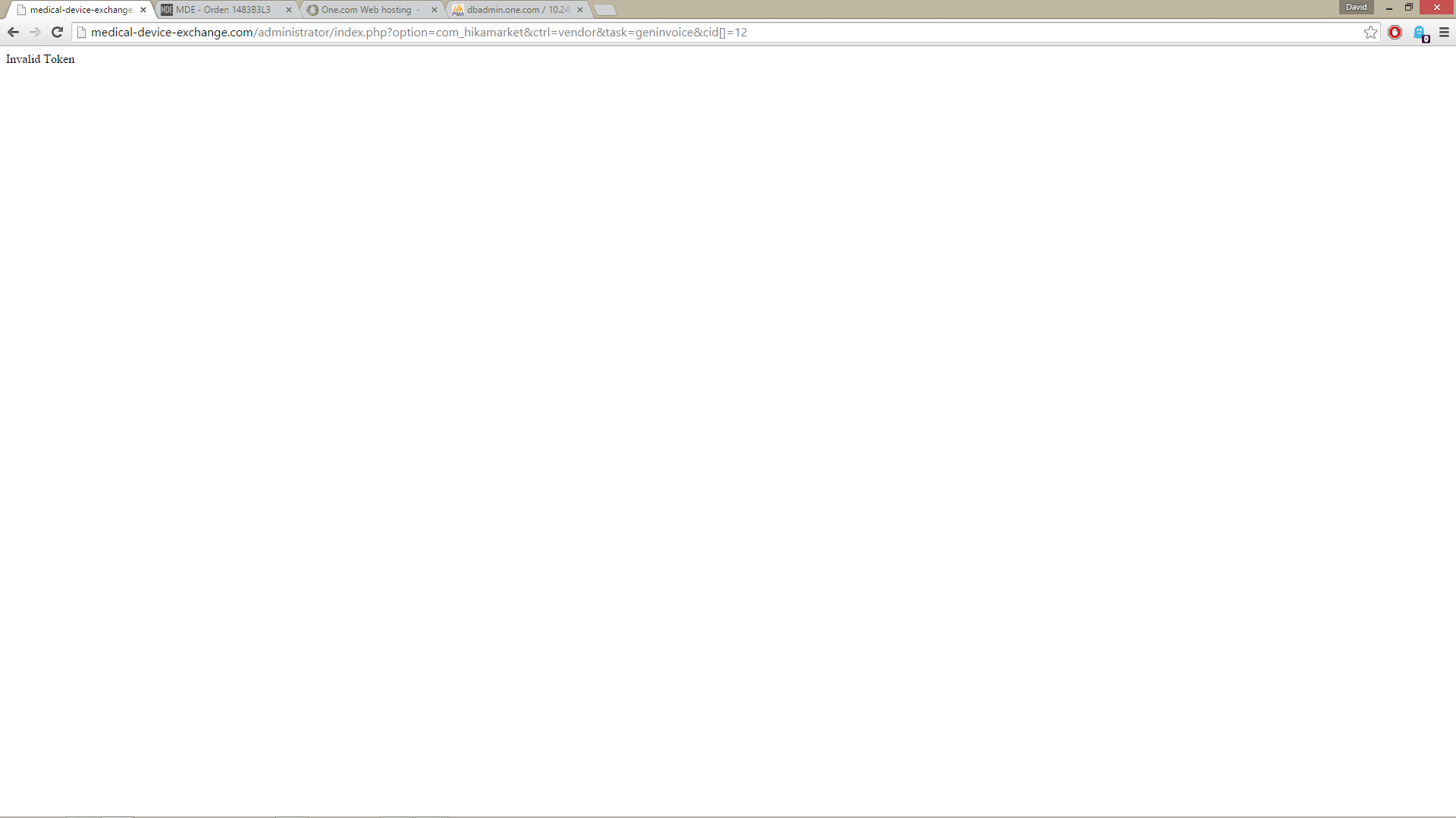

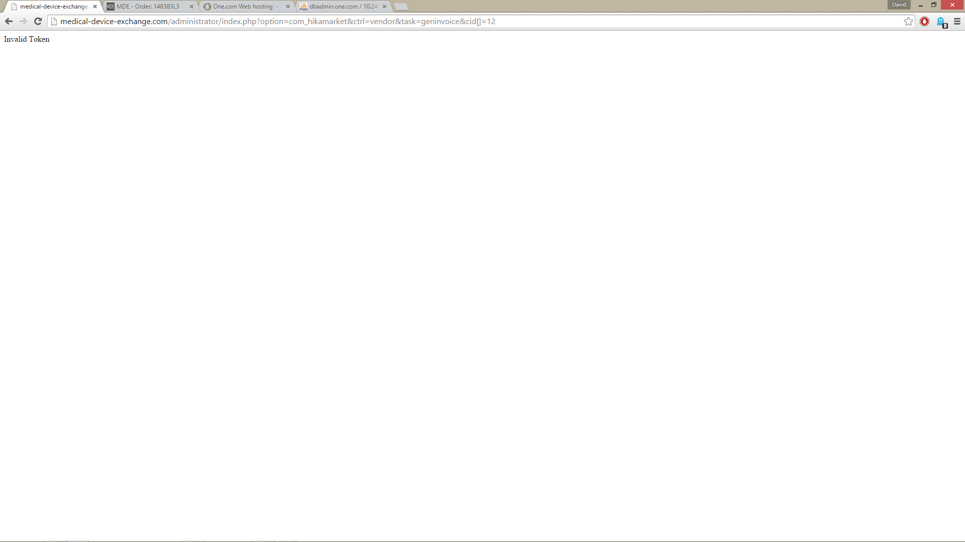

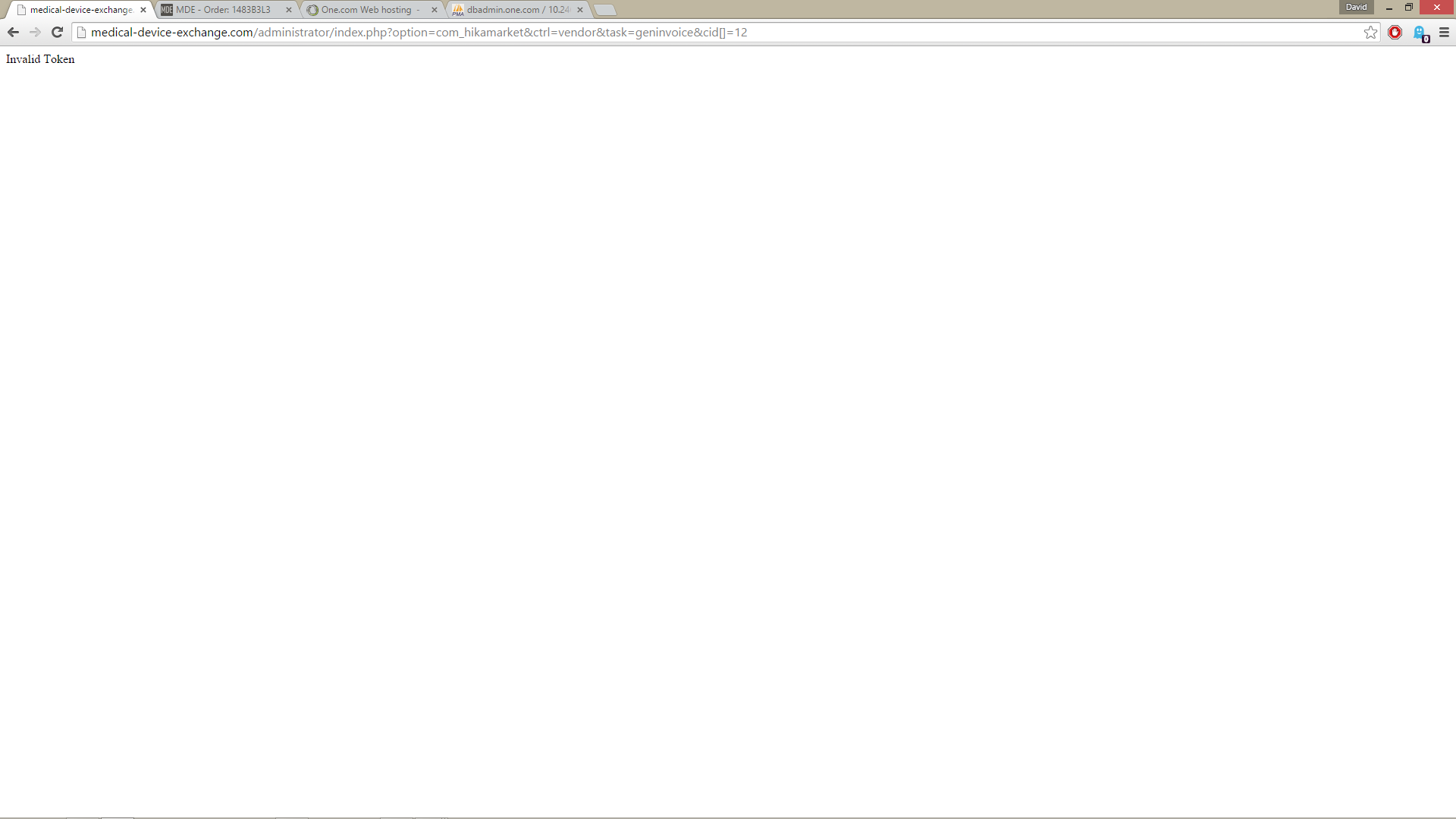

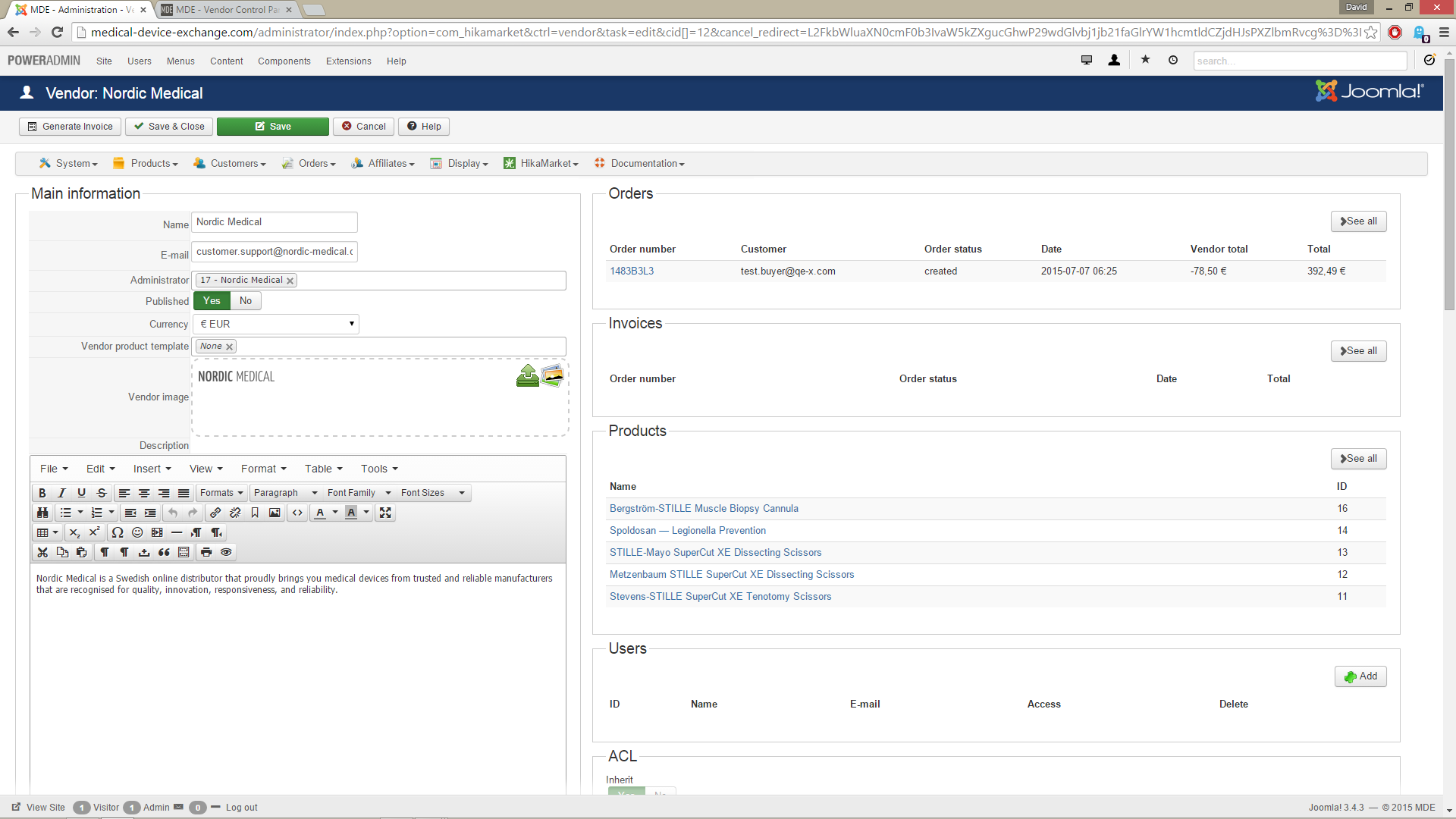

Once the vendor has confirmed (or paid and shipped) the order in the front-end, I tried to generate an invoice for the 5% fee that the vendor is supposed to pay. I got an error message saying 'invalid token'. Any idea why this is?

Because you have the button "generate invoice", it means that you are in market mode "vendor paid directly".
The value display by HikaMarket in that mode is the total that the vendor earn you, the money he have to pay you back for the order is has been paid (directly).
You have 20% for your vendor and your taxes are 20%. So that's logical that it is the same value.
But the taxes are added to the order while the fee is just a part of the order.
So about your calculation issue ; for what I see there is no issue.
But there is an issue with the button "generate invoice" which ask for a token and it looks like the token is not sent properly by the button.
I just open a ticket for that bug ; I'll update this thread as soon as possible with a fix.

But that is not correct. The value I have set up in HikaMarket configuration > Your vendor is a 5% fee, not 20%. I've tested changing the fee percentage to 0% and to 50% - but it still displays the same 'vendor total' amount. So, what am I missing?

If you change the configuration after the creation of the order ; the fees won't be modify.
The processing is made when the order is created, with the current configuration.
At that fee configuration is read from the product, from the vendor and from the global configuration.
www.hikashop.com/support/documentation/259-hikamarket-fees.html
Without more details about your entire configuration and about the order ; it will be difficult to give you a more precise answer.

So, your configuration :
- Vendor paid directly
- Vendor price with tax : NO
- Apply fees on shipping : NO
- Shipping per vendor : YES
- Fee : 5%
One sample order :
* 1 product - 40€ + 10€ of tax
* shipping - 17.49€ (inc 3.49 of tax)
* total 67.49 (40+10+17.49)
You can see in the HikaMarket order that the vendor price for the product is 38€
It is the product price without tax minus the 5% fees (40€ * 0.05 = 2€)
So the vendor should give you that 2€ ; which are your fess for the transaction.
Now the returned price is currently the "shipping price minus the fees" (17.49€ - 2€ = 15.49€).
The "vendor paid directly" mode does not check the setting "shipping per vendor" ; it is something I will fix.
I need to perform further test but for the moment you should replace the two references :
	if(!$feeMode)
		$v_order->order_vendor_price = $v_order->order_vendor_price - $order->order_full_price;
By
	if(!$feeMode) {
		if($config->get('shipping_per_vendor', 1))
			$v_order->order_vendor_price = $v_order->order_vendor_price - $order->order_full_price - (float)$v_order->order_shipping_price;
		else
in the file "administrator/components/com_hikamarket/classes/order.php".
There is two or three other modifications for the other way than the vendor price is recalculate.
Now regarding your first message where I can't understand your number ; the best is to explain what you want so I could tell you what you have to configure.

I'm getting the 'invalid token' error message in creating vendor invoices.
Yes, like I told you in my very first answer, I'm working on it and that's another issue...

10 years 11 months ago #207740
So, in the file "administrator/components/com_hikamarket/controllers/vendor.php", you have to replace
'display' => array('display', 'show', 'cancel', 'listing', 'admin', 'products', 'invoices', 'pay', 'paymanual', 'geninvoice', 'selection', 'useselection', 'getprice', 'searchfields', 'getvalues'),
By
'display' => array('display', 'show', 'cancel', 'listing', 'admin', 'products', 'invoices', 'pay', 'paymanual', 'geninvoice', 'dogeninvoice', 'selection', 'useselection', 'getprice', 'searchfields', 'getvalues'),
And also
	public function geninvoice() {
		return self::dopay();
By
		return self::pay();
	public function dogeninvoice() {
Then in the file "administrator/components/com_hikamarket/views/vendormarket/view.html.php" you have to replace
'task' => 'geninvoice'
By
'task' => 'dogeninvoice'
And it would fix the issue with the invalid token.
