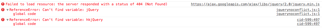

Following your advice I get this warnings in the Safari Inspector-->Console
  • Posts: 26381
10 years 11 months ago #212769
I don't know what you're using for the jQuery inclusion (jquery easy ? your template ?) but the link is, as you can see, wrong.
The folder "2.0" doesn't exist in googleapis ; but "2.0.0" or "2.0.1" does.
So your issue is not related with modsecurity.
But the lack of jquery in your website is the source of your problem (and you might have other errors).
