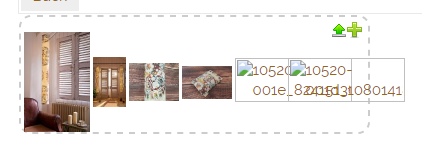

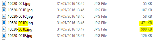

Is there a "file size" limit setting for the images somewhere in Hikashop? :unsure:
The reason I ask if that a vendor using Hikamarket uploads a number of images for a product, and one of them happens to be a larger file size (expecting it will be resized) of approx greater than 300mb, then the image thumbnail doesn't load and NO images appear at all on the product listing! Remove the thumbnail of the larger file from the product, and images start to appear again on the front end.
See attachments.
Where can I control the file size or am I doing something wrong? The expectation is that the images will be resized to the two sizes specified in configuration > images, regardless of the incoming file size.
Thx, Darrell

  • Posts: 112
9 years 11 months ago #250108
Figured this one.
Although we could open the image to view it, we couldn't open it in photoshop. It was corrupt.
This was causing the upload to fail.
Thx, Darrell
p.s. when this happens, it does stop all the images from that product from showing.

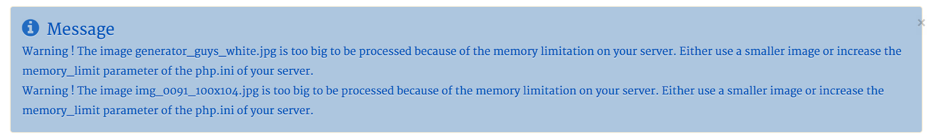

We may have a similar issue with HikaMarket. We're getting an error on the frontend. See attachment.
The images mentioned in the error are actually small and the memory limit set in PHP is more than adequate to resize them - 128M. One image in particular is only 100px x 104px and only needs to be sized down to 100px x 100px.

  • Posts: 211
  • Thank you received: 14
9 years 10 months ago #251463
Also, I should mention ... the error only displays on vendor detail pages. The same images resize just fine on the vendor listing page and on product pages.
Fine - igenerac.com/shop/shop-installers
Fine - igenerac.com/shop-installer-products/pro...ervice-within-1-hour
Error - igenerac.com/shop/shop-installers/vendor...7-the-generator-guys
The images in the error include the vendor's logo and the default Hikashop product image. I'm not sure why the default product image would be trying to load on the page with the error because the vendor's products have their own custom images.

  • Posts: 26381
9 years 10 months ago #251464
Can you please check the image "generator_guys_white.jpg" which should be the vendor image ?
HikaMarket is using the HikaShop image helper to generate the thumbnail and there are some checks in that helper in order to avoid the memory limit issue ; the helper determine the required memory to handle the file and if there is not enough memory to handle it, it displays the warning instead of causing a PHP fatal error.

  • Posts: 26381
9 years 10 months ago #251705
The original image is (the link you gave was already a thumbnail) :
igenerac.com/media/com_hikashop/upload/t...rator_guys_white.jpg
The point that I don't understand why you have that issue.
Like I wrote ; there is nothing related to HIkaMarket (even if you are in the vendor page) but it is related to the HikaShop Image Helper.
In that file you will find a line
$estimation = (($origin->width * $origin->height) + ($e_x * $e_y)) * 8;
And if you replace the line just below
$app->enqueueMessage(JText::sprintf('WARNING_IMAGE_TOO_BIG_FOR_MEMORY', $filename));
By
$app->enqueueMessage(JText::sprintf('WARNING_IMAGE_TOO_BIG_FOR_MEMORY', $filename) . ' [' . $estimation . ' / ' . $rest . ']');
It should display the memory estimation and the free memory.
Using that information you should have more elements to understand why this message is displayed.

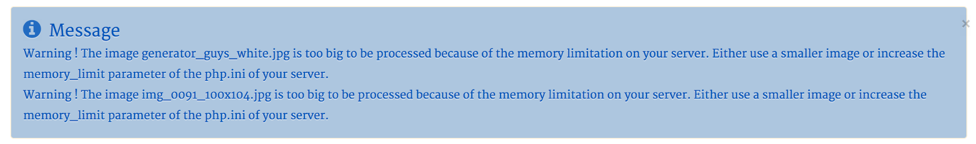

  • Posts: 211
9 years 10 months ago #251785
This is the message I get. It makes no sense for that amount of memory to resize such a small image, and the same images are being resized just fine on the vendors listing page and many more other images are also being resized on that page.
Warning ! The image generator_guys_white.jpg is too big to be processed because of the memory limitation on your server. Either use a smaller image or increase the memory_limit parameter of the php.ini of your server. [2344481808 / 127910056]
Warning ! The image img_0091_100x104.jpg is too big to be processed because of the memory limitation on your server. Either use a smaller image or increase the memory_limit parameter of the php.ini of your server. [769126288 / 127908648]
I've commented out the message altogether for now so its not shown to visitors.

  • Posts: 211
9 years 10 months ago #251787
It looks like the problem is the size HikaMarket is trying to scale the images up to ...
Warning ! The image generator_guys_white.jpg is too big to be processed because of the memory limitation on your server. Either use a smaller image or increase the memory_limit parameter of the php.ini of your server. [2344481808 / 127910072 / Original Width:381/ Original Height:130/ Resize Scale: 29304x9999]

  • Posts: 211
9 years 10 months ago #251789
Interesting. It appears this was caused by the vendor image sizes being blank in the HikaMarket config. So, if those fields are blank, the default image size on the vendor page is apparently 29304 x 9999, however, the images on the vendors listing page do not go by the vendor image sizes in the HikaMarket config.

  • Posts: 26381
9 years 10 months ago #251792
Just to be sure ; what are your parameters for the HikaMarket vendor image (width, height, force size) ?
And what are your image settings for HikaShop ?
The default value for the vendor image size can read the HikaShop product image size if empty.
And if you force the size with a very height value.. It is logical that it will require a high quantity of memory.
  • Posts: 211
9 years 10 months ago #252088
HikaMarket - Width 150px Height 150px and "No" to "force size". The dimensions were blank when I was getting the error message.
HikaShop - 100 x 100
