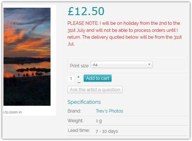

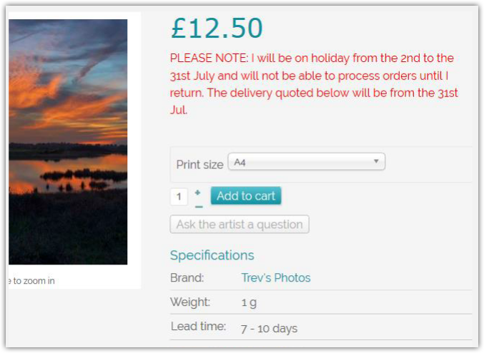

I have written a plugin which allows the vendor to set a holiday start and end date and a holiday message. The message is displayed on all the vendors products if the date falls between the start and end date and the message is enabled. An example message might be:
"PLEASE NOTE: I will be on holiday from the 2nd to the 31st July and will not be able to process orders until I return. The delivery quoted below will be from the 31st Jul."
The plugin settings allow the main vendor to be notified when a vendor has set a holiday message.

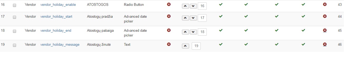

Could you please take a look what I'm doing wrong.

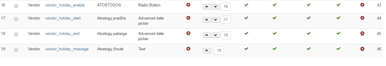

i installed your plugin, enabled it. Created custom fields according your post (attached image). But it shows as regular custom fields on vendor page and no holiday message on product page.
thank you in advance
Last edit: 7 years 10 months ago by SEKME.

7 years 10 months ago #296567
Edit the custom fields setting to not let these fields visible in the front-end but let them editable by the vendor in their profile.
The following user(s) said Thank You: SEKME

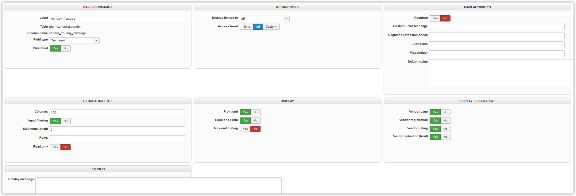

7 years 10 months ago #296587
Sorry, been away and just got your messages.

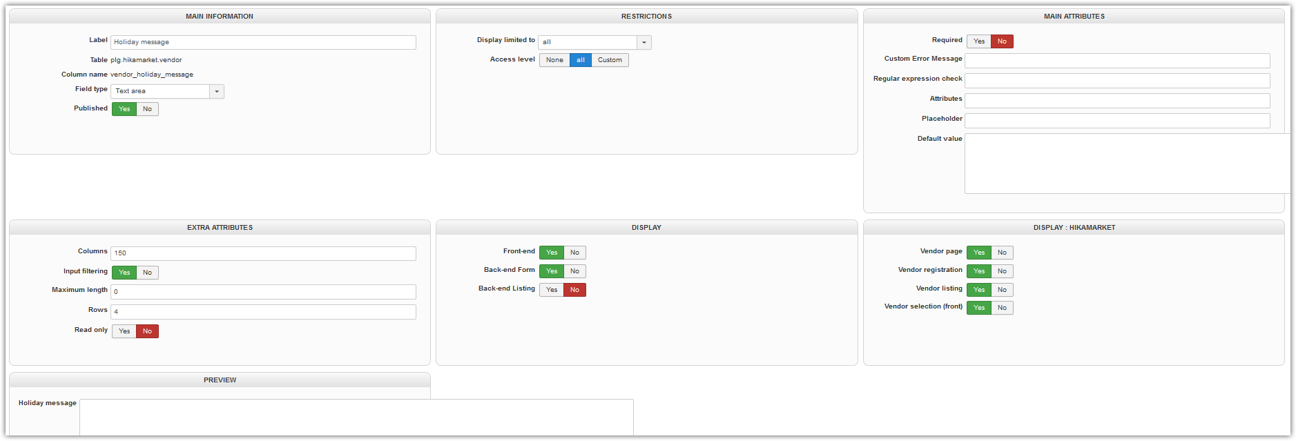

Here are the settings for the holiday_message field, the other fields are similar.
The following user(s) said Thank You: Jerome, OA

Trevor thank you so much for screenshot....my all configure was same, except that I chosed TEXT, instead of TEXT AREA ...and vuola all working :)

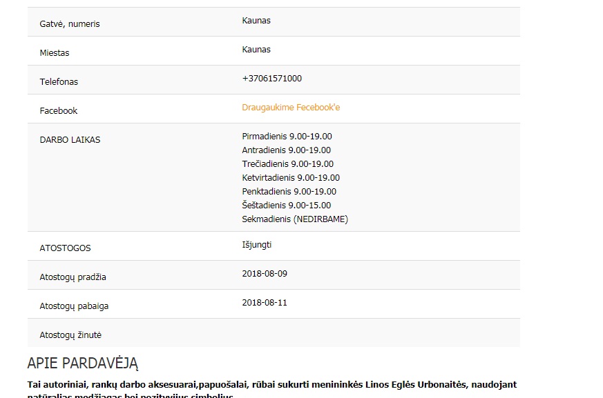

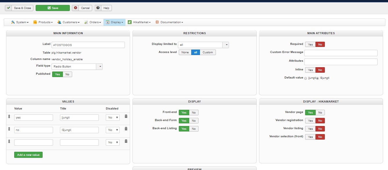

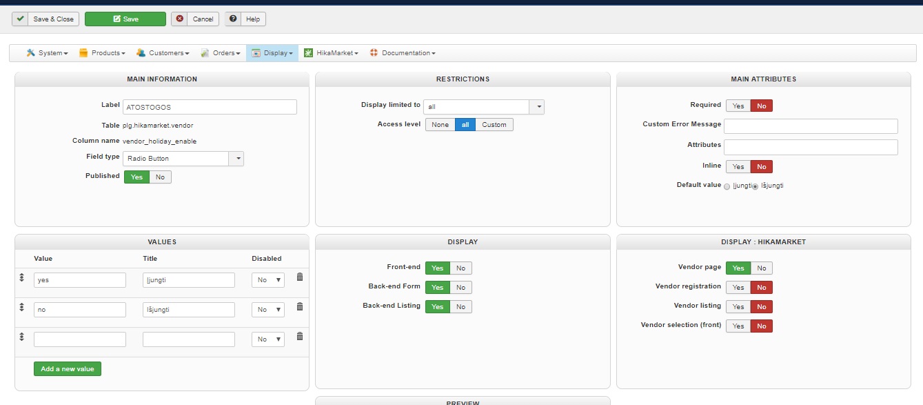

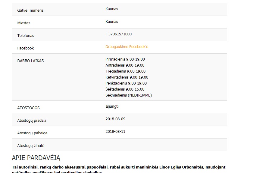

I testing this plugin... and find out, that if vendor in front end turn of the holiday mode (radio button), but still all earlier entered dates and holiday message appear in vendors page (not ion product page). I attach how radio butoon custom field I configurated.

Sorry, but how to do that? If I turn off show in front-end, the custom field do not appear in vendors profile, where he should make changes....
And one more question about custom fields - how to do, that if field value do not filled with information (left empty) by vendor, that this custom field do not appear in front end vendors page at all (no label as well)?
Thank you

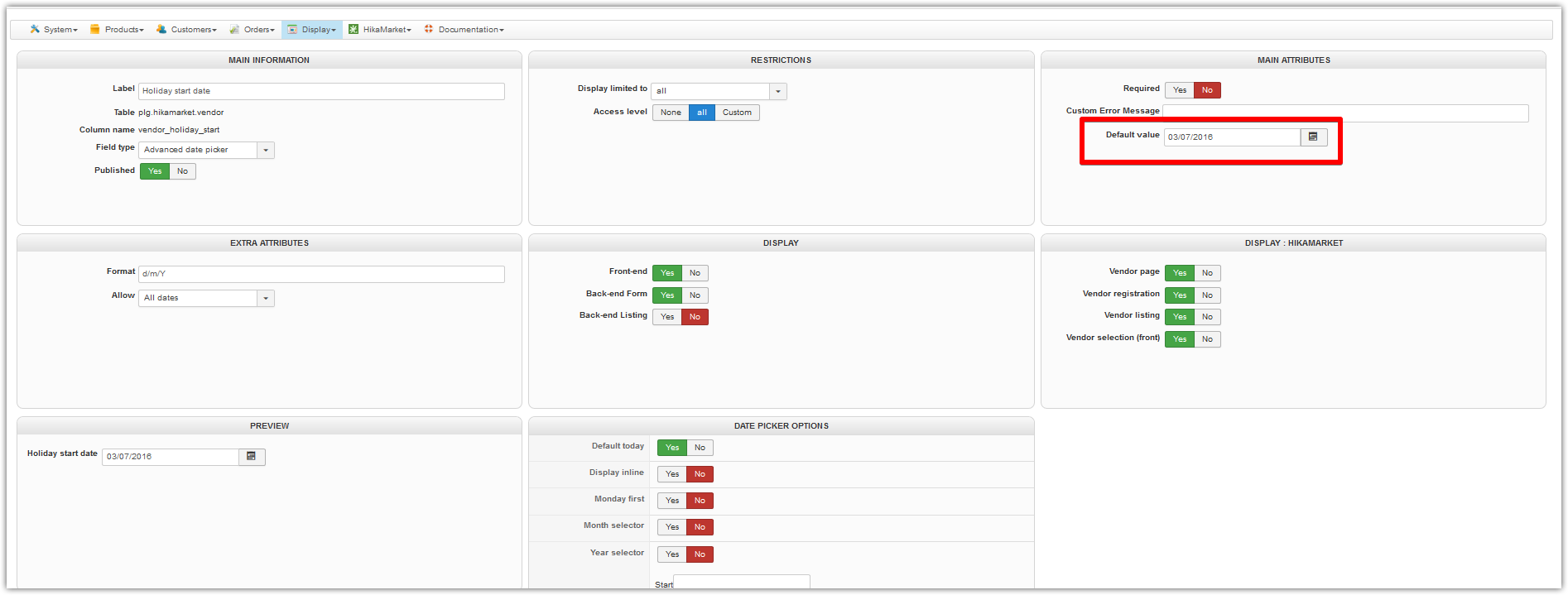

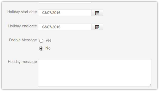

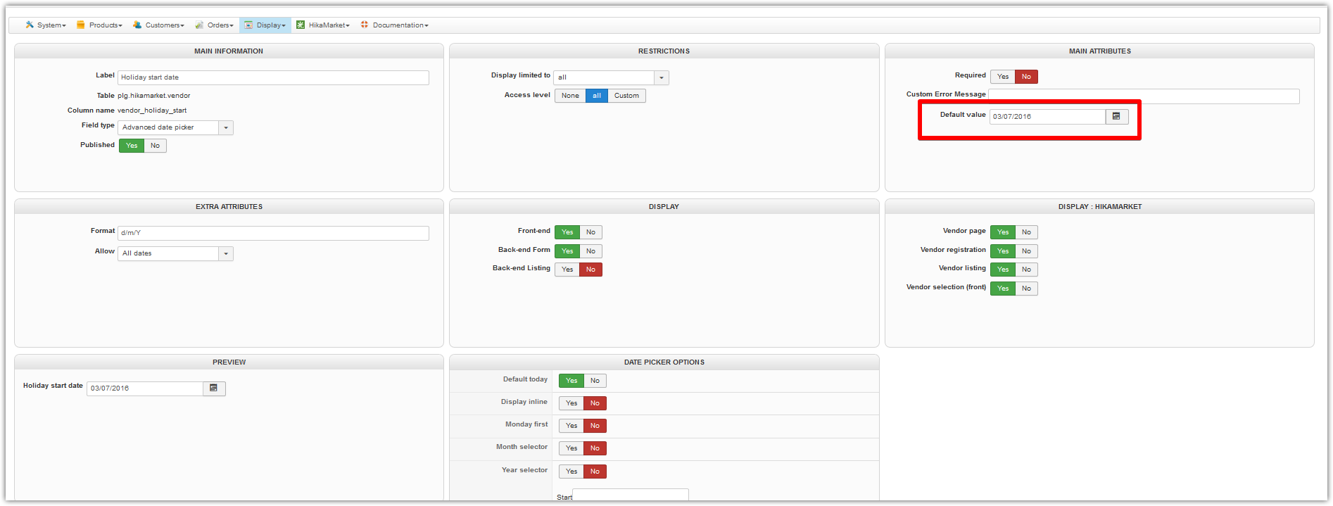

I set a default value for the date fields to prevent the empty field problem. Here are my settings for the vendor_holiday_start field
regards
Trevor

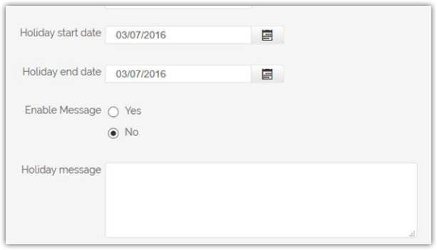

Sorry for late replay, was out for long weekend. Thank you for your replay. I was set the default date value as you show. The concern is that the command turn on/off the holiday is not working as I expected. I thought that if I swich the OFF (disable holiday mode -> radio button = vendor_holiday_enable) the custom fields should be hidden on vendor page as well as it happens on product page. On product page the holiday message disapear when holiday enable custom field is OFF. But all custom fields related to holiday mode is still on vendors page - and it should be hidden as well , dont they?

OK I see what you mean. I never used the vendor page so it wasn't a problem for me.
When I get time I will se if I can find a solution but I think it might mean customising the view. In the mean time you could remove the holiday fields from the vendor page altogether in the 'custom fields' settings by setting 'Vendor page' to 'No' in the 'Display::Hikamarket' panel:

Thank you Trevor, I did as you offered , turn off Display::Hikamarket -> Vendor page. It is quite good solution. I even see, that it would be enough, that if holiday message (or other custom field ) is empty= do not display this field at all.
