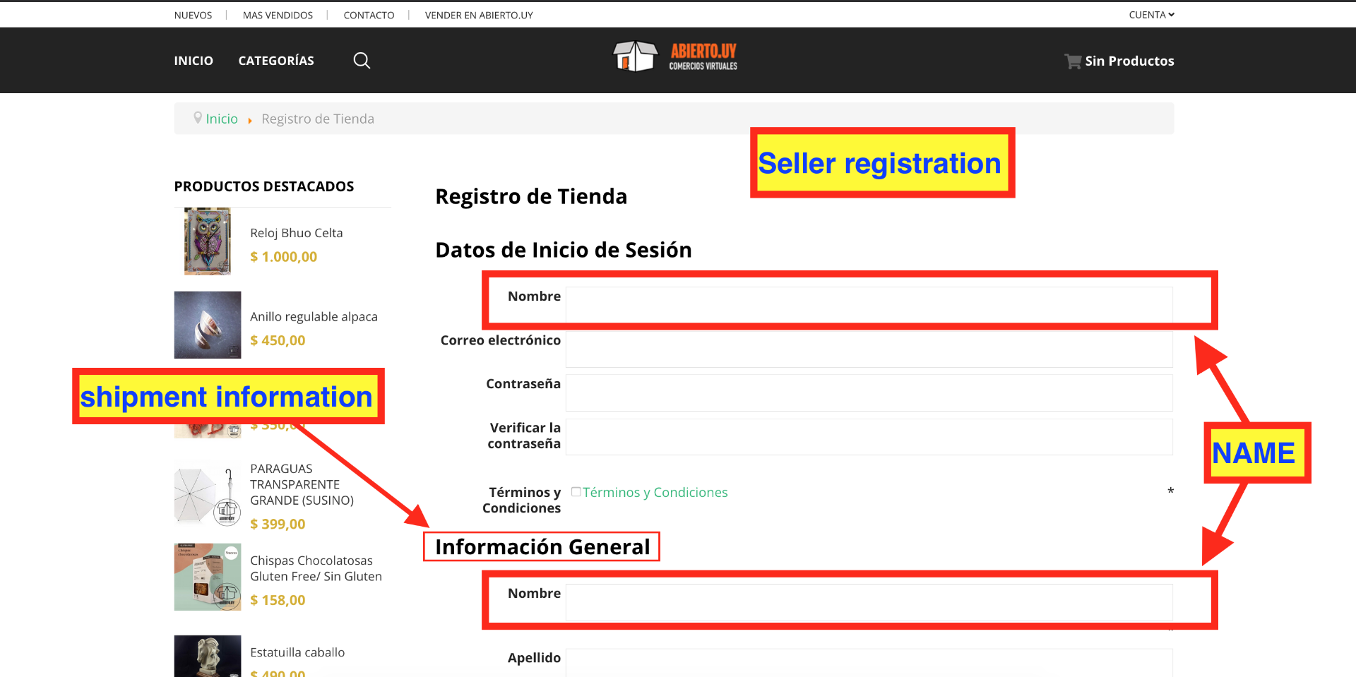

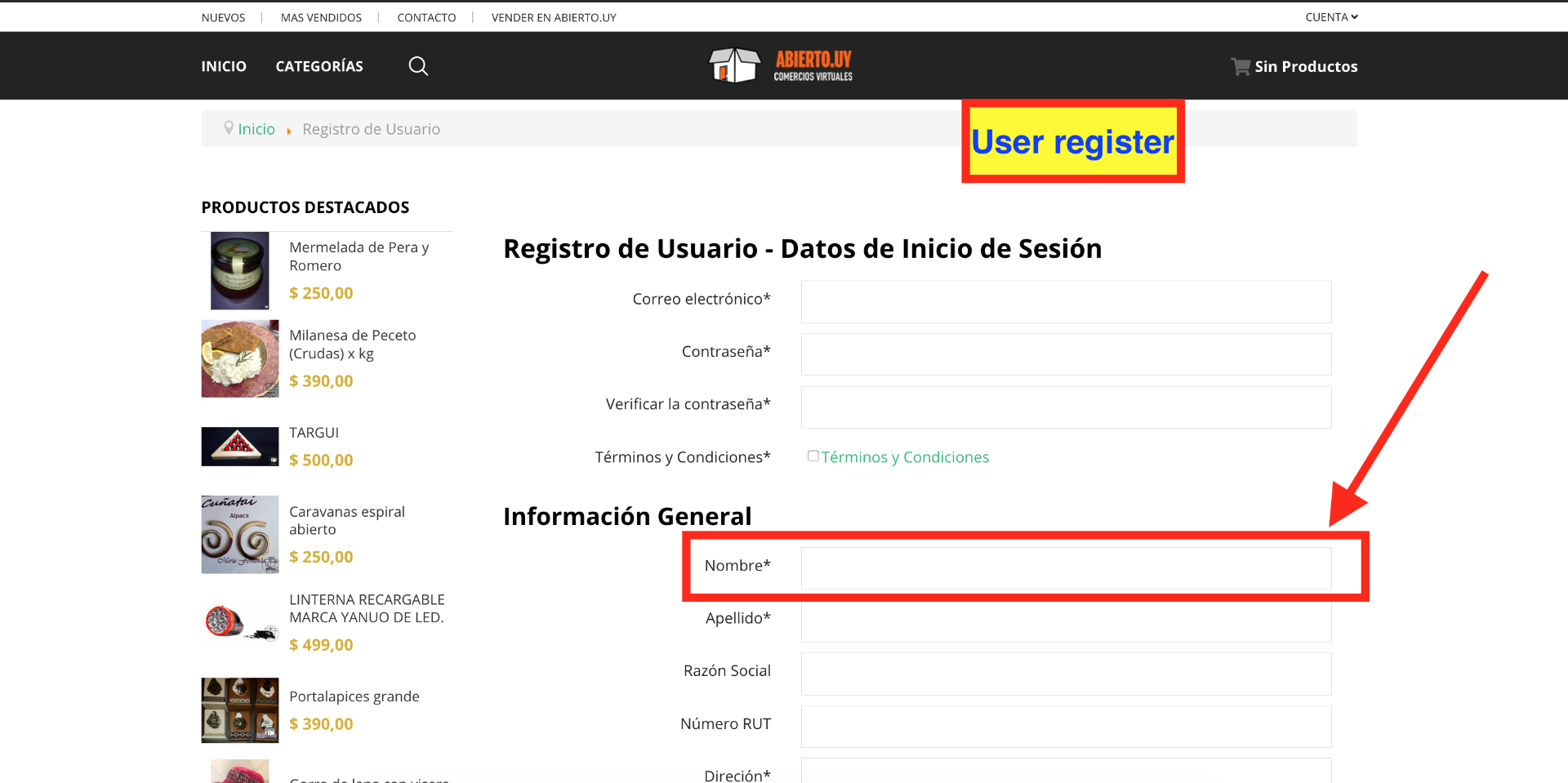

Hello
In the Hikamarket settings, I defined the user registration as Simplified registration with password.
When the user wants to register, the fields for registration are: email, password and password verification, fine.
Now, when a seller is going to register, the fields for registration are: name, username, email, password and password verification, where, the name is also requested in the fields of the shipping address, so, name field is duplicated and it is not a good experience for the user to have to enter the same field twice.
Maintaining the registry settings as Simplified registration with password, is there a way that the same fields are requested in the seller registry as in the user registration, email, password and password verification?
Thank you

But that does not change my query, I need that both records request the same data and that there are no repeated fields in the record, as it happens with the Name field. It is the same for me if the requested information is username, email, password or if the requested fields are email, password. The important thing is that fields are not repeated and that both records are the same, that there is consistency.
It's possible?
Greetings, thank you !

But the problem is not the username field, the problem is the name field, which is requested twice in the seller registration form. As I commented in previous messages, Entering the same data twice is not a good user experience.
Greetings thank you !

You are not understanding me, I as a developer and computer technician can see the difference between both fields, but, even if you do not believe it, users are confused that in a form they are asked twice for the name in the same data, the Users I refer to are not engineers or computer scientists, they are ordinary people, entrepreneurs from various sectors who are not computer experts, nor do they have digital thinking and I must provide them with the best user experience so that they can use the site.
In addition to that great reason, what I am asking you, is if you can give me a solution so that in the seller registration form, in the login data section the name is not requested, because beyond that for you, the difference between both fields is very obvious, the common user only sees that the form asks twice for the name. So I ask, if in the user registration form the name can be requested only once, why in the seller form cannot it be done in the same way? Could you see the screenshots I attached to the tickets?
  • Posts: 26381
6 years 3 months ago #319076
Then you can override the HikaMarket registration page and remove the vendor name field.
  • Posts: 127
6 years 3 months ago #319180
Perfect, removing the field from view, I was able to solve my problem
