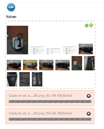

When uploading pictures with any method (drag or window select) with last version 1.4.4 it is not working. The upload process fails and a blank dialog box pops up.
I overrided the file with the 1.1.3 and I got back the possibility for upload although the Popup windows are still popping.
At a certain point I got this message:
Fatal error: Call to a member function display() on a non-object in /home/acticar/public_html/components/com_hikamarket/views/productmarket/tmpl/form_image_entry.php on line 15
Tested in both a local and an online site.
THE PROBLEM HAPPENS ALSO FOR FILE Loading, so maybe the problem is some common library. I have maximum error reporting activated but only got the message above in my testing.

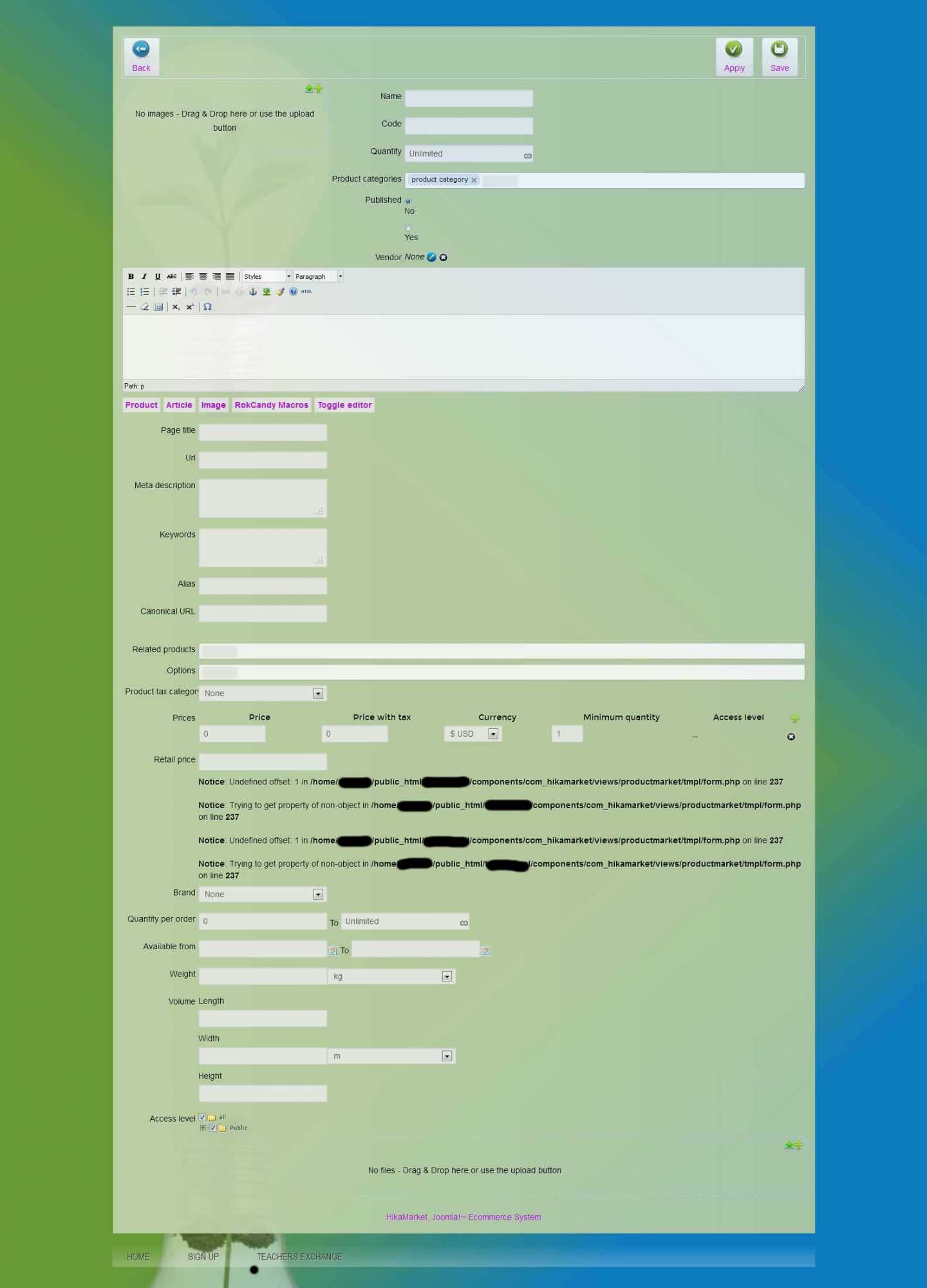

Still receiving the error "components/com_hikamarket/views/productmarket/tmpl/form.php on line 237" on the page if that helps at all
  • Posts: 26384
13 years 2 months ago #111098
Not really.
I don't see the link between the upload and the view "form".
After that, in the HikaMarket 1.1.4, the line 237 of that view is for displaying the MSRP price.
If you have an error here, you shouldn't see the product page edition at all.
Which versions of HikaShop and HikaMarket are you using ?
Could you give me more information about the error and the line in this view ?

I have attached a jpg image of the error.
Last edit: 13 years 2 months ago by xsbucks.
  • Posts: 26384
13 years 2 months ago #111252
There is no link between the upload and the retail price.
The notices you see is because the default currency is not published.
Just after the "retrail price" input box, you should see the currency name and currency code. But because there is an error in your HikaShop configuration, HikaMarket can't load the currency.
The upload problem has been fixed.
