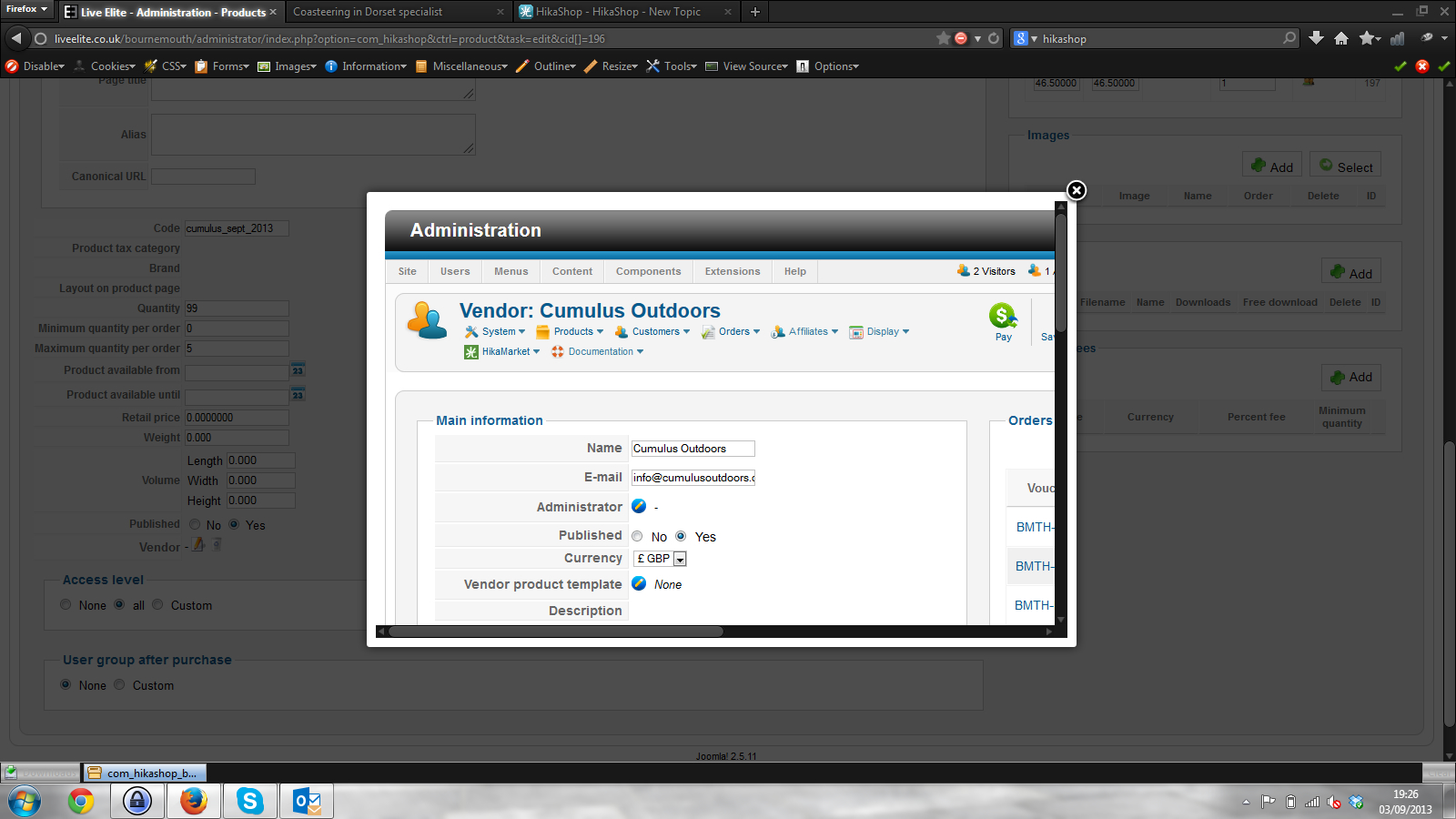

Hi I am unable to select my vendor when editing a product. It is ok with the first page of vendors however when i click to the next page of vendors it changes to an iframe when i click on the vendor name rather than adding that vendor to the product. Please find the screen shot attached.
Alex
  • Posts: 26365
  • Thank you received: 4069
12 years 10 months ago #121809
Right.
Please edit the file "administrator/components/com_hikamarket/views/vendor/tmpl/selection.php" and replace near the end of the file:
<input type="hidden" name="task" value="select" />
By:
<input type="hidden" name="task" value="selection" />
The next HikaMarket package will include this fix.
Thanks for the report.

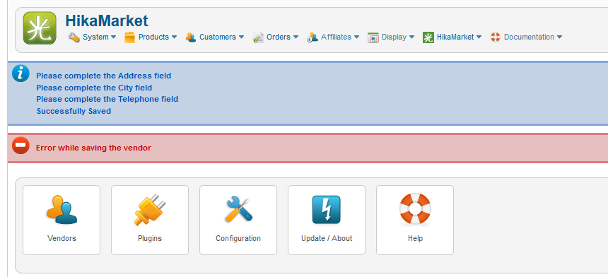

Thanks that was what i was looking for. I have updated this setting and i think it is applied as i click back in and the settings are correct however i get a joomla error message, i do not know if this is of any importance? (attached)
  • Posts: 26365
12 years 10 months ago #121902
You have all explanations in your screenshot.
Please complete the Address Field - a required custom field
Please complete the City Field - another required custom field
Please complete the Telephone Field - once again, a required custom field
Successfully saved - The configuration is saved
Error while saving the vendor - well, there is an error while saving the vendor, because of the required custom field. So the vendor is not saved, but the configured is.
If you have modified the main vendor in your configuration, there some kind of importance because your modification are not saved.
If you just touch to the HikaMarket configuration, well, it is saved so the vendor not saved is not tragic.

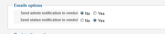

12 years 10 months ago #122679
Hi Jerome,
I have set the email options to the attached and my vendors are reporting they are not getting emails when i am under the impression that they should be, is that correct?
Kind regards
Alex
  • Posts: 26365
12 years 9 months ago #122729
This option allow to send to the vendor the copy of the "order status notification" email which is sent to the user.
So when the user receive this email, the vendor should receive it too (but with his special order data).
If the notification email is unpublished or the user does not receive it, the vendor should no't receive it too.

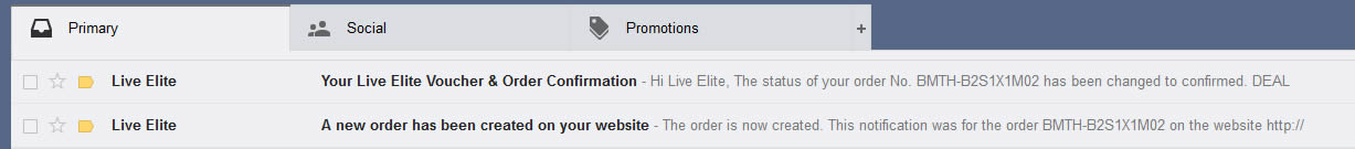

12 years 9 months ago #122733
Hi Jerome,
In my settings the status email in hikashop is published however the vendors say they aren't getting the emails. Is this something you can check for me?
I set myself up with the vendor account This email address is being protected from spambots. You need JavaScript enabled to view it. and then bought something as a customer using This email address is being protected from spambots. You need JavaScript enabled to view it..
I have attached the emails i am getting one as the customer, and one as the vendor ( I have now set both emails to yes for now) but no email for the status as a vendor, when there should be three emails, one as customer and two as vendor...
Kind regards
