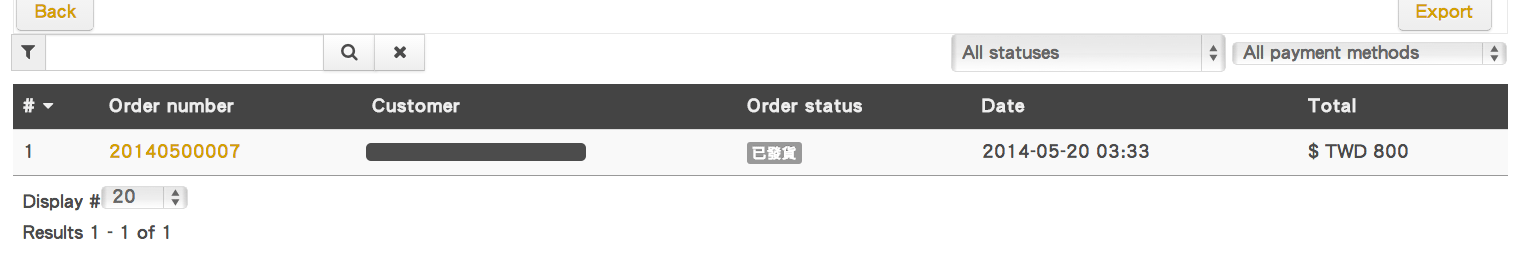

I am currently testing the latest version of both Hikashop Biz and Market, in out UAT environment.

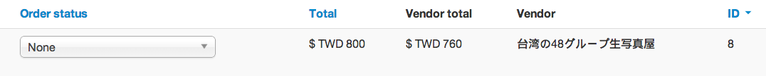

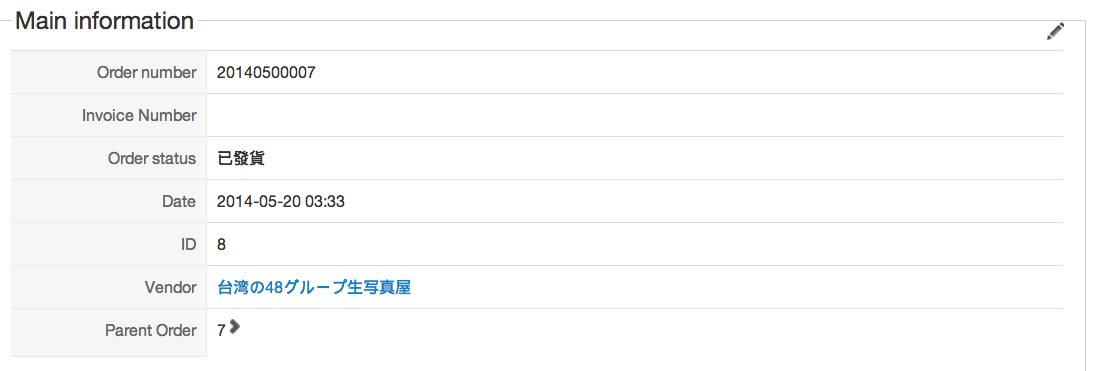

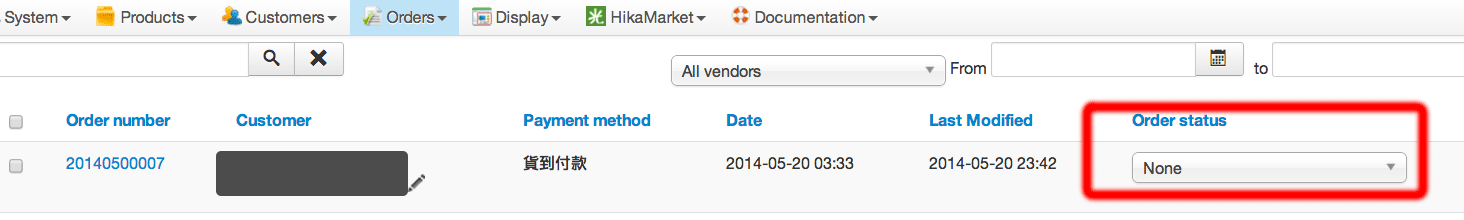

I found an issue not quite sure if it's a bug. Using the vendor account, I've modified the order status to "Shipped" for an order using manual payment collection (eg: COD), with a vendor account. I can see the order are changed successfully from the front-end even the backend. However I still cannot see the order status while try to list via "Orders > Orders", it's defaulted to = none
Note: The Chinese characters (Order Status) of the 1.png = Shipped.
Please advise if I need to re-confirm the status again via backend? or it's a bug. Thanks.
p.s. Please see the screens as attached FYI.

There is only 1 item 1 order, and this issue happened with Vendor order only. Let me explain a bit in details:

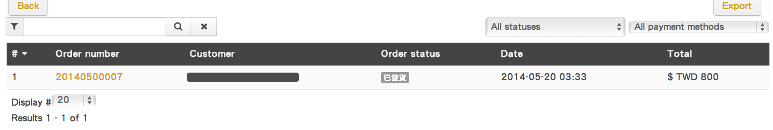

Front-end Vendor account:
- Can see only the order 20140500007 with ID 8
- The vendor changed the order status to "Shipped"
Back-end View:

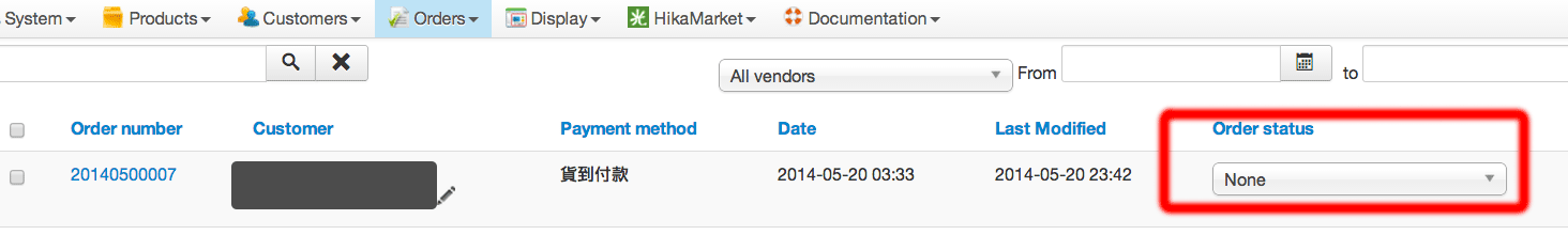

a- List mode, order 20140500007 with ID 8, Order status = None

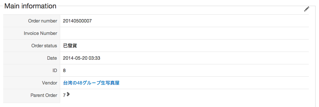

b- Click and view details, order 20140500007 with ID 8, Order status = Shipped

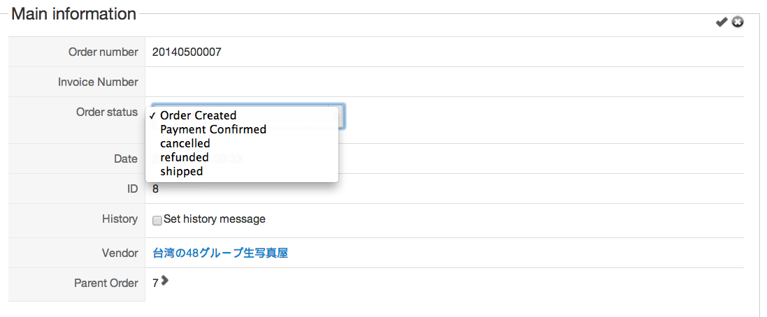

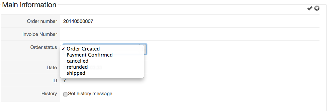

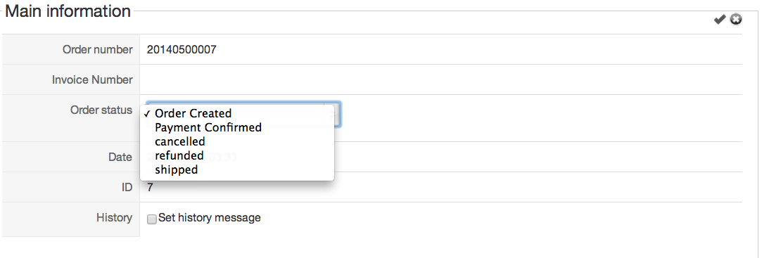

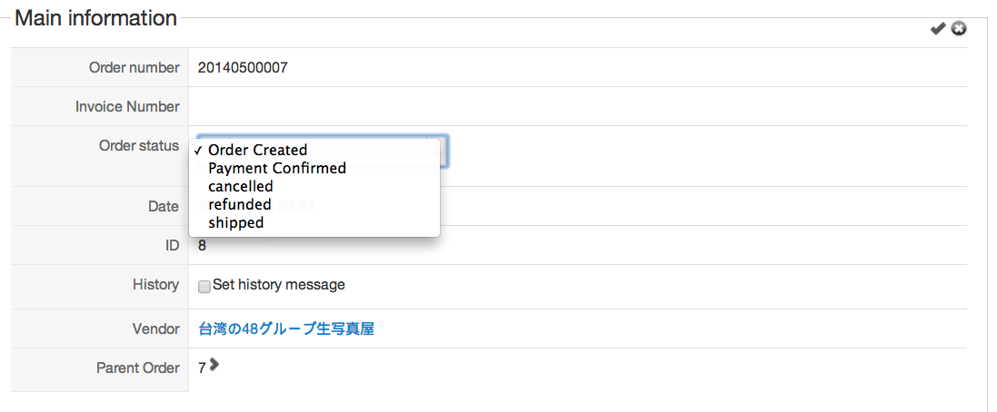

c- When I try to edit the status (in view details mode), the active Order Status = Order Created.
d- Viewing the order 20140500007 with ID 8, enable me to click "Parent ID" > 7
e- The ID:7 order can be viewed only in "No vendor" criteria

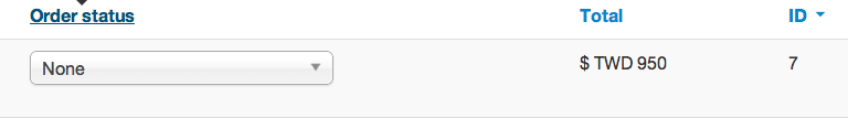

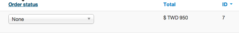

f- List mode, Viewing the order 20140500007 with ID 7 (Parent), Order status = None

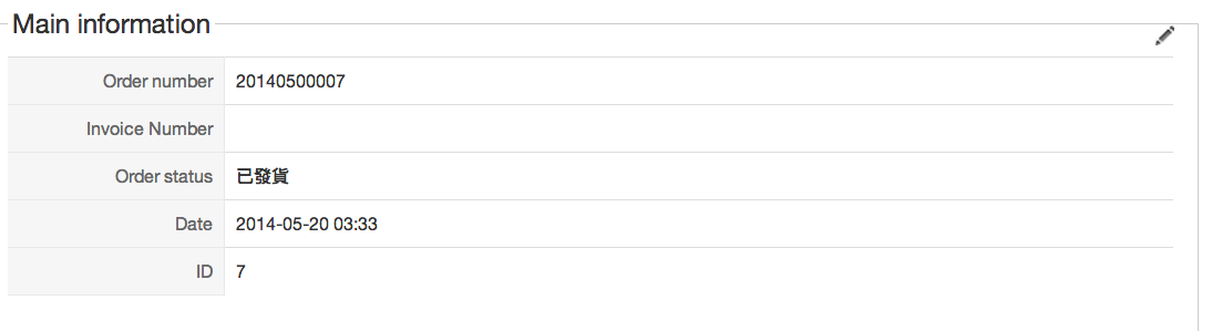

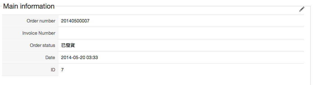

g- Click and view details, order 20140500007 with ID 7, Order status = Shipped
h- When I try to edit the status (in view details mode), the active Order Status = Order Created.
i- Under "HikaMarket orders", I can see the SINGLE order showing "Shipped" as order status.
(Pls find attached pic for your info)
There are few issues / bugs with above scenario, maybe you can try in your environment also.

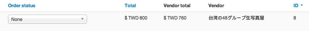

Point a: the sub-order (ID8) still showing Order status = None in list mode, while it's actually showing "Shipped" when view in details.
Point c: when edit the status, it's active status should be "shipped" (as showing), but actually it ticked "order created" in the pull-down menu
point f: the main-order (ID8) still showing Order status = None in list mode, while it's actually showing "Shipped" when view in details.
point g: when edit the status, it's active status should be "shipped" (as showing), but actually it ticked "order created" in the pull-down menu
- Seems the showing value, pull-down active value, and the list mode value of Order Status are not sync, maybe that's the caused of the issue.
p.s. I have translated the display value of order status, and have installed falang using 3 languages together.
Our UAT is currently in an offline environment... (please refer to above points)

I tried to reproduce your problem in my Joomla 3 website, and it worked good.
I checked around the order status values in the drop down, but it looks good.
I guess that the problem is related to falang and the translation of the order status values.
In HikaMarket, we used native language translations for order statuses. It is quite safer for the process.
ORDER_STATUS_CONFIRMED="Payment confirmed"
Can you please remove the overrides in Falang and confirm that the modification of the orders by the vendors is working good ?

12 years 3 months ago #156678
Hi Jerome,
Thanks and confirm removing the "Translated" string from the "Order Status" will have it automatically fixed. (So the fix is not urgent anymore ^_^) Really appreciate your help on this. I guess we can translate the order status string with the language file because we can see it still has zh-TW displaying in local language (but zh-CN not), I guess we can just find the string and fix it soon.
Just a reminder, please do not save any translated string into the database (eg: for CSV export) as this will be a big burden for data integrity and will create data mismatch during data mining. Thanks a lot!
