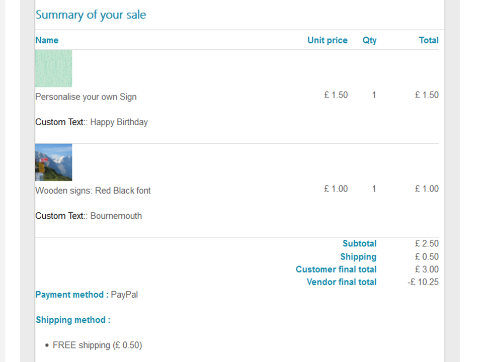

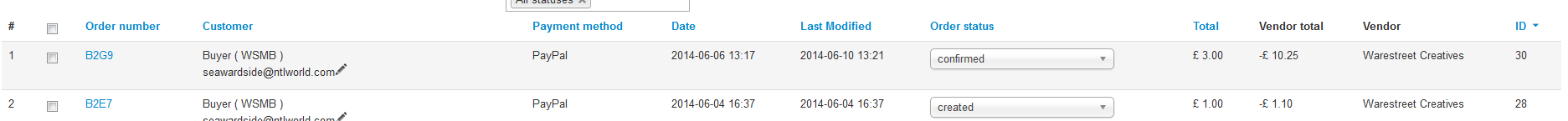

Hi I have created a product, assigned to vendor and given that vendor 10% commission. On the first product (£1) in the order the vendor total is correct - 10% of the total (£0.9). The second product is incorrect. The unit price is £1.50 so the vendor total should be £1.35 however it is showing as -£ 8.65 which seems to be incorrect. Everything else is fine, the correct amount via paypal etc but the backend calculation on the vendor amount is showing up wrong on the order please see attached.
Any ideas what would cause that?

FYI this is how it comes through to the vendor (attached) so is confusing for the vendor also
Kind regards
Alex

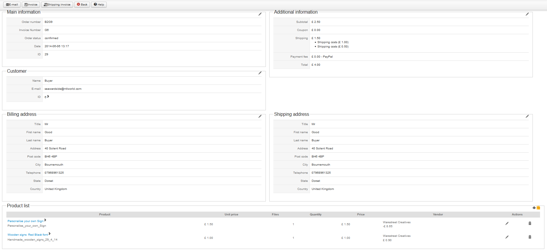

Ok I have attached a larger screen shot to show the shipping prices included, they seem to me to be ok. Please let me know if you need any screen shots of any section.
  • Posts: 26384
12 years 3 months ago #159639
Hi Alex,
It was too weird so I checked your website using the credentials you gave me by email last time.
The product "Personalise your own Sign" (id 14) have a flat fee of 10£ with a percentage fee of 10%.
1.5£ - 10% - 10£
= 1.5$ - 0.15£ - 10£
= -8,65£
So the price given by HikaMarket is right looking at the configuration.
Please remove the fee configuration for this product.

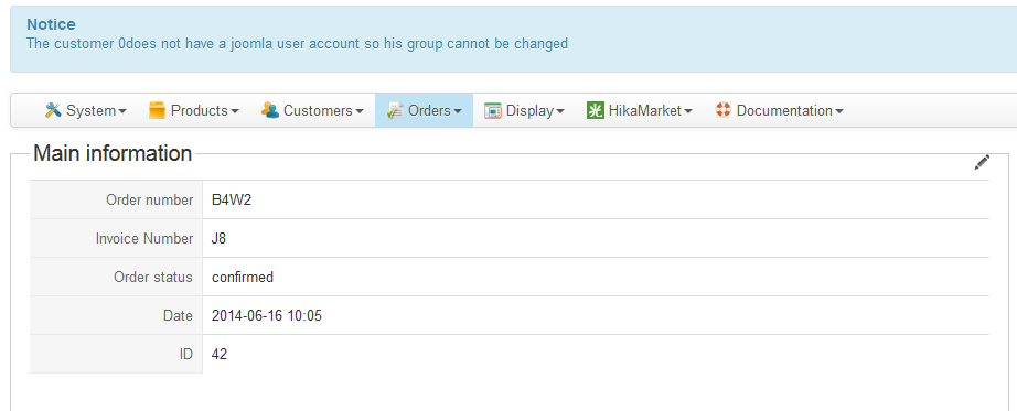

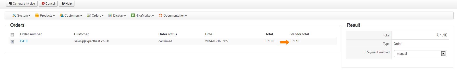

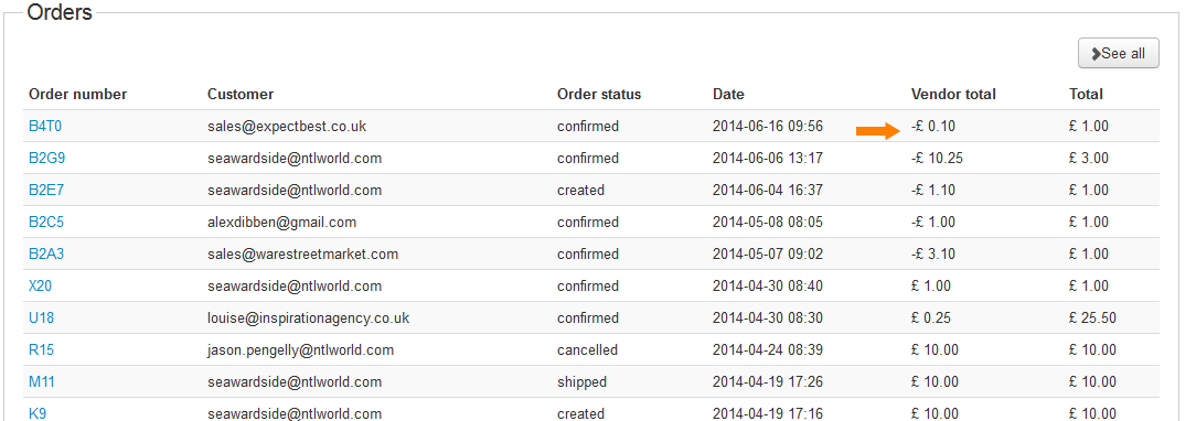

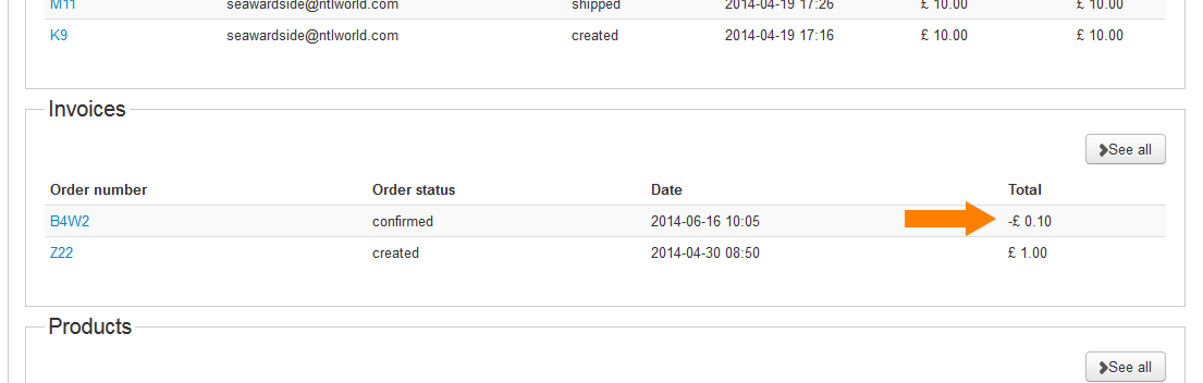

So I have a product that is £1 and £1 shipping = £2 total. We do not share commission on shipping as the vendor needs that to ship the item. I have no fee in the product only 10% commission for that seller. So everything goes through fine. I set status to confirmed in backend and then go to the vendor. However when i click on the vendor now it says that the vendor is owed £1.10... Which is strange. So when i click on the full vendor account it says that i owe the vendor total of -£0.10? If i click through to invoice, it will say the vendor total is £1.10 but surely if the commission on that vendor is just 10% and there are no other settings the invoice to the vendor would be £0.10 not £1.10? I would then transfer them the £0.90 manually and keep the £0.10 as payment of the invoice?
Kind regards
Alex
Alex
  • Posts: 26384
12 years 2 months ago #160419
When a price is negative it means that the vendor has been paid directly (a payment method with "commission" mode) or that the order is in a refund status.
I made some modifications in HikaMarket to improve the display when using fee and commission modes in the same time.
The problem is when we started HikaMarket there was only the fee mode and the commission mode come after and not with the better circumstances.
Because the mode wasn't planned at the begging, some part of the display does not right manage it.

Hi Alex,
You are using the "commission" mode in HikaMarket but your payment plugin is "paypal".
Paypal does not authorize the vendor to be paid directly, you (your store) will receive the money, the "commission" mode can't do anything good ; on the contrary, it will provide wrong results.
Because you are in commission mode, HikaMarket think that the vendor is paid directly so when you want to "pay" the vendor, it is the inverse. HikaMarket think that you will create an order to be paid.
If you change the HikaMarket mode in your tests, it will result very strange and no working orders ; where the vendor should receive the money and you want to be pay.. It is just not possible to do any debug or else with that.
So, please make a full stable HikaMarket configuration and then make your tests.
If you mix the tests, it is logical that you will have bad results.

Hi Alex,
www.hikashop.com/support/documentation/259-hikamarket-fees.html
We called "fee mode" when your store will be paid directly and you will have to pay them back.
We called "commission mode" when your vendors are paid directly and they have to pay you back (your commission).
You were using the "commission mode" but the payment plugins were configure to pay the store and not the vendors.
Few months ago, when I checked your configuration, the "fee mode" (which is the default mode in HikaMarket) were selected so I didn't understand why this option changed since that day.
Maybe the words for this option are not the right one and create some confusion.
If you or someone have a suggestion to improve it and avoid the general confusion, I will be happy to update the language files.
If you are using the "commission mode", you are saying to HikaMarket that the vendor will receive the payments directly.
HikaMarket can't know that the payment method are not sending the money to your store and not the vendor (unless you specify it in the payment plugin configuration). So it can't warn you if it does not have the possibility to know.
You can use paypal, you can use all HikaShop payment plugins, but you have to use the right HikaMarket mode to let him process the price calculation correctly.
