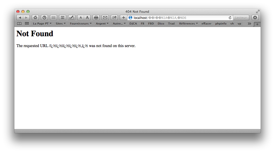

but I CAN'T neither save and nor go back with no problem.
I get this error for the « save » an « go back » buttons :

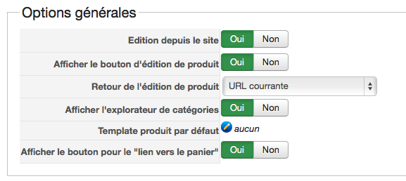

Here is my config for hikamarket :
En idea of the problem? It worked before (if I remember well)...

If I edit product on front-end with Hikamarket from localhost
the link of the « return » button is bad : <a href=​"http:​/​/​localhost/​Q���\��
���Z]​�[�ۋ\\��ۛ�[\�\�ٛ]​\��\\�X[�[�\��\]​Y\�]​\">​ (weird characters, encodage problem).
