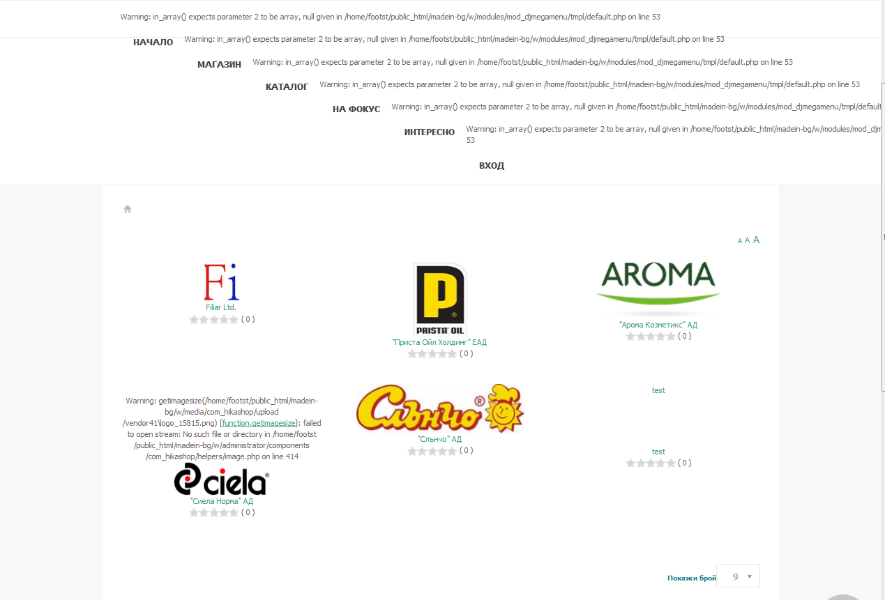

-- Error-message(debug-mod must be tuned on) -- : Warning: getimagesize(/home/footst/public_html/madein-bg/w/media/com_hikashop/upload/vendor41\logo_15815.png) [function.getimagesize]: failed to open stream: No such file or directory in /home/footst/public_html/madein-bg/w/administrator/components/com_hikashop/helpers/image.php on line 414
So, after updating to HM 1.6.0 the following error appeared on uploading from local project to working:

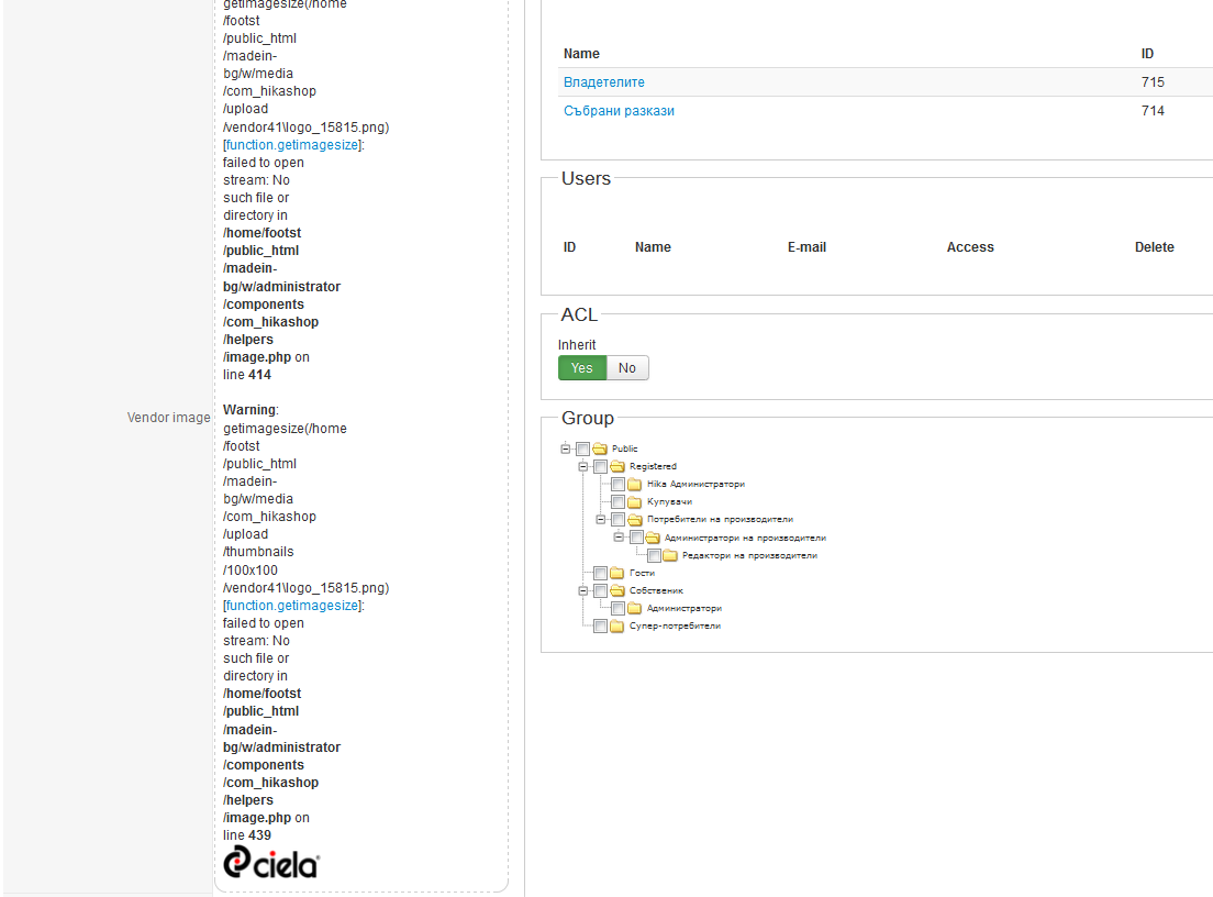

On the image of Vendor listing in frontend and on Vendor image in edit form in backend:
And the second warning appears in the main menu only on vendor listing page:
Warning: in_array() expects parameter 2 to be array, null given in /home/footst/public_html/madein-bg/w/modules/mod_djmegamenu/tmpl/default.php on line 53
I noticed the backslash after the vendor folder if that's the reason.

I forgot to mention that this happens only when the modifications are made locally (XAMPP for Windows) and then uploaded to the working server. No such error appears when the vendor is added online.
