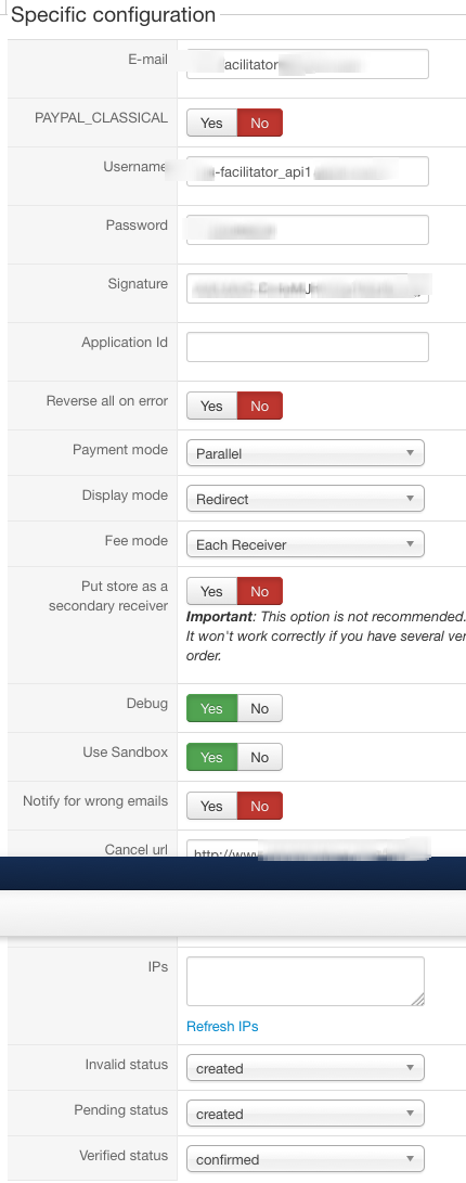

Can you please provide a screenshot of your paypal adaptive configuration (the sandbox one) ?
It will help me to understand the source of the issue and provide an explanation which could help other users with the same kind of issue.

I'm attaching a screenshot of the settings for sandbox. These settings work initially, but when I change to live and get the receiverlist null error and then switch back to sandbox w/ exact same settings I still get the same error. It's like something is getting stuck when I switch to live, so I don't know what's causing the error in either live or sandbox. Note: I've tried w/ "notify for wrong emails" set to both yes & no, w/ no effect on the error.
