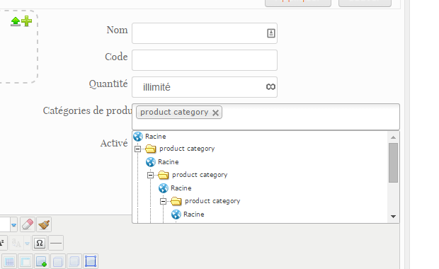

The category tree is not displayed correctly on the product creation form (front-end).
When I click on "product category", the list expands but with again the root category.
See attached image.
Thank you

Are you using a SEF extension ?
Because the tree is using an ajax call and replace dynamically a tag by the product id that you're expending.
But if the tag is not put "as it" in the url, (the tag contains curly brackets), the javascript can't perform the replacement and HikaMarket will not receive the category id during the ajax call.

I deactivated SH404 for Hikashop and Hikamarket (using Joomla router directly) and the categories came back in the tree.
