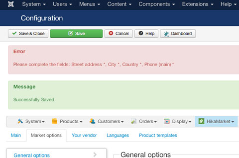

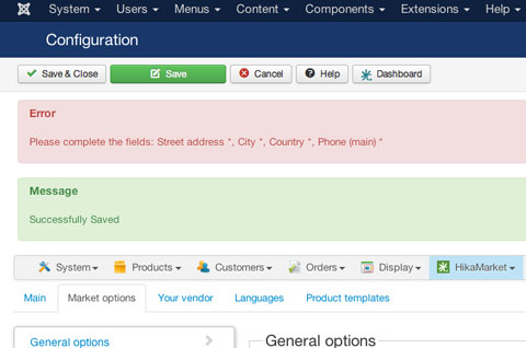

3. Misplaced error message in backend?
If any vendor profile (incl main vendor) has empty but required address fields, the error message as per attachment here appears on every save of the configuration in the backend until the fields are filled. Maybe you intended it as reminder to the admin that some required fields are empty? Otherwise I'd say the message shouldn't show there.

3. It's normal.
I don't want to refuse the save of the configuration (or the main vendor) even if the profile is uncompleted.
The messages are displayed so the user is informed that he can fill the missing elements of the main vendor but I didn't want to make that "critical".

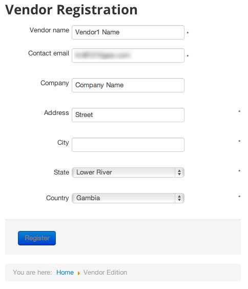

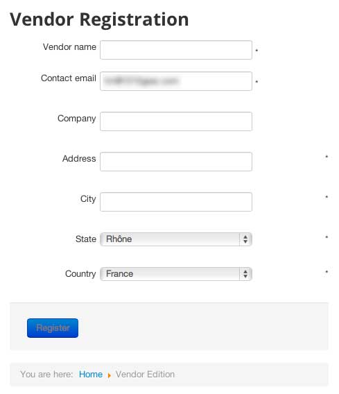

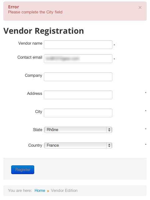

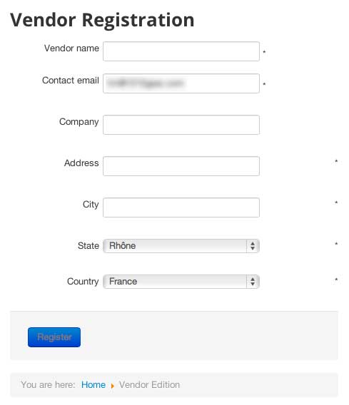

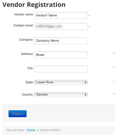

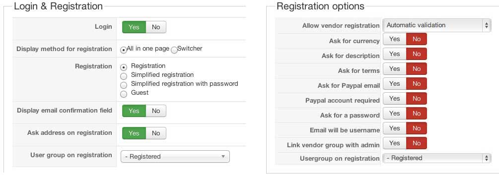

Now, I'm still able to reproduce the "forgetful" vendor registration. It's so plain simple that you must understand why I'm baffled how you can not reproduce it.
Here I hope all you need to finally experience it yourself:
Setup:
Joomla 3.4.1, Protostar
No extensions other than HikaShop 2.5.0 and HikaMarket 1.6.3

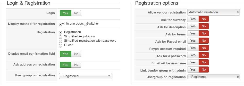

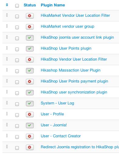

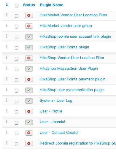

Status of plugins relevant for user and registration:
Relevant options in HikaShop & HikaMarket (as plain and simple as it can get, I guess):

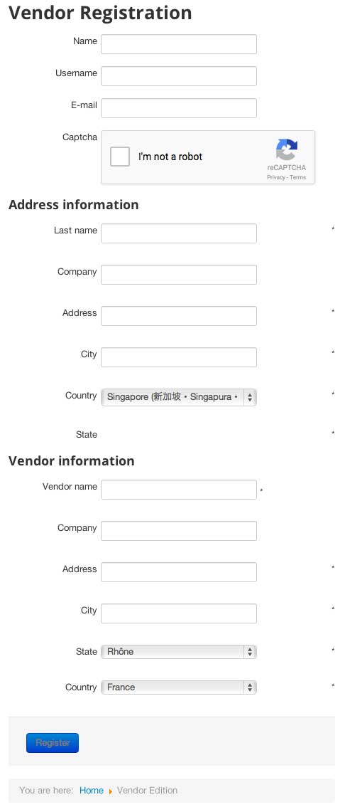

Scenario 1:
Guest registers as vendor.
(Not relevant for me in my case, but anyway.)
Registration form 'before' (Note: I unpublished/unrequired a few default fields to make it shorter for this test):

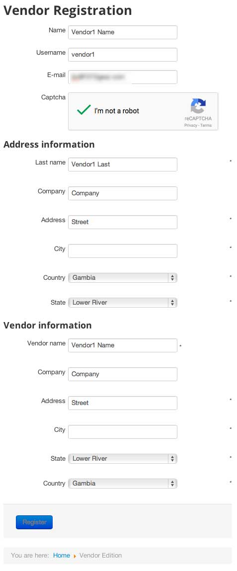

Registration form 'filled' (Note: the required City fields I forgot - on purpose):

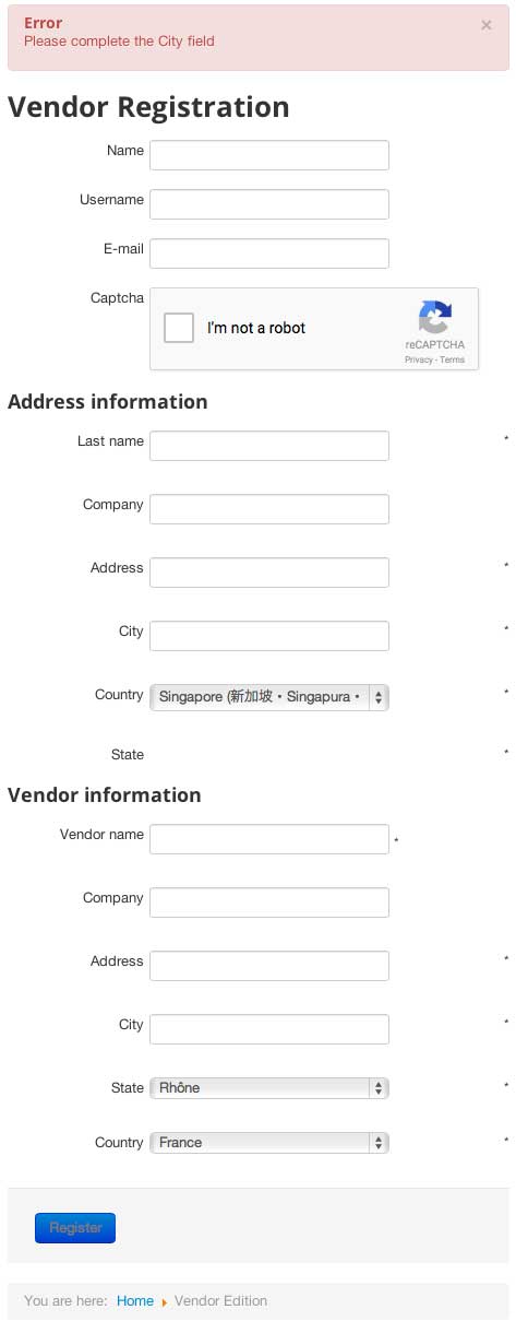

Registration form 'after' clicking button - all fields empty:

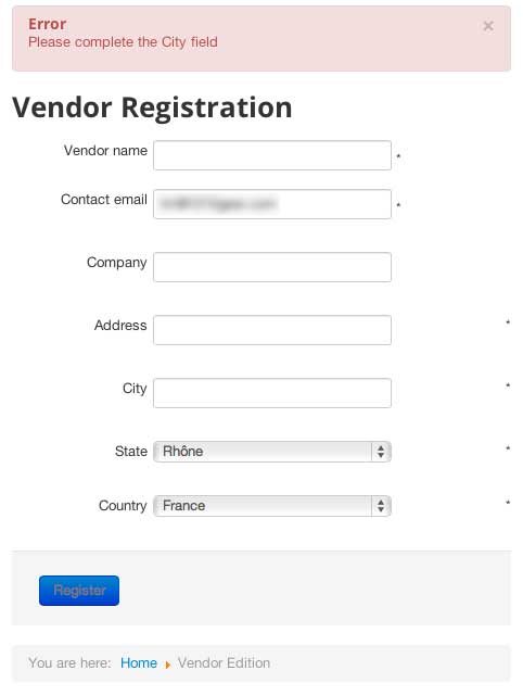

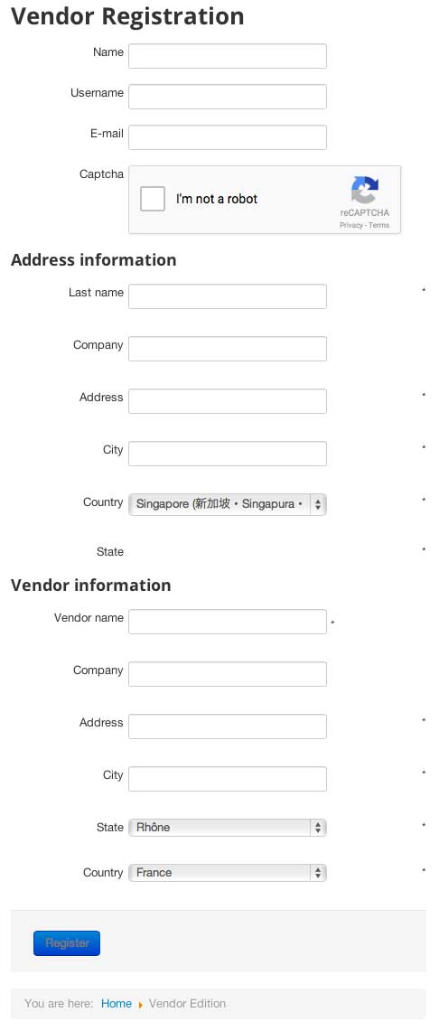

Scenario 2:
All the same, but logged-in Joomla user - now decided to register as vendor.
(My default case.)

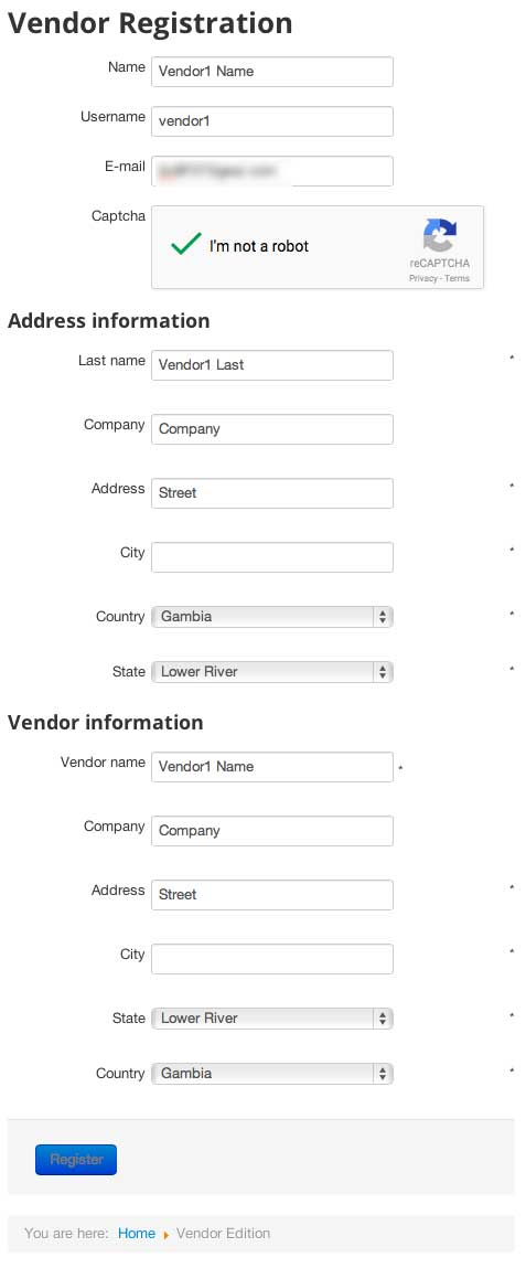

Registration form 'before' (same unpublished/unrequired fields as above):
Registration form 'filled' (Note: the required City field I forgot - on purpose):

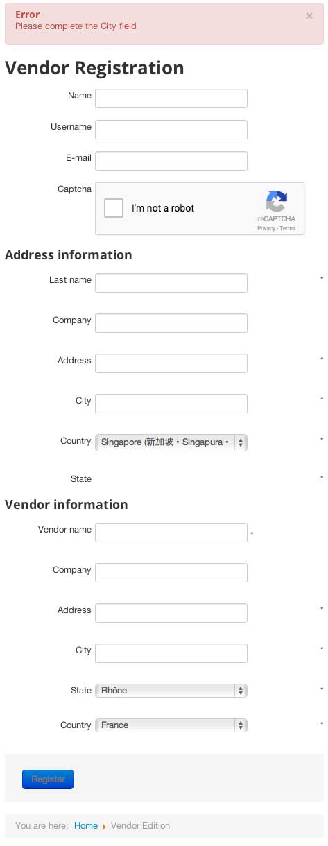

I can't think of any setting wrong or missing which could prevent the form from returning still 'pre'-filled. And again, I can't think of any reason why you were not able to reproduce it, but I hope you are now.

  • Posts: 26384
11 years 2 months ago #206772
Okay I got what you're doing.
You do not fill a required vendor custom field that you display during the registration.
And the vendor custom fields are the first element which is checked.
Your screenshots are confusing because you do not fill the "city" for both addresses but the message is just for the vendor custom fields.
And I generally do not display the address vendor fields because HikaMarket automatically copy the address from the user to the vendor.
Okay !
Now I'll be able to debug that :)
The following user(s) said Thank You: lousyfool
