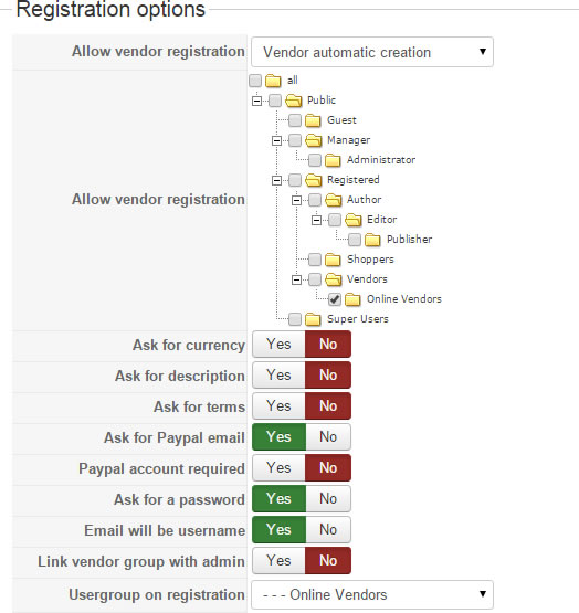

  • Posts: 29
10 years 10 months ago #213692
Sorry, I missed your reply before.
The usergroup that was selected for automatic vendor creation was a custom usergroup I set up called "online vendor" and its parent was "vendor" which had the parent "registered" (see image).
I have set to manual registration for now. It was convenient having the auto vendor creation by simply upgrading the user from vendor to online-vendor so if you have any hints on a fix please let me know.
