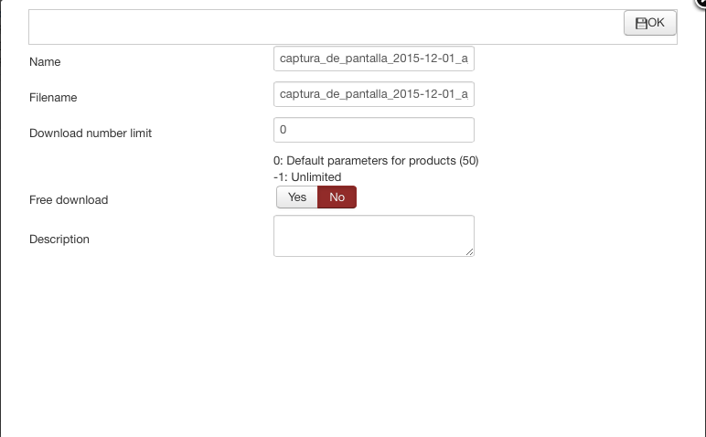

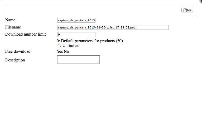

Additionaly my frontend file settings Popup looks broken and inaccessible. Does this depend on a setting?
while in backend looks usable

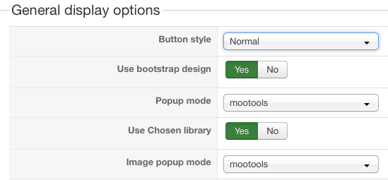

About the broken popup these are my actual settings for hikashop General display options
anyhow I played with many combinations and no porgress was percieved.
