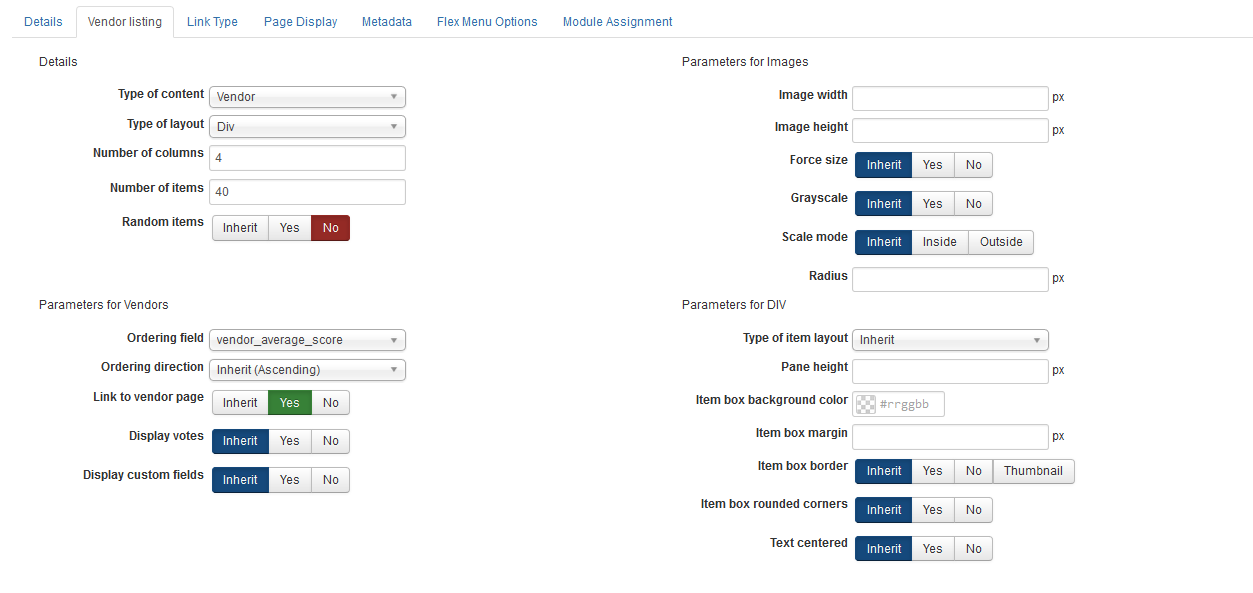

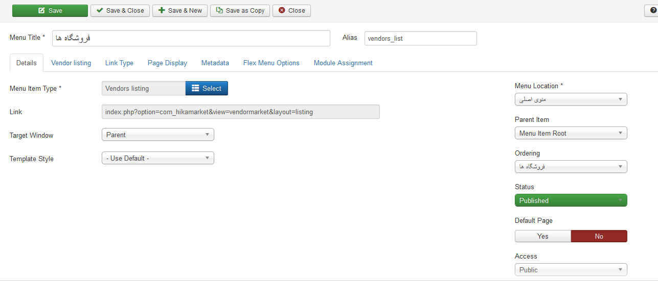

See the attached images. I captured two screenshot of the menu configuration. Is that help?

  • Posts: 26384
10 years 9 months ago #223464
Thanks for the screenshots.
Can you please re-download HikaMarket 1.6.7 in order to see if it fix your issue ?
