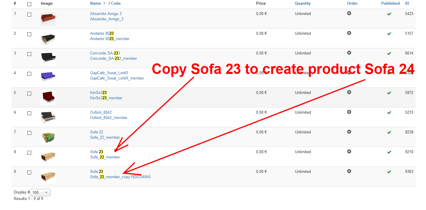

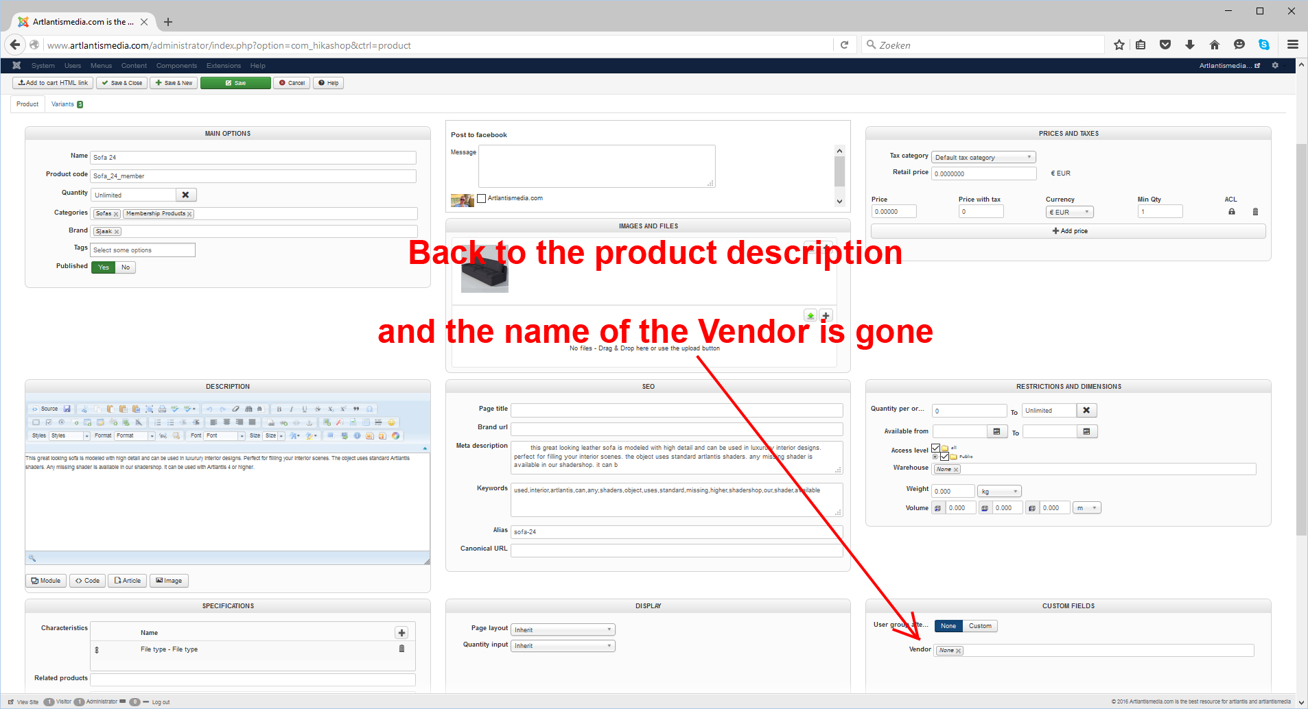

Most of the time when I create a new product I copy another one that is almost similar. I then only need to alter some fields to have a new product.

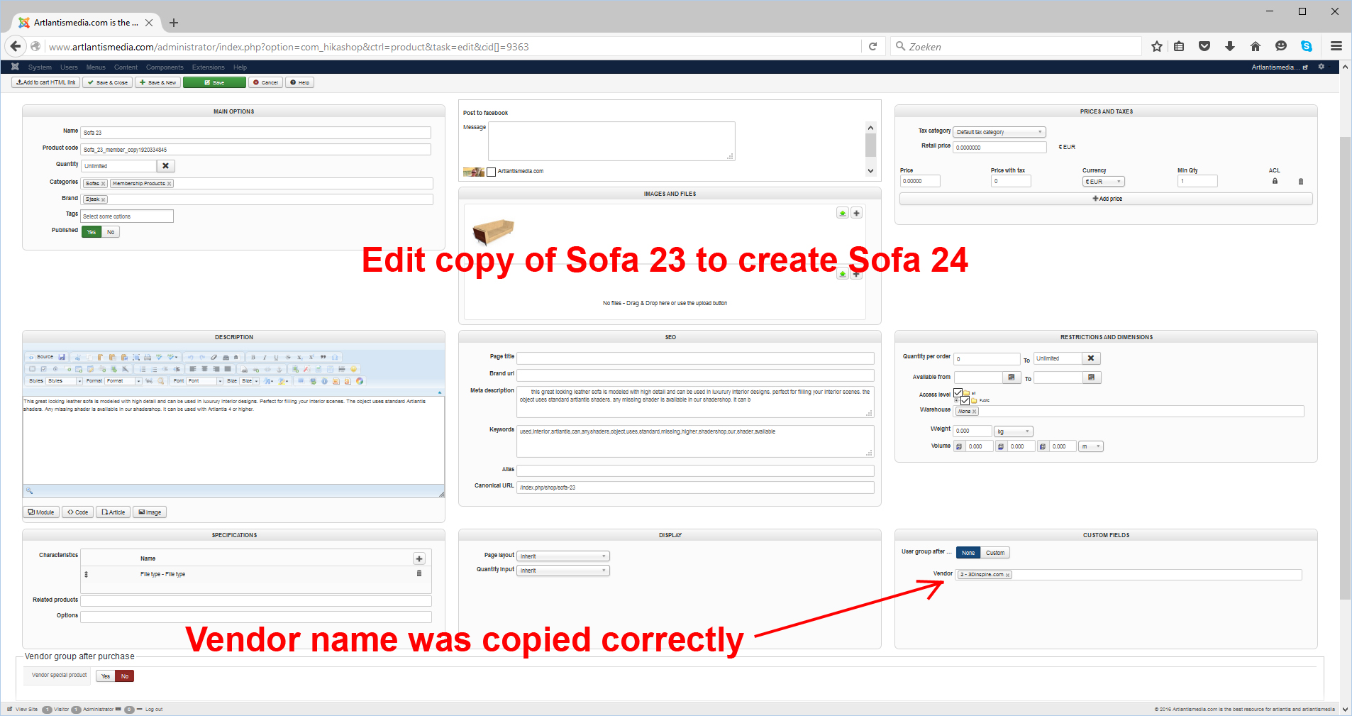

Lately I noticed something strange. When I copy a product to create a new one I can change some fields and everything goes OK. The name of the Vendor is also copied and that is necessary.

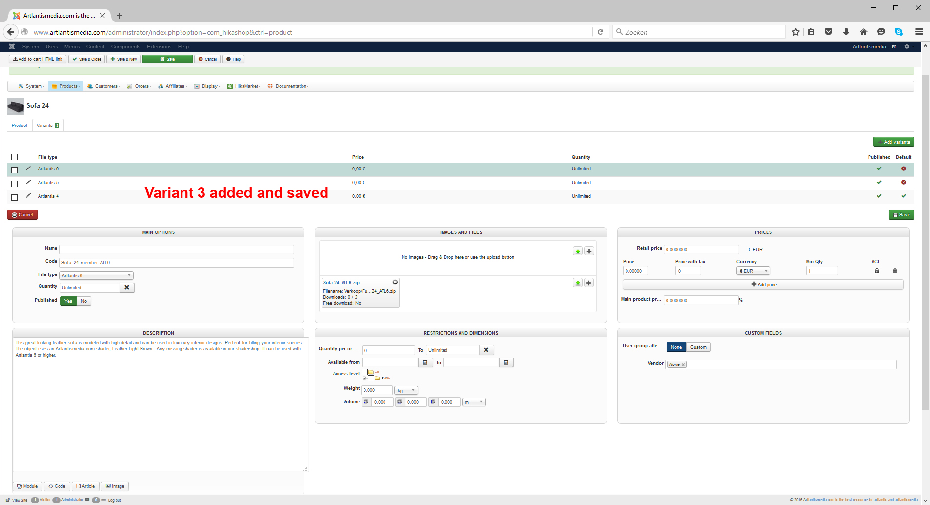

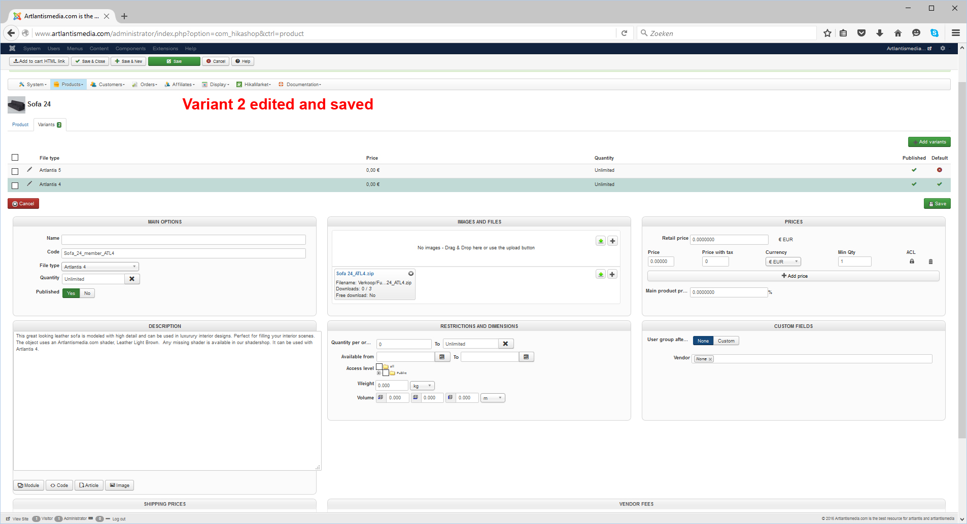

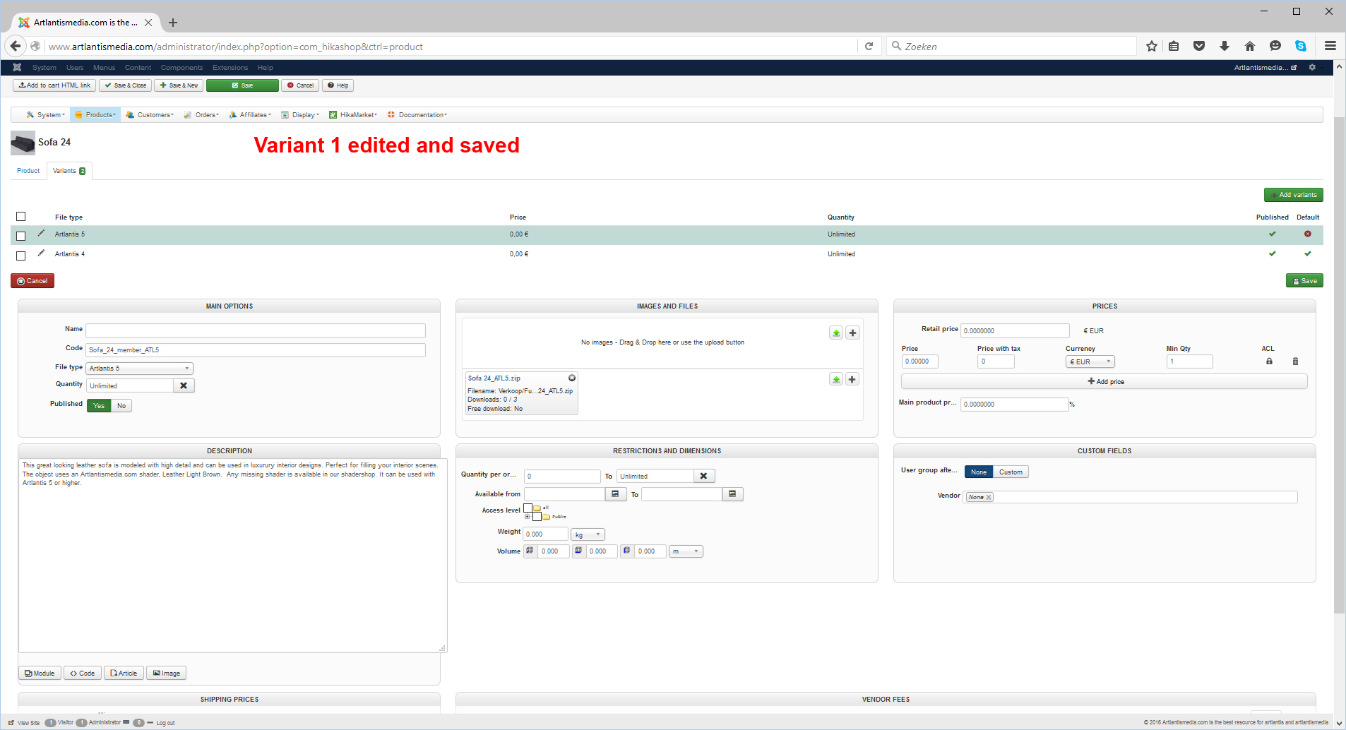

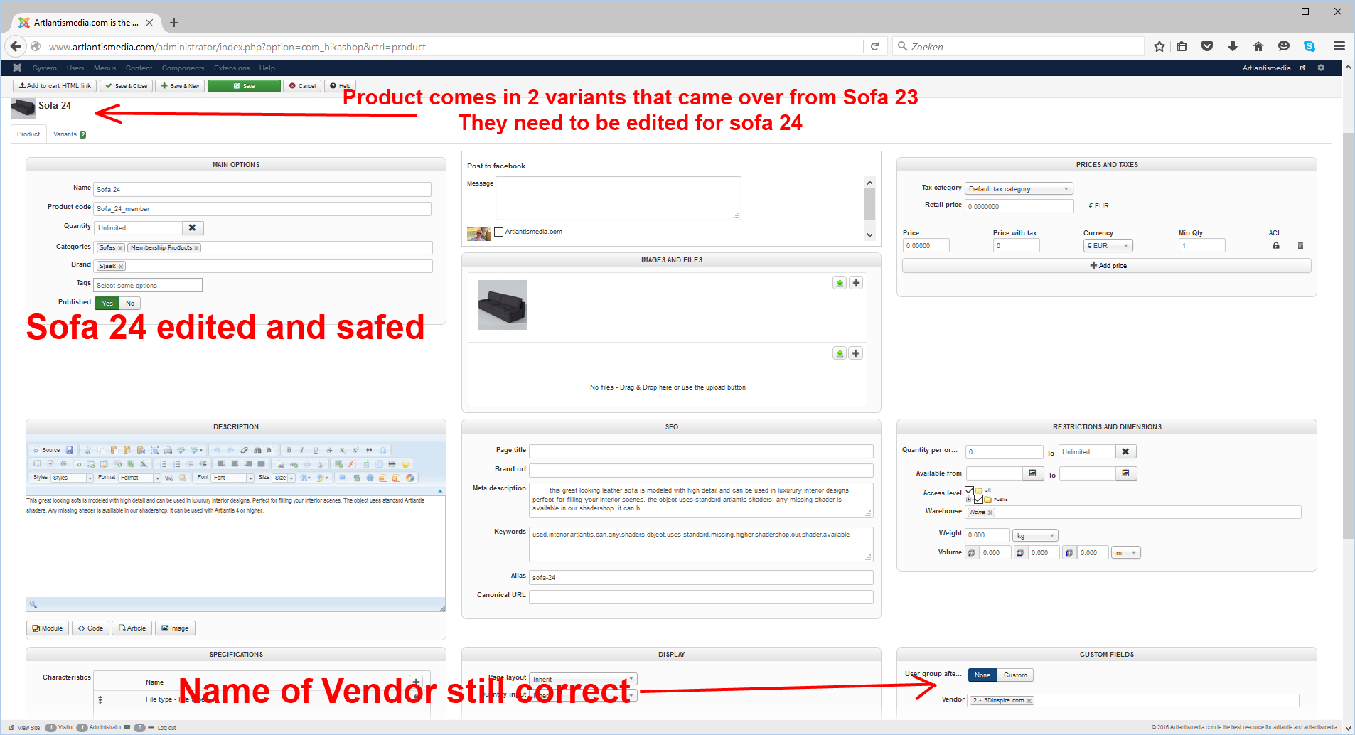

Only when I change or add one of the characteristics the vendor disappears from the product. I sell downloadable files and one of my characteristics is 'filetype'. So when I have a product saved in several filetypes then clients can choose which filetype they want to download. Changing or adding a filetype causes the vendor field of the product to be set to 'None'.
Is that a bug or is that default behaviour? I like to keep the vendor of the product when I add characteristics. Now I have moments that I forget to check whether the vendor field is filled correctly. Vendors will not be happy to loose sales about something like this.

10 years 5 months ago #233848
Hi Jerome,
I try to tell my story with screenshots. The number of the screenshots is the order of the sequence. I hope this makes it all clear.
Sjaak
  • Posts: 26384
10 years 5 months ago #233863
Please apply the patch describe in that thread
www.hikashop.com/forum/19-hikamarket/881...vendeurs.html#228459
