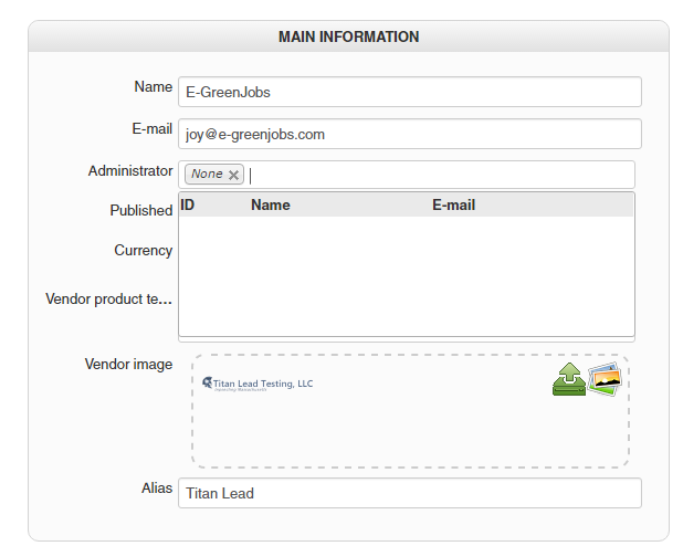

-- Error-message(debug-mod must be tuned on) -- : I'm not able to see any users to add them to the vendor
I'm new to HikaMarket and I am trying to associate my vendors to their products, but the vendor feature doesn't seem to be working. When I create the vendor records in HikaMarket--> Vendors there is NO option for administrators and there are no users available. When I click on the + to add users the system does nothing.

I'm not able to reproduce your issue but I have an idea on what could be the source of the problem.
Can you please edit the file "administrator/components/com_hikamarket/classes/user.php" and replace
		$vendor_id = hikamarket::loadVendor(false);
		if($vendor_id > 1) {
By
		if($vendor_id > 1 && !$app->isAdmin()) {
So if your account is related to a vendor you won't have the customer restriction in the backend.

  • Posts: 36
10 years 3 months ago #240822
OMG thank you. I spent hours on this. Once I was able to assign the account to be the administrator it worked!!!!!

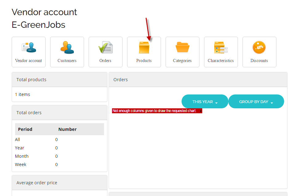

403 Access Forbidden
When clicking on the links in the dashboard most return blank pages, the products folder returns a 403 Access forbidden.

Please be sure that you have authorized the "front-end editing" in your HikaMarket general configuration.
www.hikashop.com/support/documentation/1...tml#config_main_main
I think that we will also block the vendor dashboard if the front-end editing is not activated ; because it looks weird to have the dashboard without the sub sections.

That fixed my problem. I intentionally turned off the front end editing so that my vendors wouldn't try to edit any articles etc... it looks like it is working now. Thank you again. (You may want to note it in the documentation).
