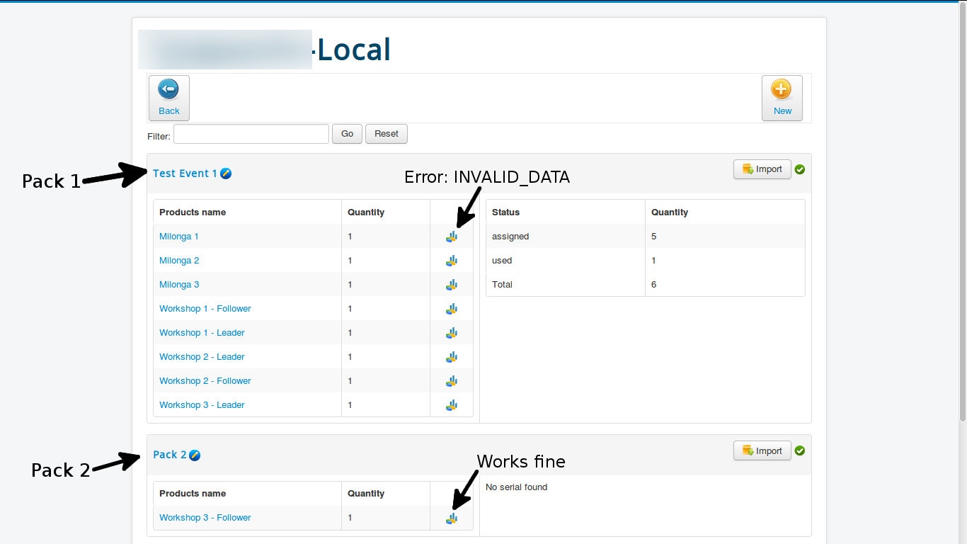

I'm using Hikaserial and HikaMarket multi-vendor and I'm having an issue with vendors managing serials from the front end.

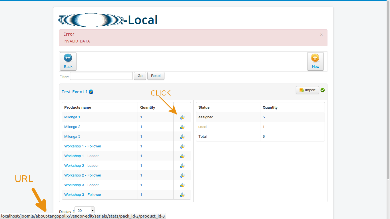

In this case, when a vendor goes to into “Serials” from his Vendor Account then it is presented with the screen like the one in the attachment. It shows the packs and the products that are linked with that pack. That's fine, but when I click on the stats icon for any of the products I get an error message INVALID_DATA.
In the attachment I show you where I click (the stats icon) and the URL that the stats icons points to (when I hover over the icon).

I did more troubleshooting on this issue and I found out the following:
- The issue appears when there are more than 1 product linked with a particular Pack of serials.
- If I only have one product linked with a particular pack then the stats show fine.
- Please see the attachment for further clarity
Is this the way it is supposed to work? So, if we want to see the detailed serial stats for one product in the front end of Hikamarket, then we need to create one pack per product?
