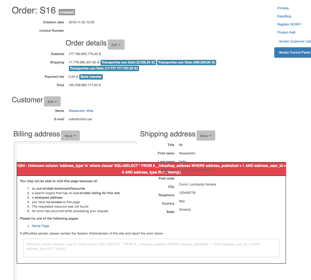

Login as a vendor,
I get to edit a user order and can't select an alternative address not for shipping nor for billing.
In the dropdown more button, I can get to work "Show Default", "Show Details" and "Edit Address".
When choosing "Select Address", I get a SQL server error inside the opening iframe.
Unknown column 'address_type' in 'where clause' SQL=SELECT * FROM #__hikashop_address WHERE address_published = 1 AND address_user_id = 6 AND address_type IN ('', 'billing')

9 years 9 months ago #255863
Please add the column "address_type" in the table "hikashop_address".
That column shouldn't be add in the last release but it looks like it will only be available in HikaShop 3.
ALTER TABLE `#__hikashop_address`ADD `address_type` varchar(50) NOT NULL DEFAULT '';

9 years 9 months ago #255890
Thanks, it works properly now.
