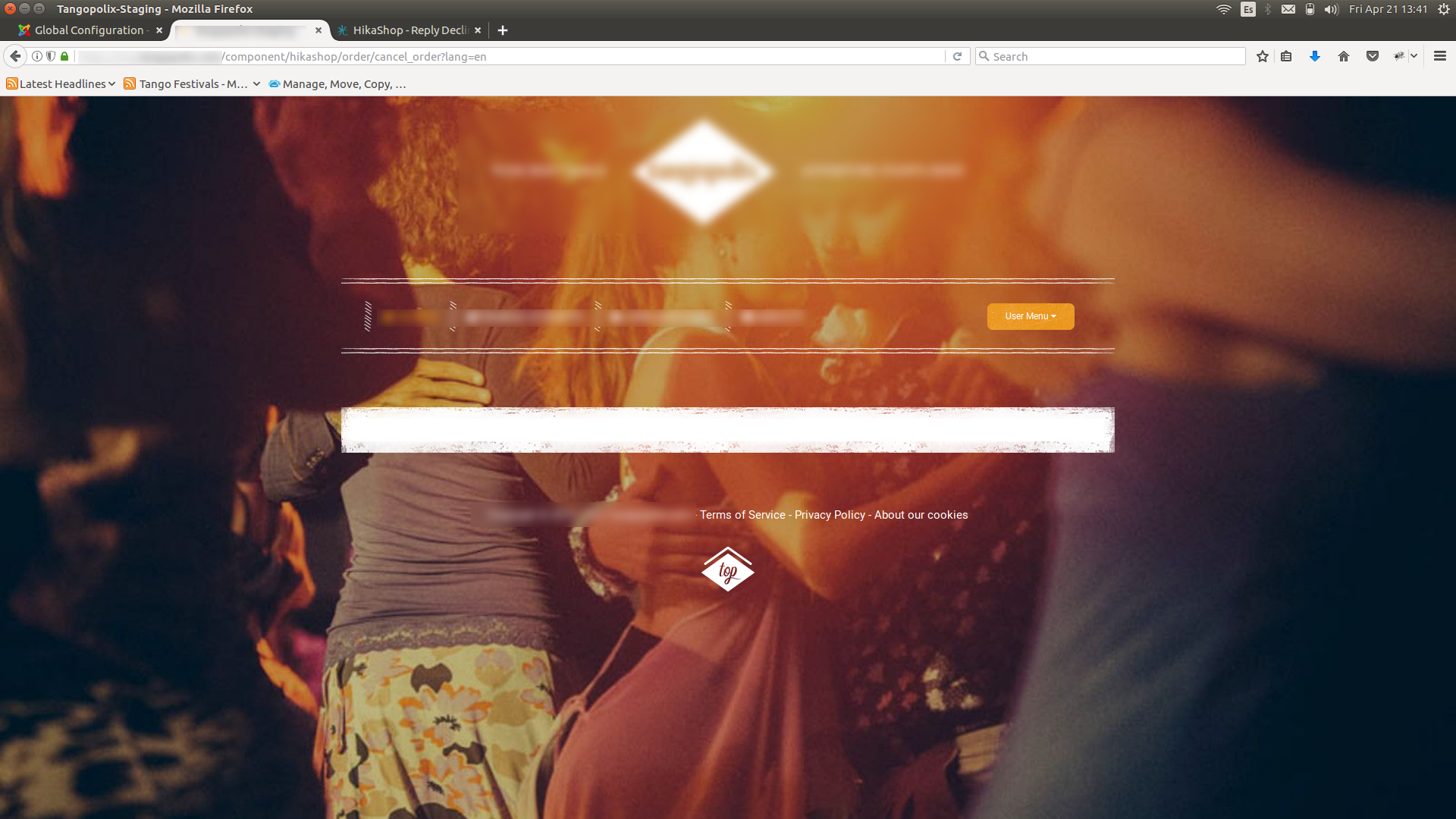

Sorry it is not a full blank page. All the modules, menus, etc load fine, it is just the area where the component displays has no content at all (see attached)
I'm testing on a testing environment with PHP error reporting set to maximum and I don't see any fatal error, warning, notice or anything in fact. Nothing gets added to the error log either when I perform this operation.
The order does not get updated and there is no redirection to the cancel url which I have setup in the plugin config.
