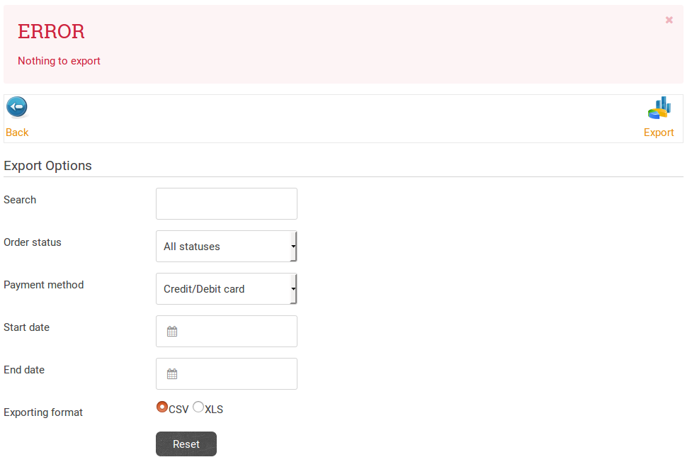

Hi there,
When a Vendor tries to export his orders to CSV from the front end and filters the output by payment type, he gets error message "Nothign to export" - see screenshot.
However there are lots of orders with that Payment method.
When he filters the export by dates or order status seems to work fine, but not when filtering by Payment method.
I'm using two payment methods MangoPay and Stripe which have been renamed to "Credit/Debit Card" and "Test Payment" respectively.
thanks!
