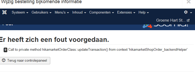

-- Error-message(debug-mod must be tuned on) -- : Call to private method hikamarketOrderClass::updateTransaction() from context 'hikamarketShopOrder_backendHelper'
How can I solve this error? Can you please assist?
I have a live environment and a test environment. For some reason the test environment works fine, but the live environment produces the error:

Thanks for the report.
In the file "administrator/components/com_hikamarket/classes/order.php" you can replace
private function updateTransaction(&$order, &$subOrder, $vendor_new_total) {
By
public function updateTransaction(&$order, &$subOrder, $vendor_new_total) {
In our end we will perform some tests in order to checks and update the HikaMarket package afterwards.

Thanks, that fixed it!
