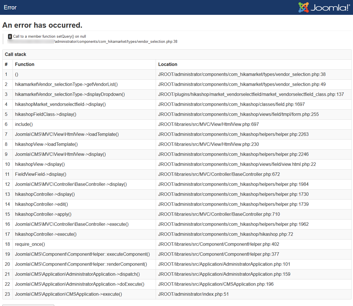

-- Error-message(debug-mod must be tuned on) -- : Call to a member function setQuery() on null
[...]/administrator/components/com_hikamarket/types/vendor_selection.php:38
I can not create a custom field with Vendor Selection type (in order table).

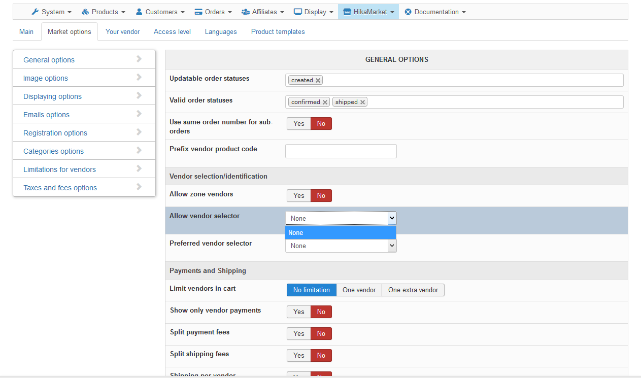

Afterwards, please check that you configured the "allow vendor selector" in the HikaMarket configuration :
www.hikashop.com/support/documentation/1...onfig_market_general

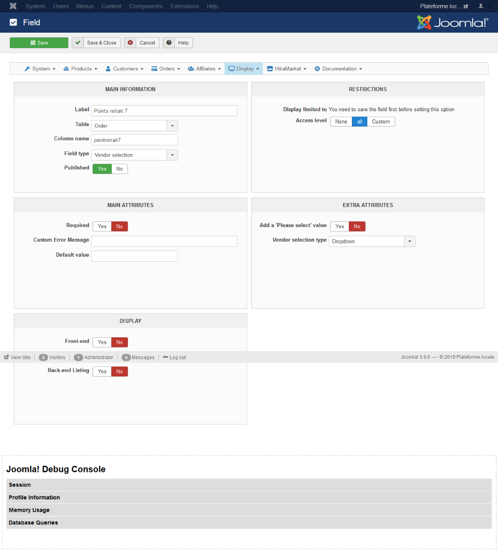

7 years 2 months ago - 7 years 2 months ago #309851 by nossibe63
Here is the creation (the hidden Display Back-end Form is set to yes) :
Here is the edition of the custom field that has just been created :
Neither this custom field nor any other is available on Allow vendor selector :

7 years 2 months ago #309875 by nossibe63
Code:
$db = JFactory::getDBO();
do not work.
I added to the constructor
Code:
$this->db = JFactory::getDBO();
and it work fine !
