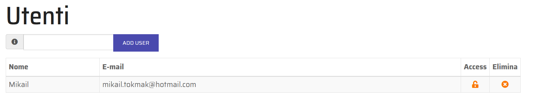

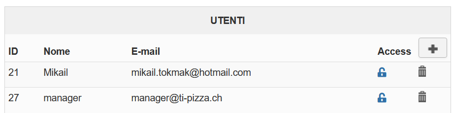

I try to modify a vendor with another account vendor from the frontend. But if I Save the modify, after I lose the permssions for manage this vendor. Maybe is because in the bottom the current user "manager" doesn`t appear in the users list (you can see in the attachmnet) and maybe after I confirm to save I confirm to save without this user, but in the backend is set (as you can see in the attachment).

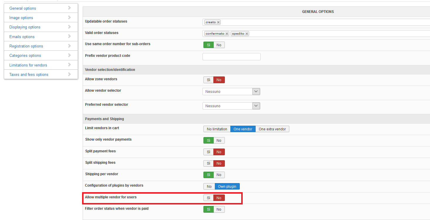

6 years 3 months ago #320281
The patch is ready for the next release.
If you want to avoid the issue for the moment, the best is to deactivate the "Allow multiple vendor for users" setting.

6 years 3 months ago #320493

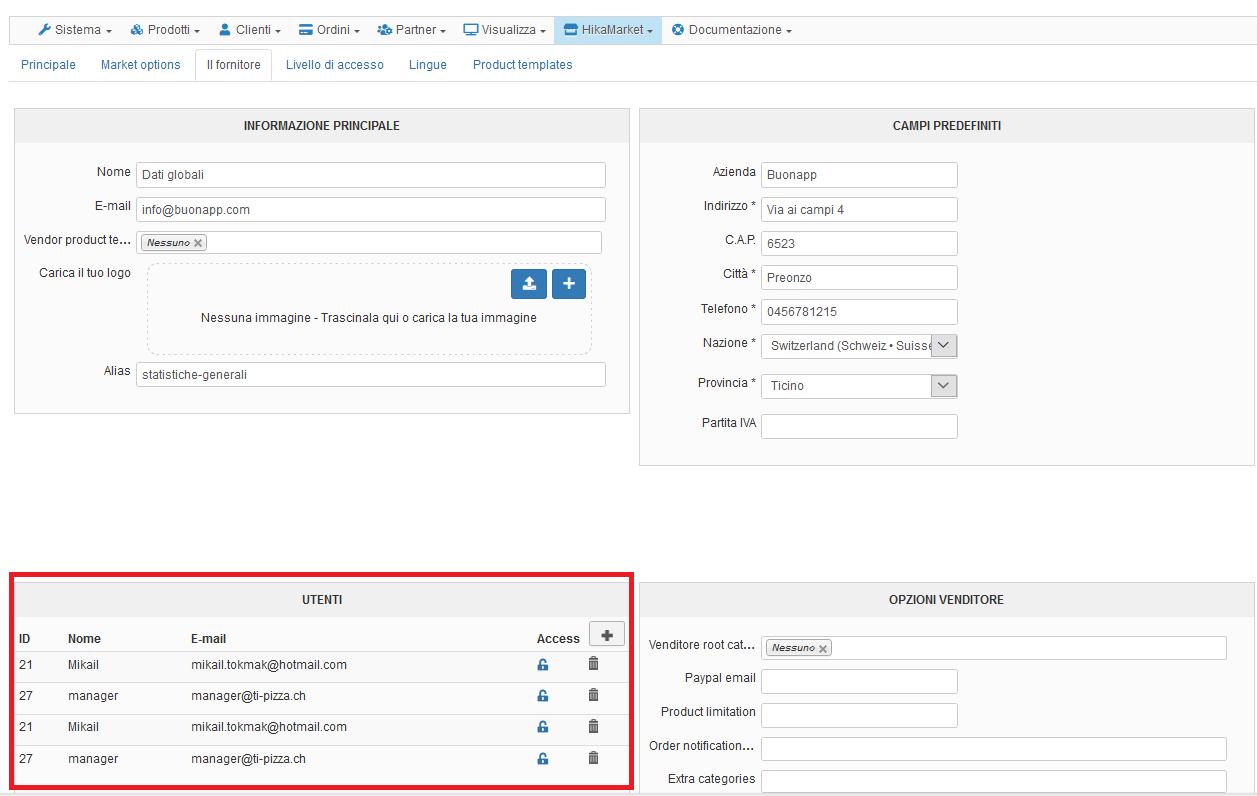

6 years 3 months ago #320521
An account which will be related to the "main vendor" will be able to manage all orders and products like in the backend.

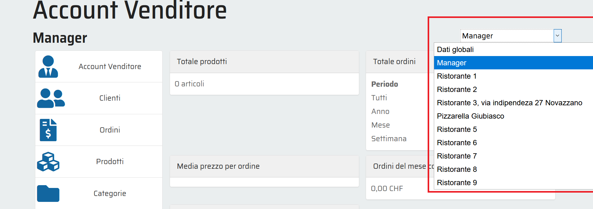

6 years 3 months ago #320533
I added the accounts related to the main vendor (as you can see in the screenshot marked in red), but if after I deactivate the "Allow multiple vendor for users" setting I can`t see the list of the vendors in the cPanel in the frontend for manage and see the statistics of the vendors.
