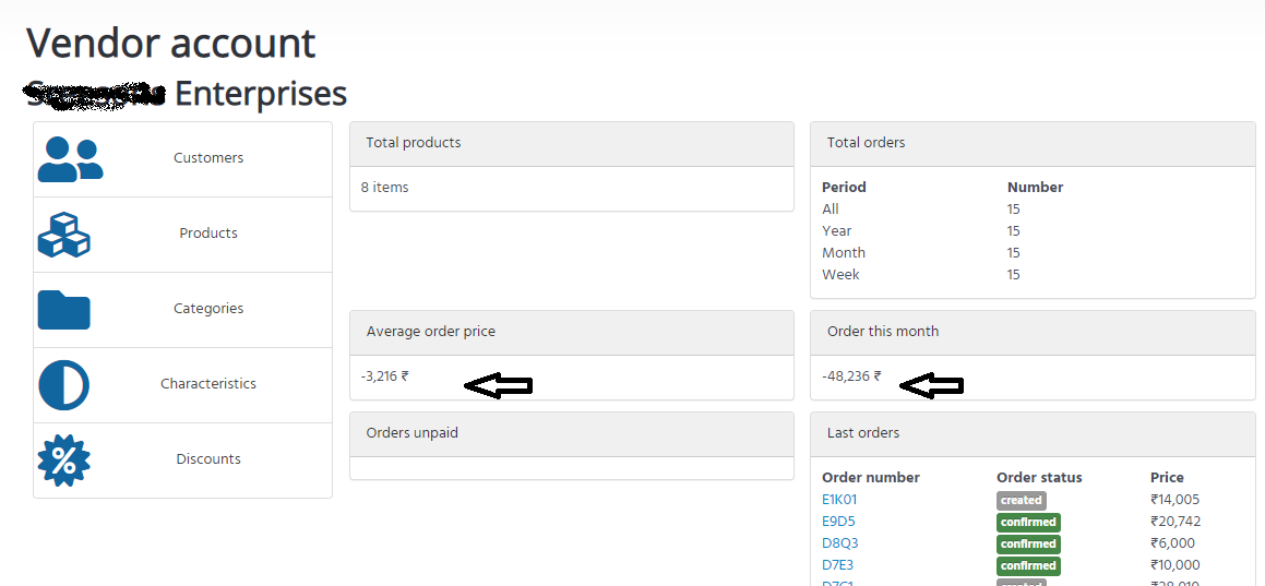

In Hikamarket Multi vendor module, when I login to the vendor dashboard, the average order price, order for this month totals are displaying in negative (-) sign before the amounts. Can you please help to remove it and what is the reason for negative amount display?

6 years 2 months ago #321198
Thank you for the confirmation.
Unfortunately, I cannot reproduce your issue in my test website.
The query made for the statistics should handle the display of the price correctly ; when you are in "vendor paid directly", the vendor order price is negative (so we can know that the vendor has been paid directly) and in such case, the value will be the order total minus the omission.
AVG( CASE WHEN hk_order.order_vendor_price >= 0 THEN hk_order.order_vendor_price ELSE (hk_order.order_full_price + hk_order.order_vendor_price) END )
I would require more details about your fee configuration and probably more details about the order seen by the vendor.
If you still have a negative value, it should mean that there order total is inferior than the omission.

  • Posts: 44
6 years 2 months ago #321303
Hi Jerome,
Our vendors are paid directly exactly the amount paid by the customer on the portal. There is no fees, commission, etc to be deducted. It happens offline. The final cart value paid by the customer should reflect as it is on vendor page including the tax breakup, coupons, etc.
