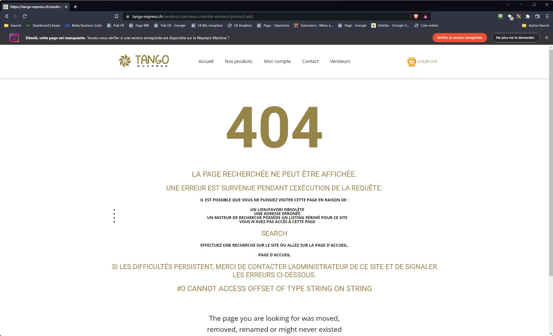

4 years 3 months ago #341926
Can you please send us a screenshot of the page.
I do have the feeling that there is a PHP error which is translated into a 404 page in your website.
  • Posts: 370
  • Thank you received: 28
4 years 3 months ago #341947
OK, here it is, but it is just a 404 message...
“Si tu ne travaille pas pour tes rêves, quelqu'un t'embauchera pour travailler pour les siens" - Steeve Jobs
"La sagesse, c’est d’avoir des rêves suffisamment grands pour ne pas les perdre de vue quand on les poursuit." - Oscar Wilde
4 years 3 months ago #341971
There is bit more, we can see an error message
#0 CANNOT ACCESS OFFSET OF TYPE STRING ON STRING
But it looks like you need to activate temporally the debug mode in the Joomla global configuration, in order to get more details about the issue (the file, the function name and the line).

4 years 3 months ago #341987
The issue looks related to the HikaShop core (field class).
I sent an email to the rest of the HikaShop team in order to understand the nature of your issue, that I can't reproduce for the moment.
Do you have product custom field configured ?
Maybe a "zone" product custom field ?

4 years 3 months ago #342009
Can you please confirm that line 3079 in the mentioned file is:
if($field->field_type == 'zone' && $field->field_options['zone_type'] == 'state') {
  • Posts: 370
4 years 3 months ago #342021
Yes. Correct.
4 years 3 months ago #342025
So that line can just be processed when a ZONE custom field is being checked.
In order to skip the issue, you can replace the line with
if($field->field_type == 'zone' && is_array($field->field_options) && $field->field_options['zone_type'] == 'state') {
  • Posts: 370
4 years 3 months ago #342040
It is ok with this code.
