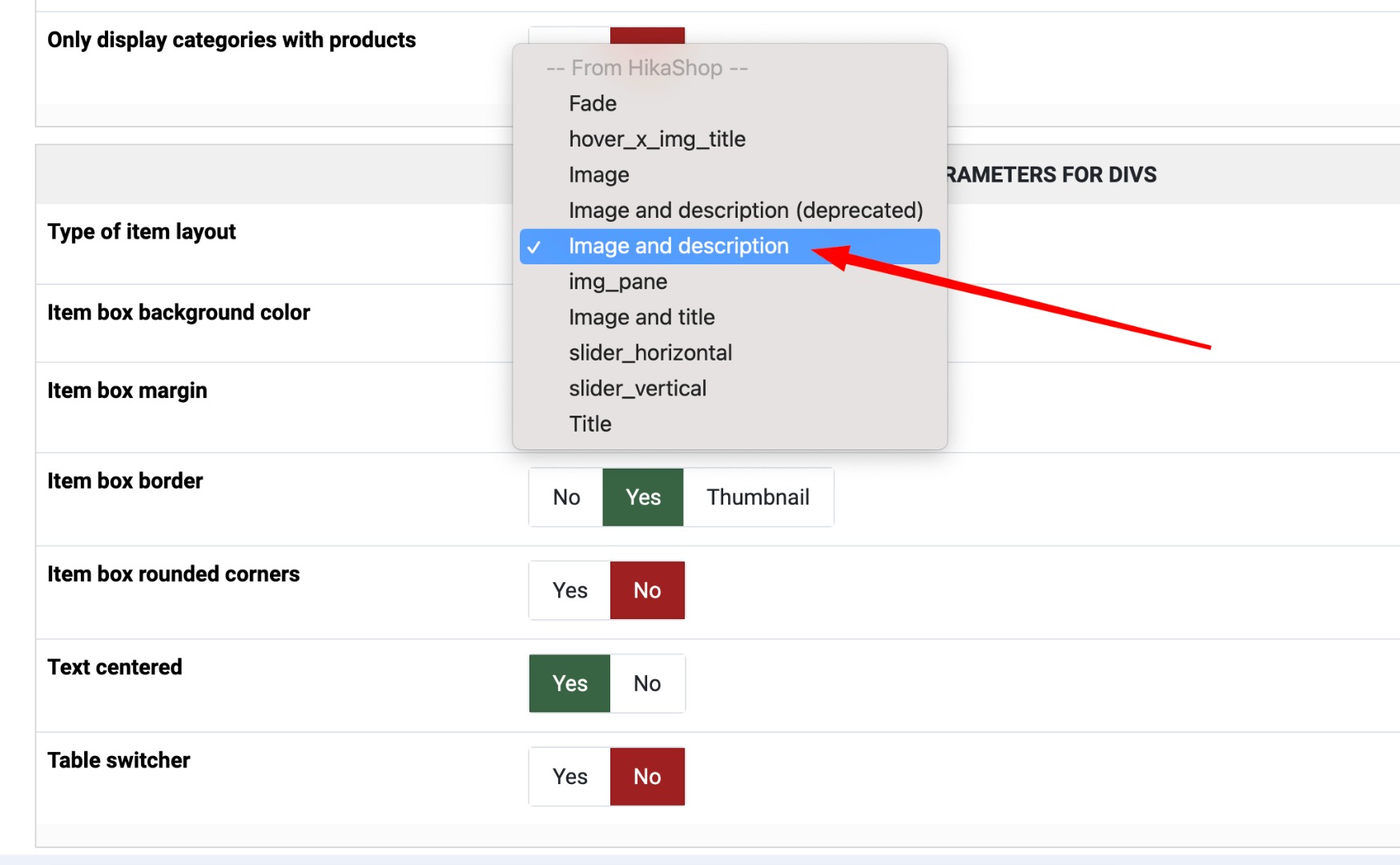

On the configuration page of Hikashop > tab Displays > section "DEFAULT PARAMETERS FOR DIVS”. I selected the option “Image and description” for the setting “Type of item layout” This is new option replacing for the deprecated one. When I select this option, Hikamarket will use the layout file: components/com_hikamarket/views/vendormarket/tmpl/listingcontent_img_description.php
But I think your team forgot to create this file, and this cause error when I use the layout “Divs” for the page “Vendors listing”.
To resolve this issue, my dev created a new layout file in the template overrides folder:
templates/[template-name]/html/com_hikamarket/vendormarket/listingcontent_img_description.php
He asked me to report this to the Hikashop team to add this missing file for the Hikamarket component in the next release.
2 years 1 month ago #362386
In HikaMarket, the view is "listingcontent_img_desc" and is not deprecated.
The display of the HikaMarket vendor listing should be done with the HikaMarket settings, not the HikaShop one.
I don't understand how you push an HikaShop layout setting in an HikaMarket one but you will have a lot more issues since there are no "slider" views for vendor listings.

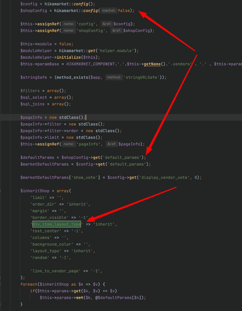

We double checked Hikamarket code, for some settings it will check and get value from Hikashop settings.
As you can see in Hikamarket configuration page, it does not have setting of “Div items Layout Type”, and this setting get from Hikashop setting.
We checked source code of the file:
components/com_hikamarket/views/vendormarket/view.html.php
Just trying to help. :)
2 years 1 month ago #362420
Thanks for your feedback.
Thus the best would be to remove the div_layout from the inherit values ; because there are a lot of HikaShop layouts which are not available in HikaMarket.
