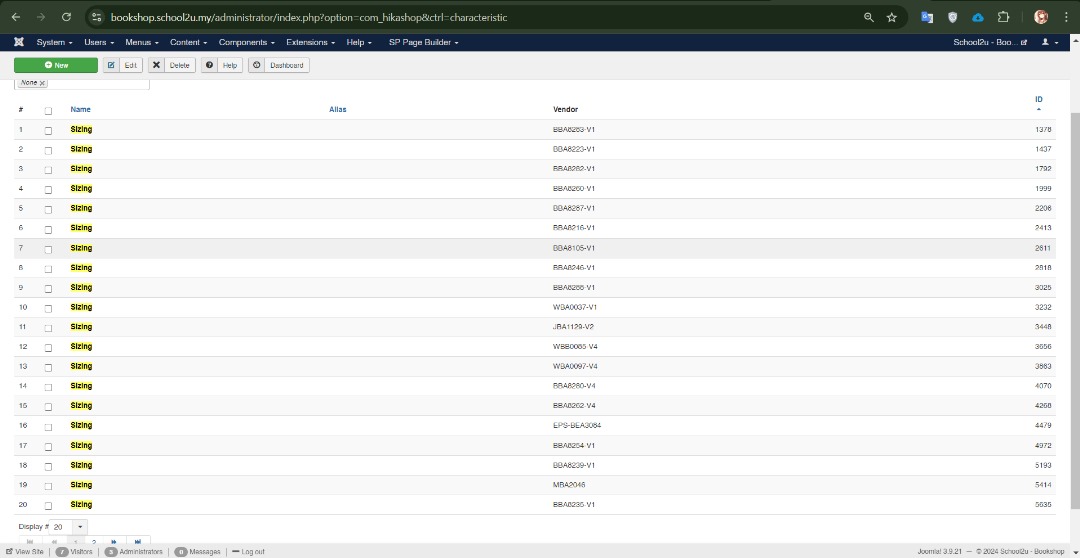

Facing some problem when multiple vendor having same name characteristics for example "sizing", the import of default value of this "sizing" will not update during the import
any advise on this?

2 years 1 month ago #362461
Here's the screenshot of the characteristics page and the CSV.

The issue is, when in multivendor environment, vendor creating same name Characteristics will create multiple same name column
due to this , the import are having problem
