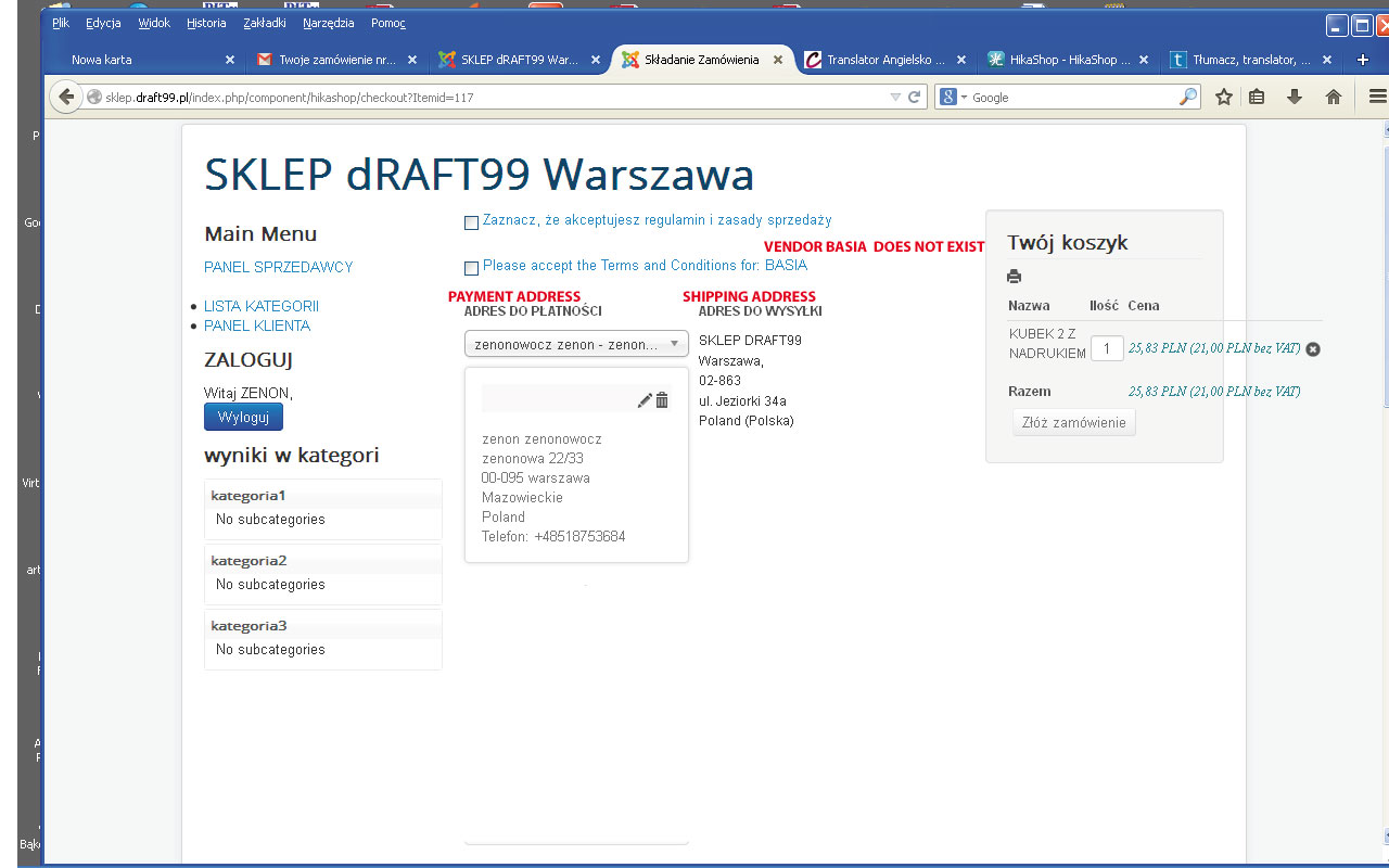

I found a solution, simply remove the entry in the databases.
What with orders? -nothing. as the vendor unsubscribe from the store can just be deleted.
you dont see error? look on screeshoot - BASIA is unpublishing

In the file "components/com_hikamarket/views/checkoutmarket/view.html.php" you can replace
$query = 'SELECT vendor_id, vendor_name, vendor_terms FROM '.hikamarket::table('vendor').' WHERE vendor_id IN ('.implode(',', $vendors).')';
By:
$query = 'SELECT vendor_id, vendor_name, vendor_terms FROM '.hikamarket::table('vendor').' WHERE vendor_published = 1 AND vendor_id IN ('.implode(',', $vendors).')';
It should solve the problem for the terms & conditions.
