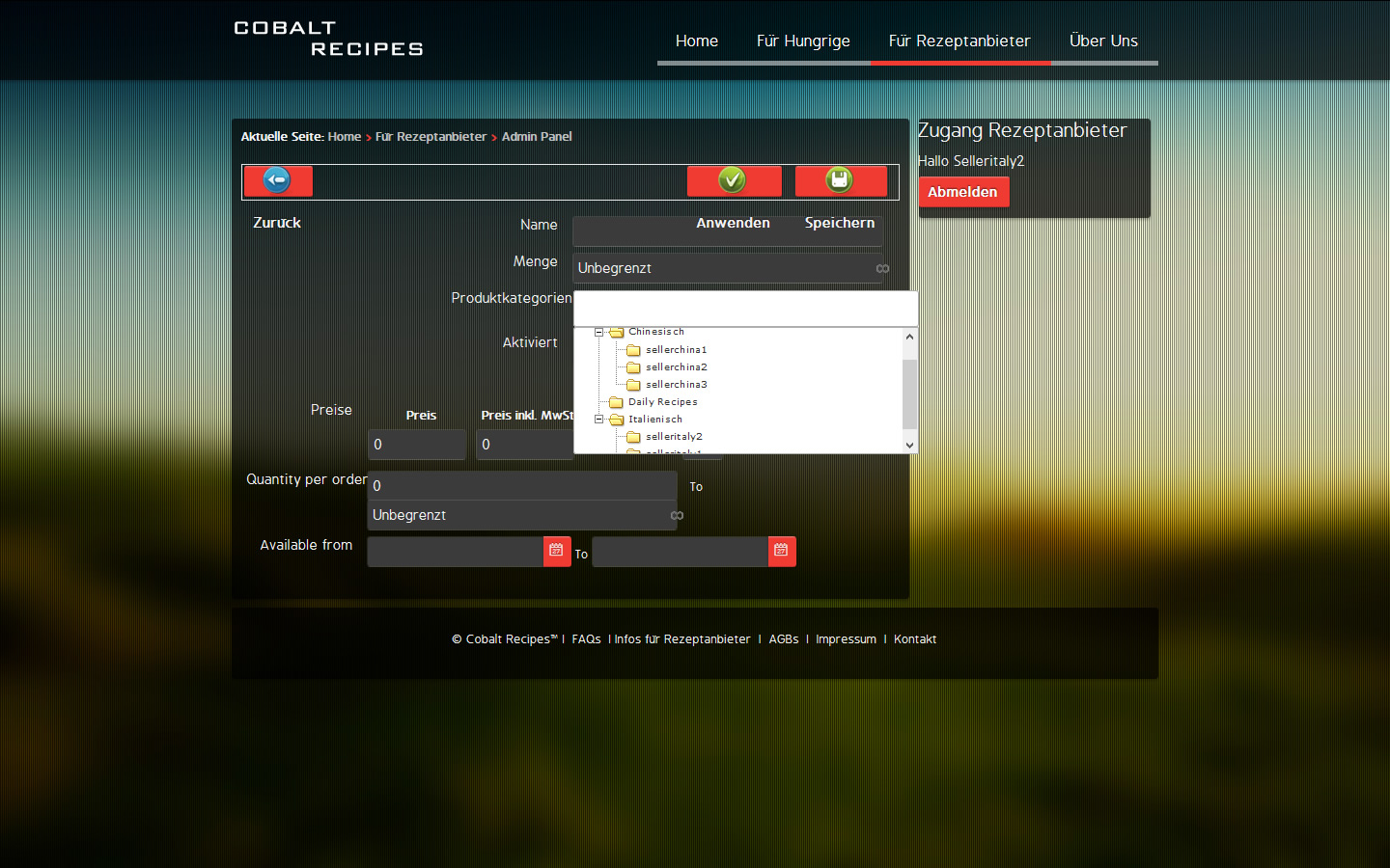

Have a look at the screenshot. This is an example with 3 categories. 2 categories contain 5 different vendors in total:
The ideal solution would be that during the initial vendor set up, one can configure the categories, which a vendor can see, when he is creating a new product...

  • Posts: 26381
13 years 6 months ago #89528
It is the option "vendor root category".
www.hikashop.com/en/hikashop/143-hikamar...ml#opt_vendor_chroot
