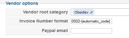

I've just set the vendor invoice number format in the vendor options this way: {date format="Y"}/{id size="5"} but still I see the order number format instead of this in the new invoices I try to generate.

I am sorry but it works fine.
When I change the order status of a created sub order (which does not have any invoice id generated).
The generated invoice id is right:

In the vendor options I cannot see the "Vendor root category". Something misconfigured in my case?
  • Posts: 26381
13 years 6 months ago #90335
It's because you don't have the option "Change vendor root category" activated.
There is no link with the invoice generation.
