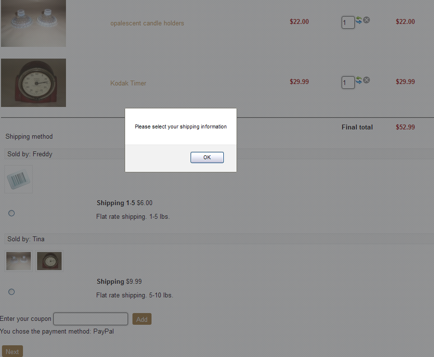

When more than one vendors items are in the cart and they both have shipping you can not select the the shipping method or have it automatically selected.
This means you can not proceed to the next checkout step.

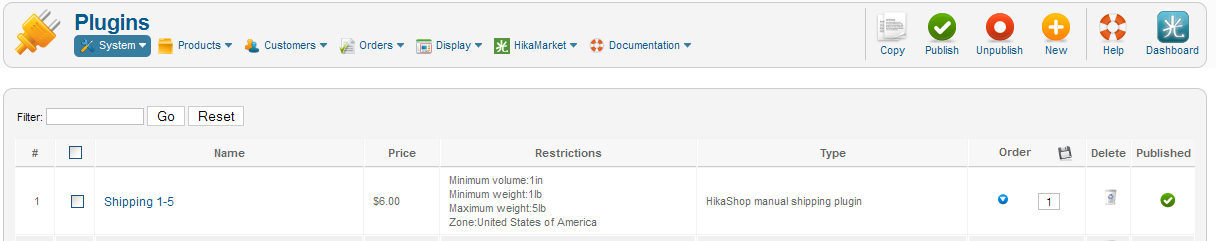

I have setup a shipping module by weight, see screen shot,

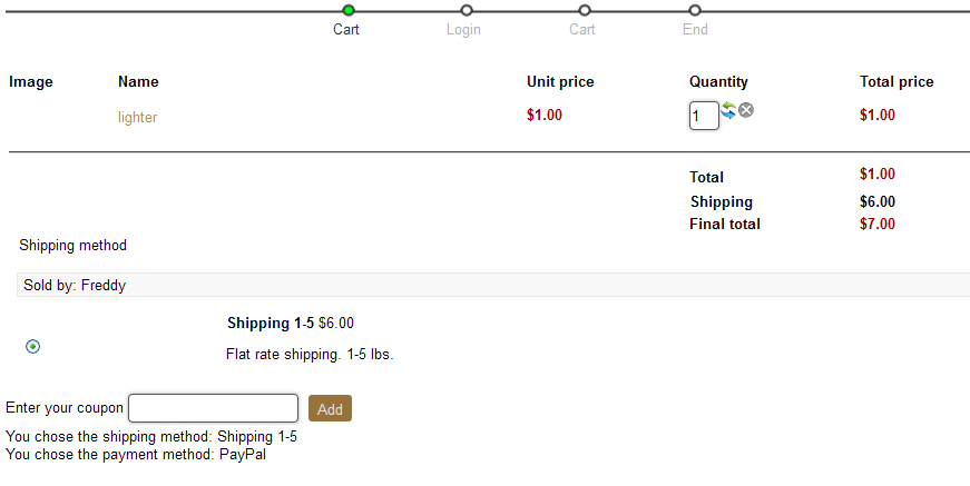

Every thing seems to work ok if only one vendors item/s are in the cart.

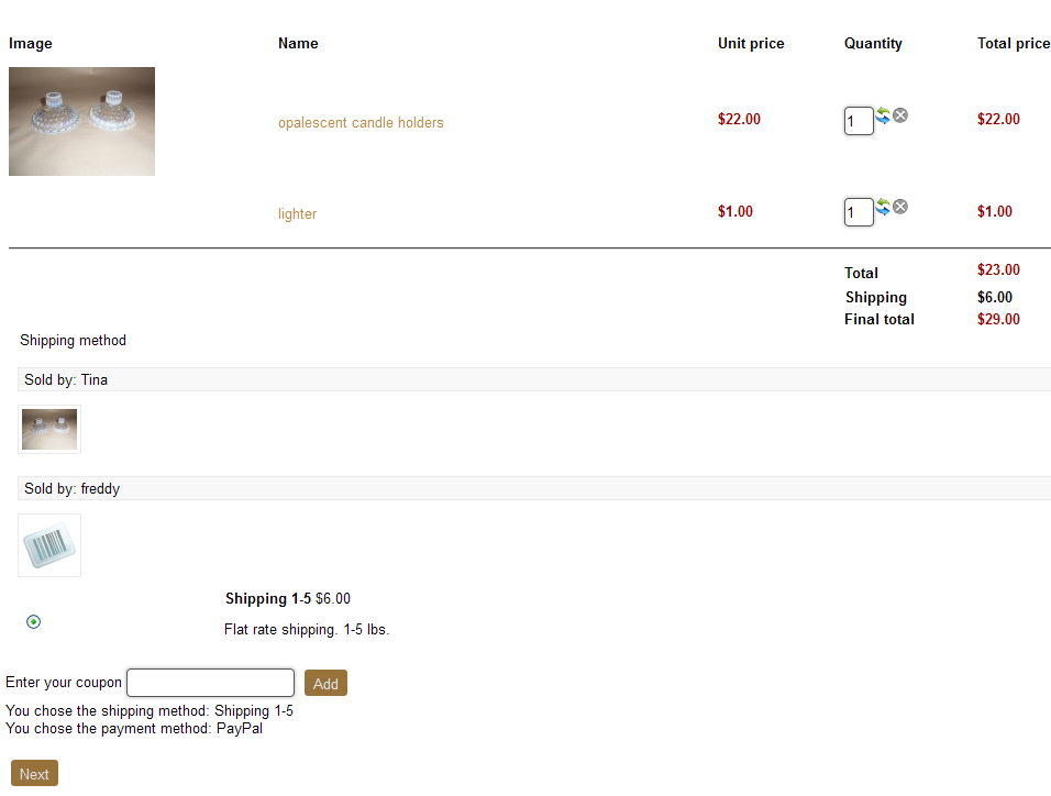

You have restrictions on your shipping method and.
There is no shipping method available for the vendor "Tina".
It means that the product sold by "Tina" does not feet to the requirements of the shipping method.
That's why there is no shipping listed under "Tina" but there is one under "Freedy".

Try adding this item antiquesbazar.com/index.php/categories/product/16-kodak-timer (Tina)
and antiquesbazar.com/index.php/categories/product/10-whatisalias (Freddy)

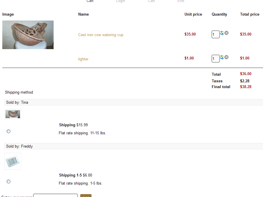

If both items use the same method - restricted by weight - only one vendor has a radio button. you can not select it.
If 2 items and 2 vendors use different methods - restricted by weight - 2 radio buttons are visible. You can not select either one.
Clicking 'Next' displays error pop up 'Please select your shipping information'

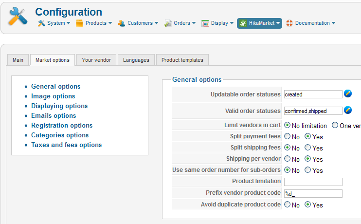

For the moment, you can activate the option to auto-select the shipping method with the submit on selection.
If you have the option "Auto submit shipping and payment methods selection" you must have the auto select option because HikaShop can't accept a partial submission of the shippings.
Otherwise you have to remove the "auto submit" feature. Then you will be able to select the shipping methods (for all vendors) and click on "next" to validate your choice.
But the first solution is better.

I did find in testing that if a shipping method (a) is restricted to a vendor (3) and vendor 2 has an item in the cart alone that the shipping method (a) will be applied to vendor 2, in this case Vendor 2 product does not fit any other shipping method.
Not sure if this is by design. But it also breaks shipping if 2 items from 2 vendors (3 and 2) and (3) matches method (a) and (2) does not match any shipping method.
